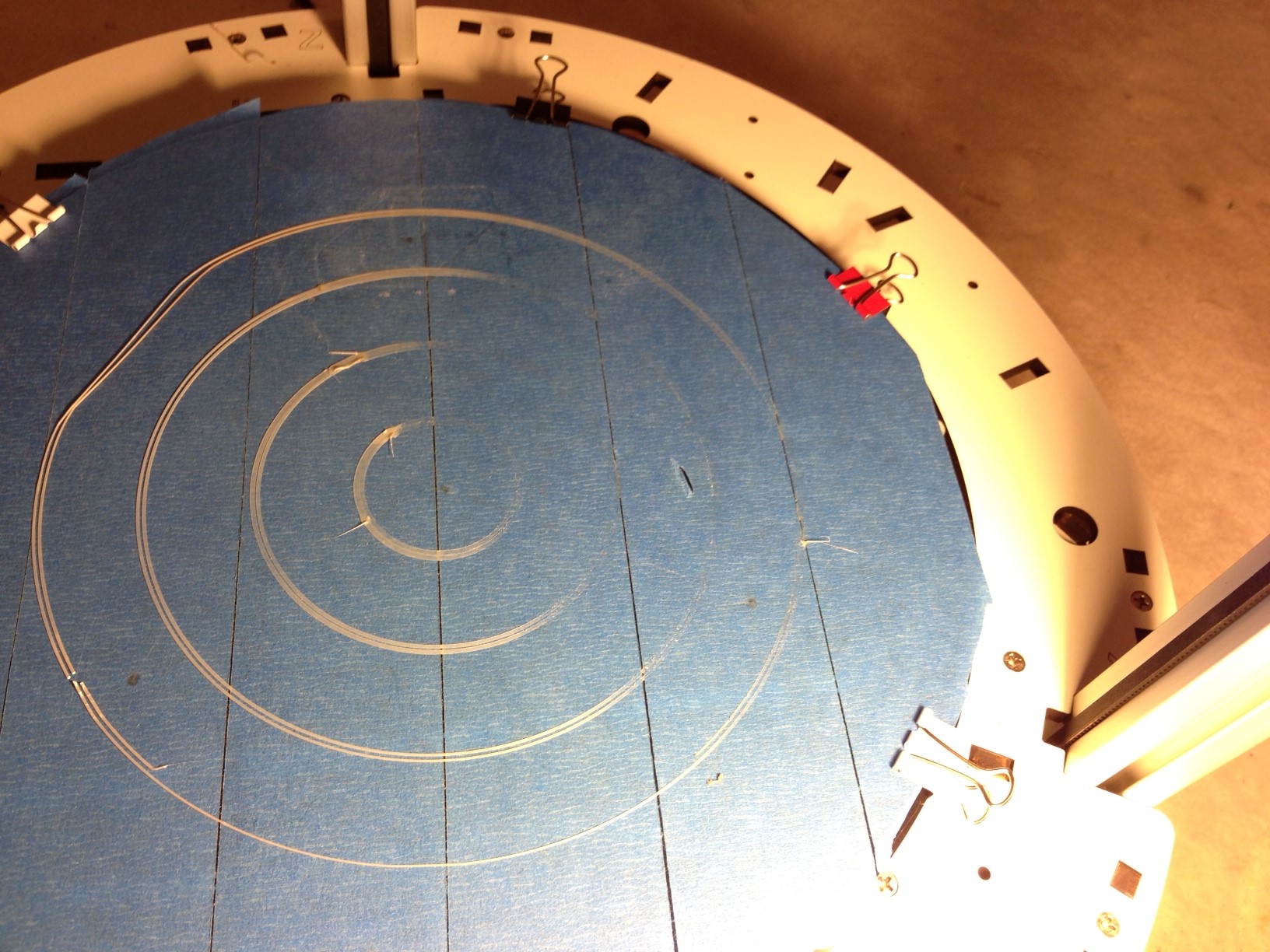

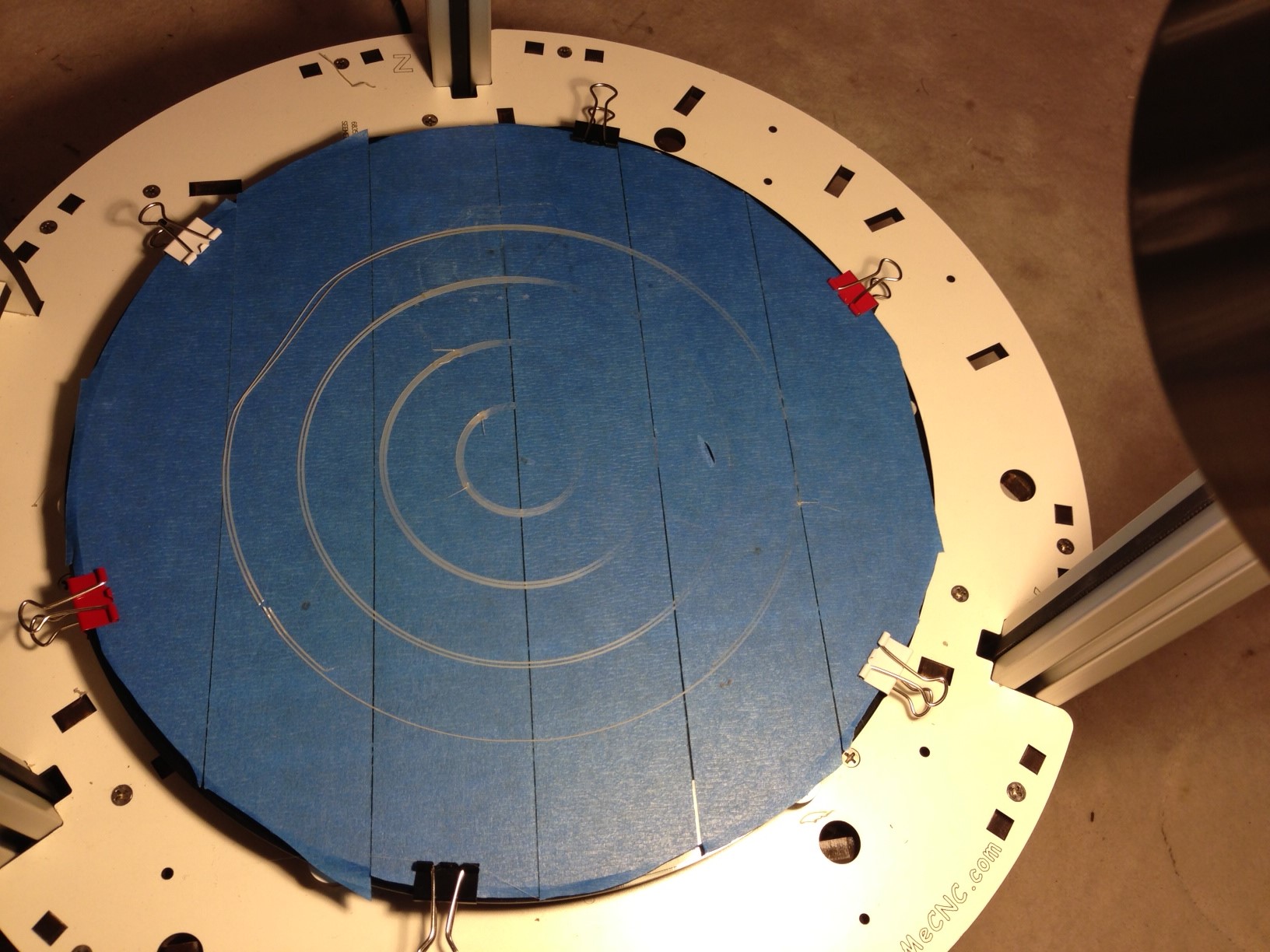

Ok, I have checked the Z height and all the axis several times. Short of measuring the amount of force required to pull the piece of paper not sure what to do. It seems right to me.
I took you suggestion regarding the large circle and this is how it turned out. You can the the z axis for reference. Hopefully this makes sense to somebody.

You need to recalibrate the 3 points on the bed, Note how the extrusion is thinner mostly towards the bottom tight, that tower is lower than the others, infact the top tower is also slightly lower than the bottom left tower.
Try visualizing a disk which is the plane the head is moving in, it's tilted relative to the bed, adjusting the screws corrects that.
You're probably off by 0.3mm at a guess, they need to be within 0.1mm of each other, ideally better than that, the paper needs to "feel" the same under each of the 3 locations I find a feeler gauge a bit easier to deal with.

If you are absolutely certain that the 3 points are in a plane equidistant from the bed, then a missed step, or a belt slipping will cause that plane to offset.
The most common cause for this is the head dragging on the bed, if this is the case I'd expect you to see it happen, it would be the result of the Zoffset being set too high, if this is happening repeatedly it can damage the belts.

Have you tried just adjusting the screws based on the printed ring instead of trying to measure?
There are several factors that make measuring accurately difficult, the most obvious being that the values reported value in repetier host is not accurate, you must use M114 to get the extruder position. And if you hit the bed while measuring even that can be wrong.
What I'm suggesting is on the tower where the ring is thinnest turn the adjustment screw clockwise say 1/4 turn, home and reprint.

OK I'd adjusting the screw is not affecting the error, you likely have a significant mechanical issue somewhere, when you adjust the screws and home you're changing the offset of that tower, if it doesn't change there is something odd going on.

Basically on a Rostock like design motion is not linear, since move requests are linear the firmware corrects for this, but it depends on having an accurate model of the geometry. The only dimensions that actually matter are the length of the arms and planar distance between the pivot points when the platform is in the middle, the later is referred to in the firmware as DELTA_RADIUS, if it's off even by fractions of a millimeter it introduces doming into the motion (either up or down). Given the manufacturing and assembly tolerances, any effective calibration has to modify it.
I would recommend following this setup guide, rather than the one in the manual http://minow.blogspot.com.au/ there is some discussion on the board and a more or less equivalent calibration guide here http://forum.seemecnc.com/viewtopic.php ... DIUS#p5692 .
Initially setting Z at 0,0,0 at irrelevant, since you have to set it a the very end anyway, all it does is get you in the ballpark.
