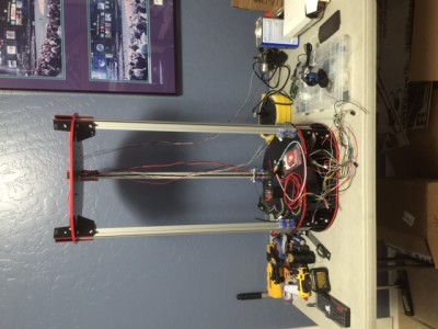

Well - the build is going well and we're all having a blast. I did come up with a few questions.
1 - A few of the capture nuts used to create an end-side structural joint seem to spin in their hole. If I can slip a wrench over it, its not a big deal. However, one is occurring on a vertical support that does not have any reasonable way for me to reach with a wrench. Anyone have a good way to secure the nuts so I can tighten against the resistance of the nylon?
I feel like if I pull the top base plate I'll never get it back on again.
2 - The only mods I have in store for the initial build are the astrosyn dampers on the 3 tower motors, and the Tricklaser LED ring so I can see what its doing. Where is the typical place people get the 12 v for the light ring? Is it appropriate to get it from the PEEK or Layer fan circuits? Do I pull a separate circuit up a tower?
3 - Which towers are the best candidates to have an extra pair of wires included? I've even considered that I may want to add some form of FSR system eventually, and it seems like I could pull some extra wires now and leave them bundled out of the way until that day comes.
Thanks guys.

1) I found that getting a small pair of needle-nose pliers close enough to the edges of the nylon lock-nuts, that I was able to put enough pressure on the nut to keep it from spinning while I tightened down the screw.
2) The astrosyns and a light ring will be a wonderful addition to the printer. As for where to tie in the light ring, I can not necessarily speak for the Tricklaser ring, but with a different set of LEDs that I got from another member of the forums, I tied the LEDs inline with the peek fan along with a voltage regulator and a resistor (my LEDs were designed to run off of something like 5v)
3) In the past, I have managed to run extra wires down the Y axis (Facing the front of the printer, the front right tower). You will almost always want to avoid running them down the X axis, as this is where your endstop wires are run, and any interference across these lines can cause your printer to do wonky things.
Glad you are having fun taking on this project with the kids! If either of them are interested in string instruments, or more specifically cellos, once you get your teeth whet with the 3d printer and feel like taking on a moderately difficult build (yet satisfying when finished), let me know and I will send over my files to print my electric 3D cello that I designed.

Thanks very much. I got a pair of hemostats back into it and got it tight enough. Just sort of jammed them into the side to take up room and stop the spinning.
I got to work on it for a couple of hours today. I did pass an extra pair of conductors up each extrusion for use later. I'll keep in mind that the z-axis ones might be problematic and maybe I'll just leave them for the foreseeable future. It dawned on me that an FSR wouldn't need anything up top. I have extra conductors for lights or other cool stuff.
I'll probably just tie the lights into the PEEK fan. Seems like a good candidate. I can't really imagine a time when I'll want the light off when its running. Its a good reminder for the kids that if the lights are on the hotend is ... well... hot. Especially until I get an enclosure printed/built.
Some of the 26g wires seemed a little short. If I leave the 30" as indicated in the manual, it doesn't reach the RAMBo. I decided I'd splice what I needed near the hotend rather than risk running short of the RAMBo. Worst case was having to splice into both ends.
Anyway, coming along.

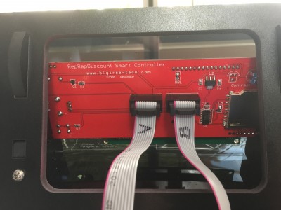

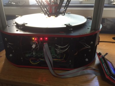

OK - First real bump in the road.
Want to say first that SeeMeCNC has been great about shipping out a part that broke during assembly. They're fantastic.
The problem: My LCD lights up blue, but doesn't show any block. I haven't uploaded the firmware or anything yet. I'm back looking at the RAMBo. Anyone have good troubleshooting tips? Should I go ahead and upload firmware?
Specifically -
Finished mechanical portion of the build.
Smoke Test passed with no smoke.
LCD blue. If I had to guess, the contrast is wrong. (Red PCB on the LCD.)
No blocks.
Thanks for any guidance.
Dionysus480 & Sons
Rostock MAX v2 - "M2D2"
"Do or do not, there is no try." Yoda
Posts: 5359
Re: M2D2 Build
Upload the firmware and THEN worry about the display if it's not showing up. :)
Dionysus480
Posts: 71
Joined: Sun Feb 14, 2016 10:26 pm
Re: M2D2 Build
Post by Dionysus480 »

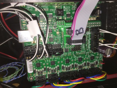

I was just re-checking my wiring and thought I'd upload pics in case anyone catches anything I didn't.
After firmware the LCD is "on" but there are no letters visible. Just a uniform blue.
Hmmm. I also rechecked my configuration.h file and its correct.
Ideas on where to go are slowing down... Guess I'll fiddle.

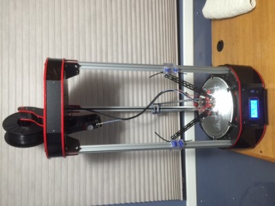

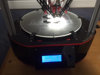

Still looking for a layer fan design that works with the tricklaser LED ring. I haven't printed the stock fan, is it possible to put a standoff under it to use that design?
I'm not pleased with the "eyeball and paper" calibration, although the prints don't look awful. I'm having first layer issues, so I'm printing a dial mount to mess with.
So, I've really messed up my first fablam covering. ABS is sticking so well I can't get it off easily. I placed it directly on the borosilicate glass. SeeMeCNC says to lower the bed heat to 60C. I was printing at the manual suggested 80C, so I can try that. It would also help with bed heating, since it wouldn't have to go so high. My question is whether I should but it on something flexible like plexiglass. It wouldn't conduct heat as well, but I could "pop" stubborn parts off by flexing it. Are there suggestions on the "best" way to use FabLam?
Also, the astrosyn dampers are pretty darn cool. The large cooling fan is loud. Does anyone have a source on a good quiet replacement?
Oh - and I'm planning for a Xenocrates modified Raymond enclosure. I think I can get the sheet goods locally. What is the most cost effective way to handle the joints? I've seen the plastic piano hinges, but would CA or silicone glue work?
Thanks.

OK - Wrap Up for our build.
We built the stock kit, but added astrosyn dampers,the tricklaser lightring, and the stock hotend with a cartridge heater and threaded thermistor. We chose red as the accent color on a black kit. Printing the additional parts out of SeeMeCNC Rocket Red ABS and PLA.
Plan from this point includes belt tensioners (anyone have suggestions), Xenocrates / Ma enclosure, and the Octopanel setup for the Octopi printer server. I'm also considering a ducted effector platform (although it may interfere with the lights, which we use to see whats going on.)
This has been a great deal of fun! A few little calibrations still to go.
Thanks for all the advice and support.
