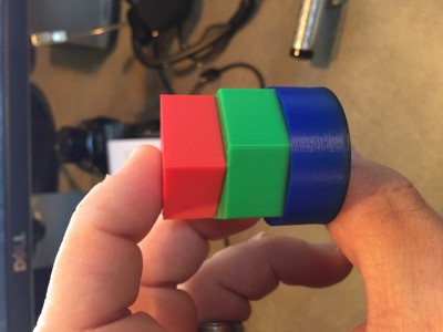

Re: Hello I'm building a custom rostock max v2 and I need a little help.
As well, a thread I have posted to using the Diamond and multicolor printing (http://forum.seemecnc.com/viewtopic.php?f=111&t=10179).
While my attempts are not perfect for mixing of color, it is a start and I am still learning!!!

Thank you all for the advice. It seems the general consensus is KISSlicer. Is it worth going pro,other than supporting the dev? Also would you use the web interface for the Duet or something else? Thanks again and happy printing!!!

I would use the web interface for duet, and multi-color is a good reason to go pro, since you mentioned the diamond as a possibility. Also, I'll be testing a drop in duet mount shortly with space for 2 60MM fans (We had some old AMD stock cooler fans around, and no other small matched fans). So If you'd like, I'll let you know when we get it working (It's just for the Duet, the paneldue mount is in progress)

Thanks Xenocrates. I would definitely like a shout out when you get it done. Let me know when the paneldue mount is done I have one of those to. I was gonna go pro on kisslicer anyway if for nothing else to support the dev but multicolor is definitely a bonus.
