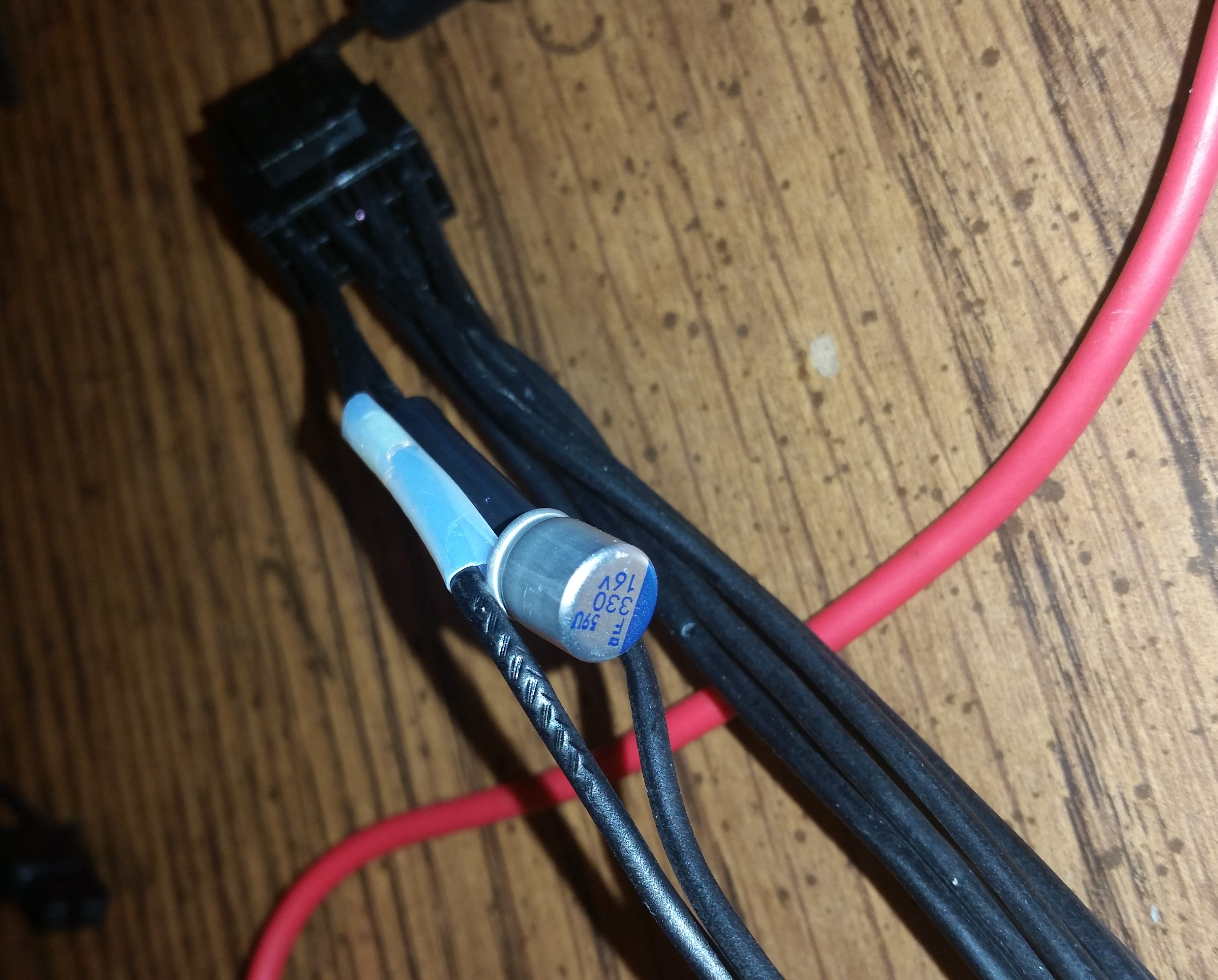

Well, I got the power supply in and began to pull the wires I want to use. My plan is to strip the motherboard connector down leaving only the switch wires remaining then use the four pairs from the CPU cable for the heated bed and two pairs from one PCIE cable for the Rambo and LEDs. When I peeled the bananas I found what looks like some sort of capacitor on each of the cables? (see image) It is connected to one of the 12v wires and one of the common wires. Can someone substantiate this and tell me if they should be removed or (somehow) left in place?
Thanks in advance!
Michael

Those are there for additional ripple suppression, and can be removed, as we don't need our power stable to within 40mV or less. if it's relatively easy to leave them in, I would, as it will keep your power steadier (Only slightly), which will mean slight improvements in handling high temperatures (High load is where ripple suppression usually is needed), and possibly more accurate temperature keeping. However, the system will still function without them.

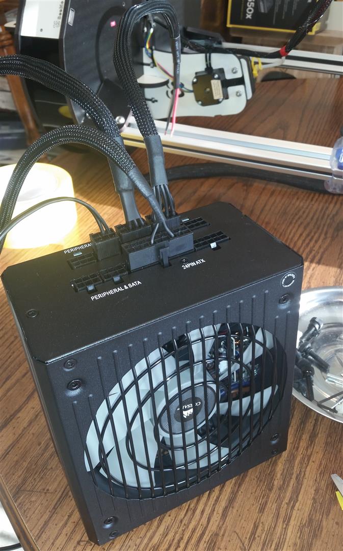

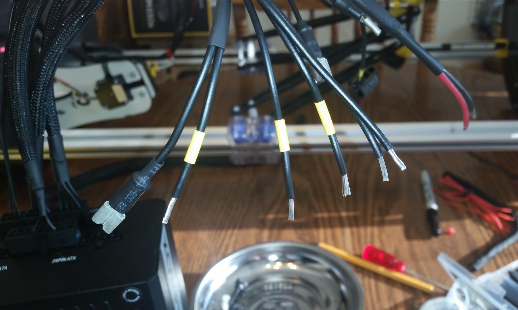

Well, I thought I should post some updated pictures of the RM650x all wired up and ready to install.
Modular connections...
Wiring (L to R) LEDs, Rambo, Hot-End, PSU Power Switch, Heated Bed
New PSU went in VERY EASILY as the ATX footprint of the RM650x exactly matched that of the failing VioTek.
Got it installed and tested over the weekend! Ill post timings and pictures of the finished unit later in the week.
Thanks to everyone for excellent guidance! Im confident that it saved me some time and heartache!
