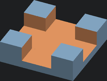

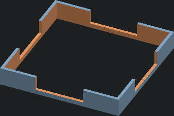

Soo... I'm that guy for the retract settings on PETG. The retract itself is 3mm @ 100.0 mm/s with the return at 30 mm/s. The extruder acceleration is also at 1000. The fast retract got rid of my blobs though.
I threw together these for fast tests of the the retract settings.
boxretractioncal.scad
(332 Bytes) Downloaded 549 times
boxretractioncal-wallonly.scad
(487 Bytes) Downloaded 545 times
