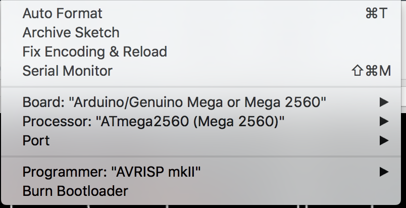

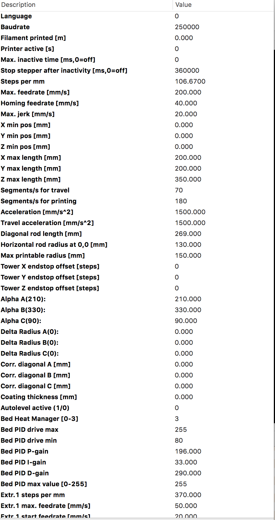

Your symptoms are quite interesting. I'm not sure what is going on. I just uploaded the firmware I built onto a spare RAMPS board I had and plugged in my LCD. The LCD works, I don't have any motor drivers to test if the motors work, but all the EEPROM variables work fine. I noticed I accidentally switched the delta arm length and horizontal radius on the config, so I'm uploading a new version of the firmware. I also changed the EEPROM set to set 2, maybe it might properly write the EEPROM variables this time.
Repetier-Firmware-2016-04-28.zip
(432.9 KiB) Downloaded 285 times
Showing the settings I used to upload to the board, and confirming EEPROM is working.
