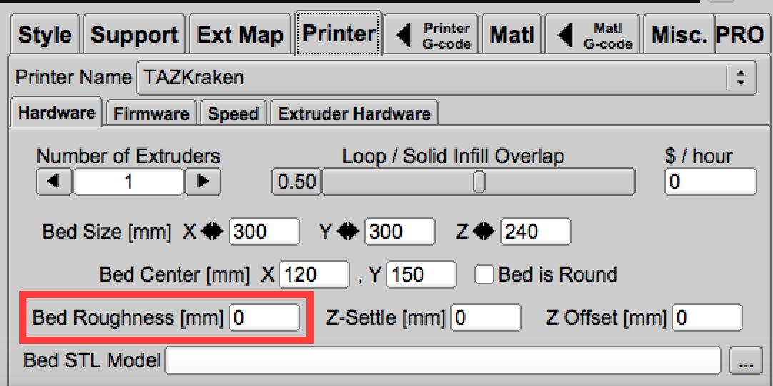

The only issue I have with Kisslicer is that there's no way to set a first layer height and that causes problems when using auto-cal on the Duet. (first layer is too thin and causes the extruder to skip)

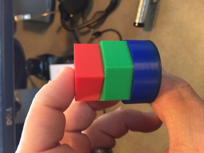

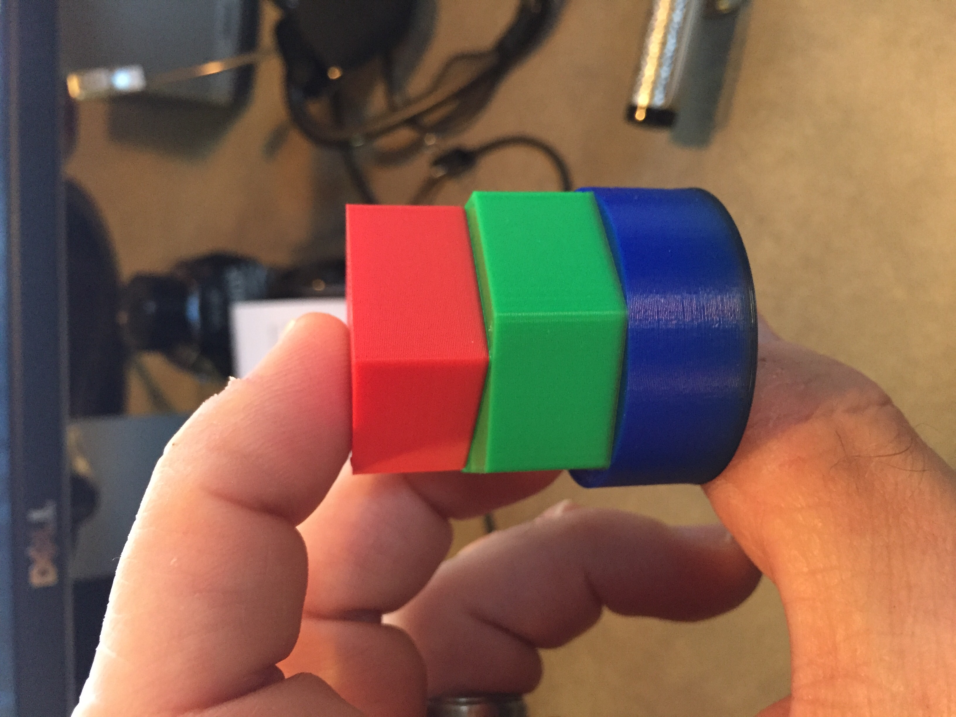

You can thicken the first layer with this. Its layer hight + that value = first layer height
Not really sure what your problem is, sounds like you have the Z probe offset in firmware off a little?
Re: Hello I'm building a custom rostock max v2 and I need a little help.
With the Duet auto-cal, Z0 IS with the nozzle touching the glass. Thanks for the tip with Kisslicer!
