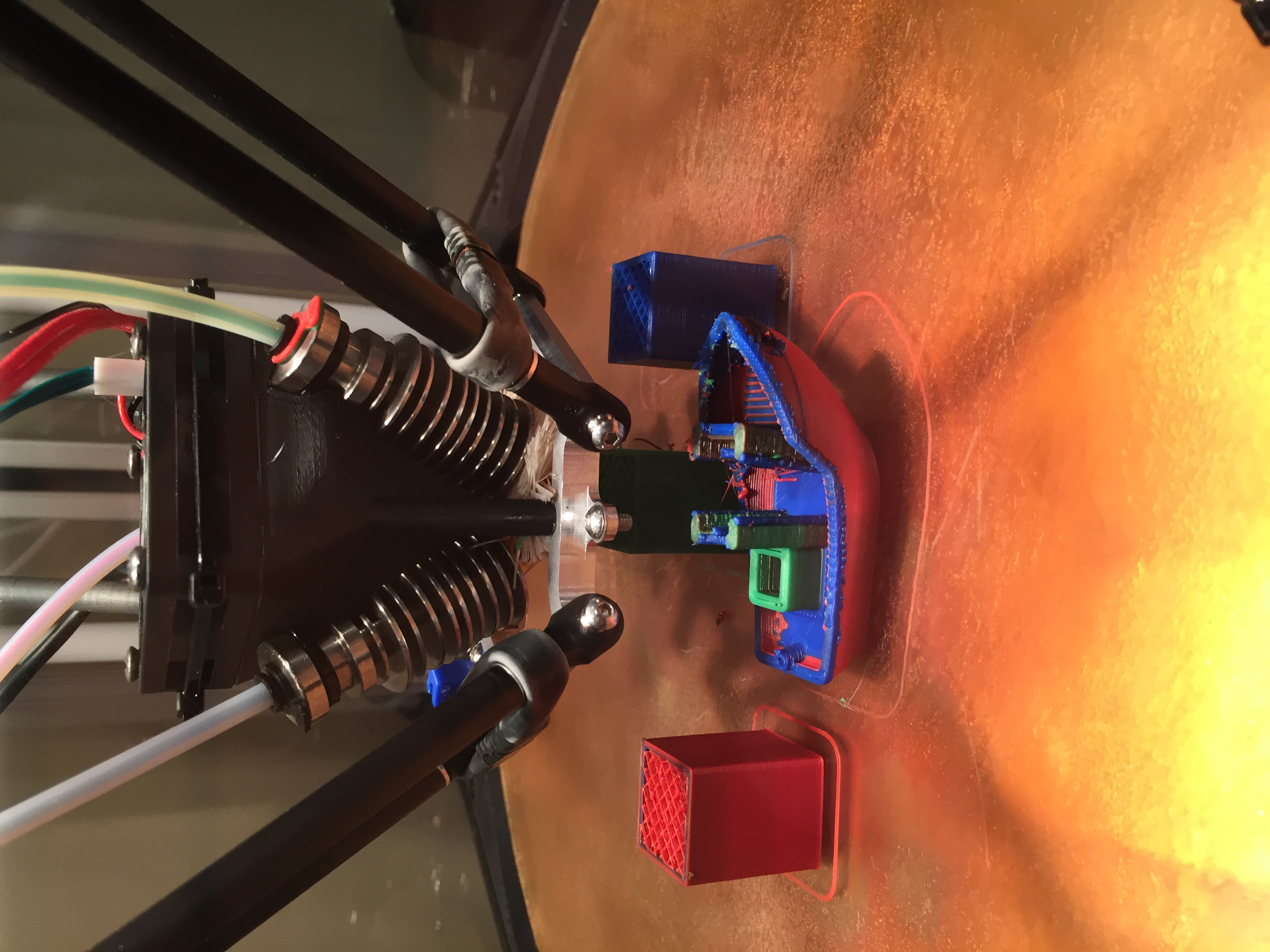

						Re: Duet and Multi-Color/Multi-Filament Extrusion
This time I added to "wipe towers" to clear the Diamond of filament before printing the dragon or heart.
Here is the first image and it looks good thus far!!!
Here it is as it sits on the print bed.  Still a bit of stringing despite retractions set at 8mm.

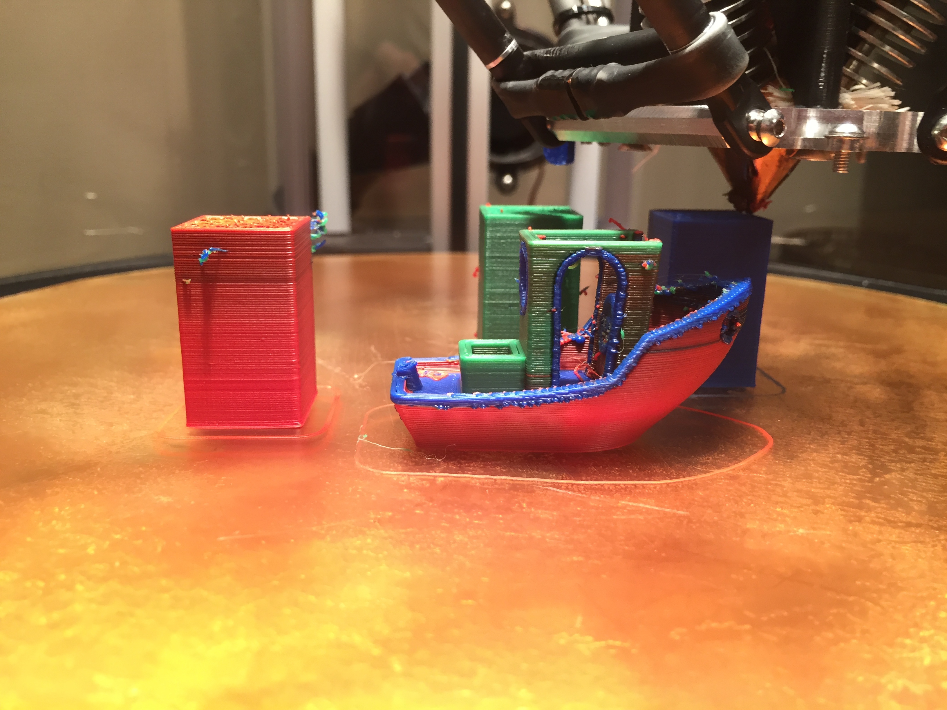

I found out (I think!!) how to make sure that wipe towers are the first items to print when changing to a new color.  Thus, clearing the Diamond head of the prior color.
In KISS Slicer, place/open your wipe towers first (which placed them first in the list (see image). Then place/open the print STL of interest after the wipe towers. Here is a picture of the print that is currently finishing where the Benchy Boat was first of the list of items printing. You can see the color change occurs with the Benchy Boat, not on the towers.
And I'm still over extruding a bit.
Next I will print with the wipe towers first in the list, and the Benchy Boat boat last in the list (see KISS Slicer screen shot picture). Hopefully, this will prevent mixing of the blue, green and red of the boat with color changes occurring first at the wipe tower/color change tower.
Addendum: added the pictures.
Although placing the boat last in the list did help to minimize the color mixing, it is still present.  I need to find if there is a way to pick an object and force the slicer to change to a specific color on that object.  Thus, force the slicer to switch tools such that changing to T1 (green with this print) always occurs at the green wipe/color change tower to clear the prior color from the head.
Not sure if this exists. Has anyone run into this functionality........ Have I missed it somewhere.
Wonder if this can be done in the firmware?
