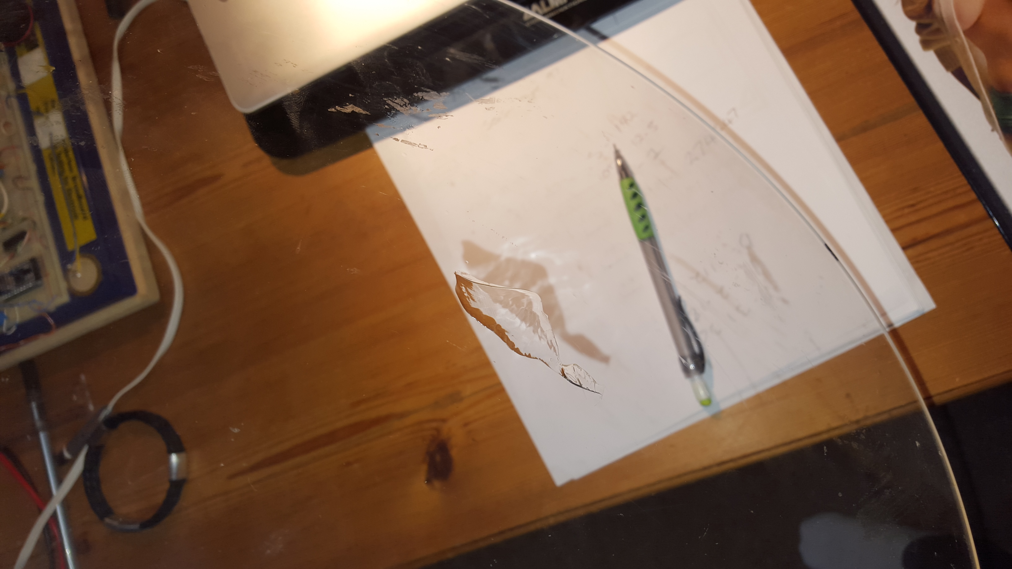

Well after an evening of messing around with PID values, I finally got a print out of the stock hotend.
Then when I removed the print, it took a huge lump of the glass plate with it
This hobby sucks the big one

Well I turned the damaged glass over, but after one print .... its totally gone
So, I either order another bit of glass and keep going, or simply sell it cheap without the glass and let someone else take over the never ending hassle.
Not even sure why the heck the glass failed
Any ideas where to get a replacement in the UK?

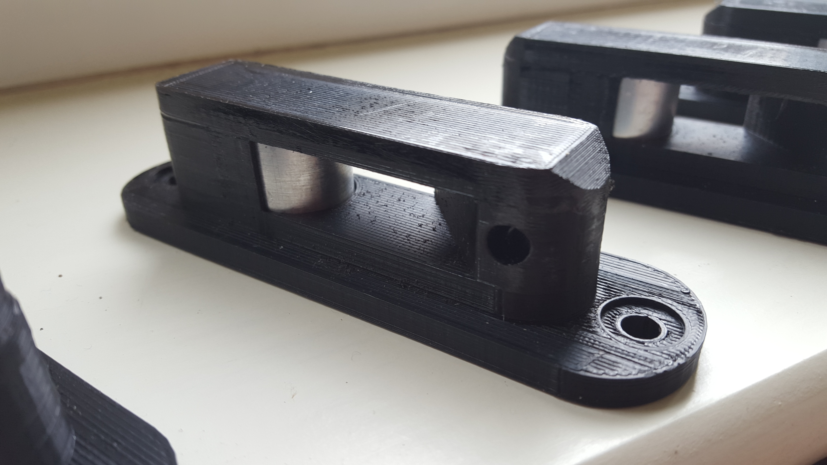

Well just as an update...
Gave up trying to find a proper round Borosilicate disc and used an old bit of square 4mm glass I found in the shed. Works fine
Actually now managed to print 8x identical mounting brackets for my pickup truck using the standard RoStock Hot-end. That E3D-V6 hot-end sent me on a route to pain and frustration.
Still suffering curling and warping if the print is over a few inches in diameter however.
Tried printing on blue painters tape and the tape just came unstuck after a while.
Best results so far are ABS juice, but its far from perfect.
