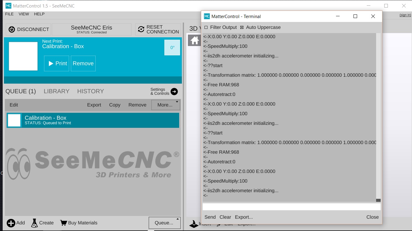

Interestingly, it connects to matter control but won't do anything else.

Is the printer recognized by matter control properly? Could you screenshot mattercontrol, and the G code terminal (under view, terminal)? I would think that if Mattercontrol can connect, then windows is properly recognizing the rambo as a device using serial over USB, meaning you don't need a different driver (Of course, I assume windows. You may be using linux or OS X, which don't ever need drivers)

Here it is. Just keeps cycling through the same lines.
Windows 10 OS
I did update the driver. No luck there. I'm trying a reboot.

Very odd. Take a look at the connection to the hotend, and the circuitry there. It May be the the accelerometer isn't connecting properly due to a loose connection. Beyond that, I would call seeme support. Unfortunately, no one knows a whole lot about the accelerometer yet, and that appears to be the root of the issue.

Post by Milamber »
Xenocrates wrote:Very odd. Take a look at the connection to the hotend, and the circuitry there. It May be the the accelerometer isn't connecting properly due to a loose connection. Beyond that, I would call seeme support. Unfortunately, no one knows a whole lot about the accelerometer yet, and that appears to be the root of the issue.
Funny you should say that... It wasn't readily visible but a plug on the hot end wasn't in all the way. It just came to life.
Then I come back here and that's exactly your advice.
