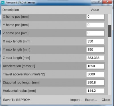

One other thing I noticed. I was looking through my EEPROM settings, and I saw that my X max length [mm] and Y max length [mm] values are at 350. Should they be the same as the Z max length [mm] value? I wish I knew more about what each EEPROM setting corresponded to.
I recently downloaded the newer version of MatterControl instead of the stock version from the SeeMeCNC website, and now I'm wondering if maybe the EEPROM settings got changed somehow. I remember having some issues with the Z max length being set way high which was sending my nozzle crashing into the bed.

Okay, so I figured out that the x y max length values don't apply to delta style printers, and by changing tower rotation I've managed to get it to a point where it does not appear to be making a convex or concave motion towards the y and z tower respectively anymore.
