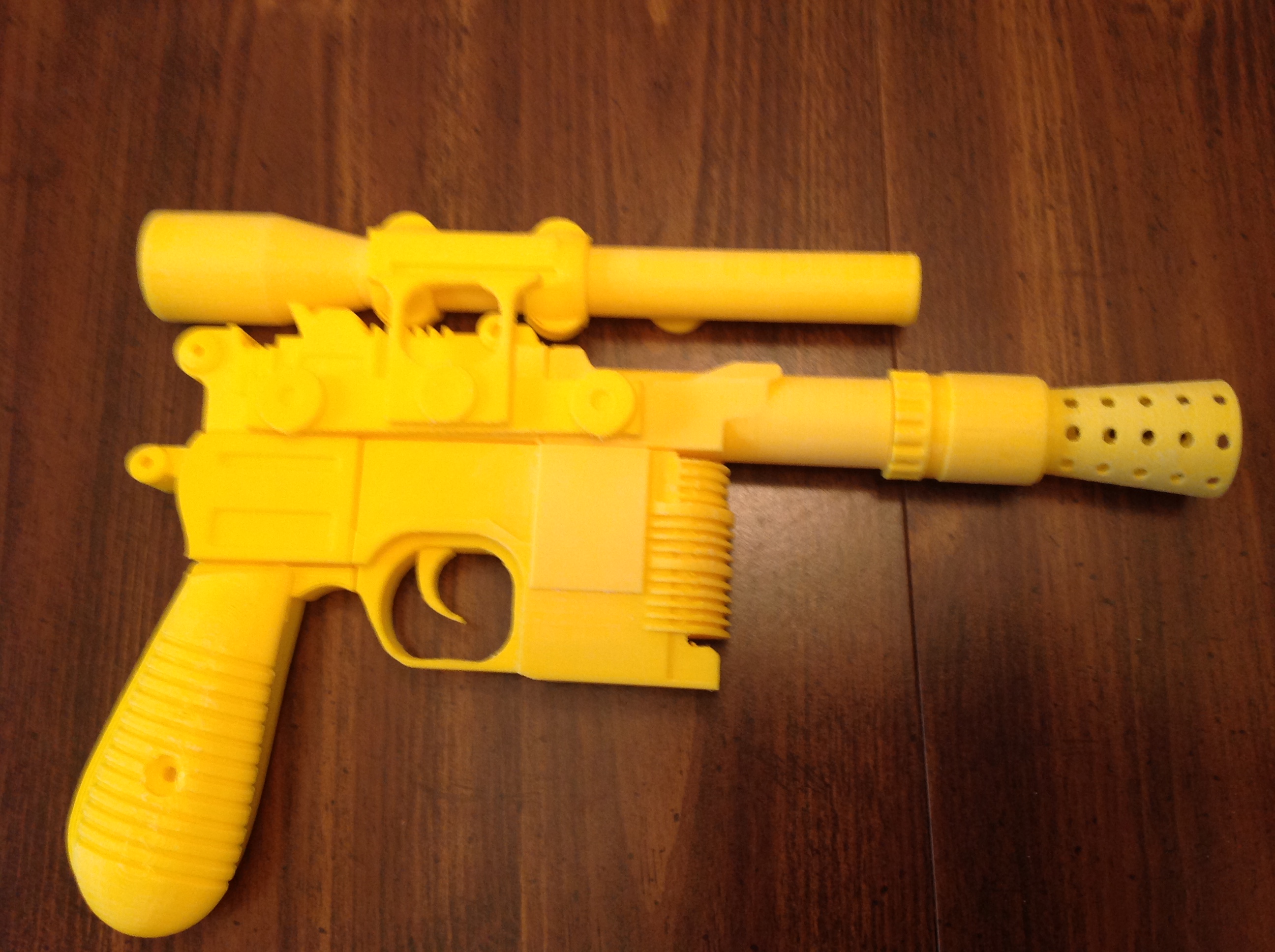

Print quality is pretty good, less stringing with whatever the latest config file I downloaded as of 5/17. First layer is a little squished or over-extruded for my liking. I haven't increased the current to the extruder yet (John mentioned on facebook) I will wait for the github update.

I think I've got the temp and speed where I want it. Still dealing with some strings but they're improving. Detail on the prints is outstanding.

cool modified Mauser 1896 broomhandle pistol model , as you say great detail I hope you will paint it to look like the Star wars prop as well.. Winston Churchill's favorite side arm in the Boer war... though without the lewis gun flash hider... Mind you mine is a WW2 bringback of my dads in 7.63×25mm Mauser and with Russian surplus (7.62×25mm Tokarev).30 ammo the only stuff you can find to feed it these days... the muzzle flash is enough too blind you at night!

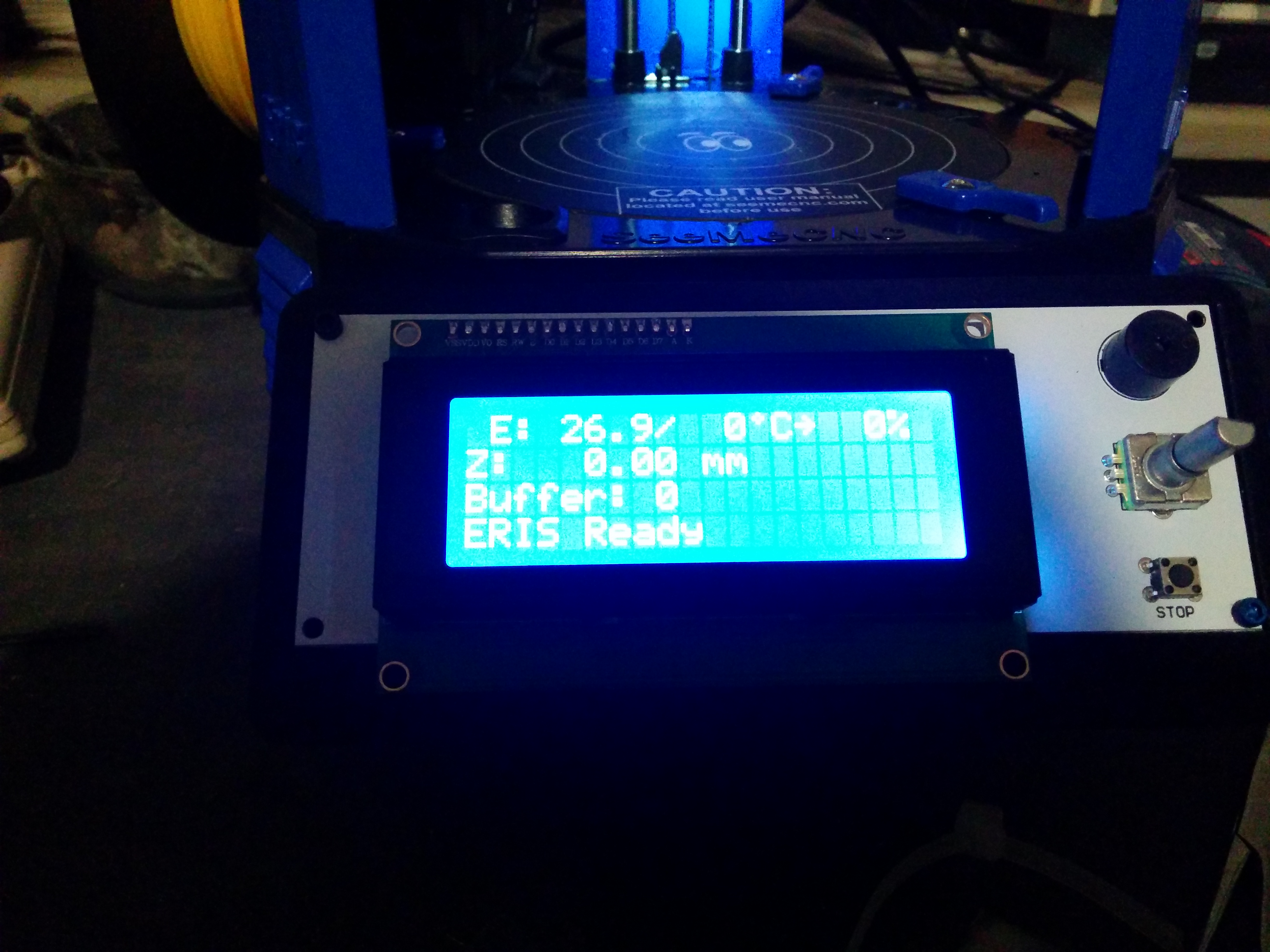

- Posts: 1407
Installed the smart controller tonight. I have to make some minor adjustments to the stl files, but other than a little tight Interference with one of the connectors, it appears to be a painless Install, just Plug n Play.
