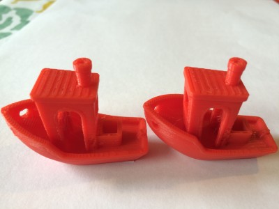

gkrangan wrote:Folks,
I seem to have resolved the stringing problem that I had :D .
After messing with various settings, I believe I have narrowed it down to the Z-Lift.
I also lowered my temp down to 200 deg C, from the default of 210 deg C. I also restored the retraction-length back to 4.5mm, which was the default.
By default the Z-Lift was set to 1mm.
I slowly lowered the Z-Lift value to 0.5mm, then 0.3mm, and then finally 0.2mm. I was getting better and better results when I lowered it in steps.
I stopped at 0.2mm, since the stringing negligible or non-existent now.
Please check out the latest pictures and compare them to the ones from yesterday. The difference is night and day. They were taken immediately after removing them from the build-plate, as -is.
If anyone else is having stringing issues, see if lowering the Z-lift value helps.
Changing the Z-lift to .2 significantly reduced stringing. Almost eliminated. I'll see if tweaking the temp down gets rid of it. I'm running about 213C. I've been tweaking that down trying to find where my prints stop sticking to the bed. I tried 200 but I couldn't get a successful print at that temp.

So, here's something interesting....
Earlier this morning, I had printed a 3DBenchy. Except, I had scaled the size down to 75%, so it would print in 2 hours.
Once the print finished, I noticed some layering issues on the right-side pillar of the Engine-Room of the boat. At that time, I passed it off as a glitch.
Since then, I have updated the firmware to the latest on github.
I then re-calibrated, and printed a a 5mm calibration-cube print to make sure that all is well post firmware update. The print came out perfect, with no issues.
I then re-tried the 3DBenchy again (and I also regenerated the G-code), and printed it again (post-firmware update).
The new print has the signature of the same layering issue, at the exact same spot.
It's just shows up for a few layers, and only on this one portion of the part. No issues seen at the same layer level on the rest of the part.
Please see the attached picture. The print on the left is the new one from this after noon. The one on the right is from earlier in the morning.
If this is a potential bowden-tube not being seated properly issue, what are the odds that it will happen at the exact same spot on two different instances of the print, with a firmware update and another print in between.
Is it possible that NetFabb messed up something in this spot when I scaled it down? Or might it be the MC slicer, that is messing up the tool-paths for that spot, on the print.
Any ideas?
Thank you.
AlanZ
Posts: 271
Post by AlanZ »
I have had similar issues with the benchy, without attempting to scale it.
One thing to note... I have never been able to configure MatterControl with CuraEngine and have to create layers for this model (it only creates 2 layers).. Only the MatterSlicer seems to work for this model in MatterControl.
Does this match the experience of others in this group? The Benchy slices fine in full version Cura.
