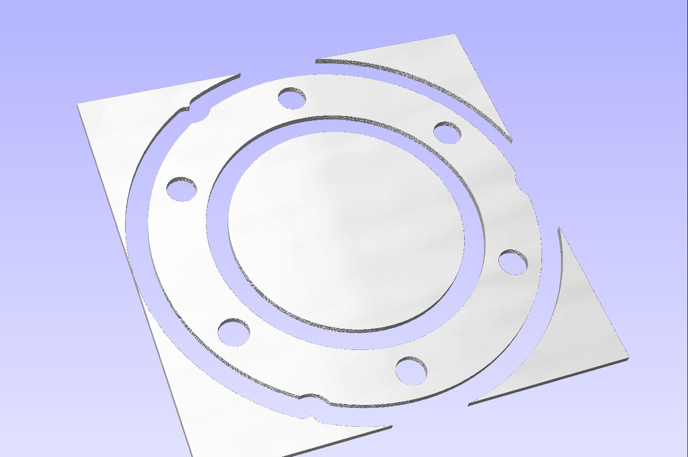

teaser ... another add on i'm working on..
Haven't decided if I will use all 6 or just 3, these are some pretty blinding leds at 1 watt a piece!! I'll be adding a variable pot for adjustable light intensity. I'm using aluminum because it doubles as a mounting plate and heat sink. Mount uses stock mounting hole locations. plug-n-play design
milled aluminum led mounting plate and leds

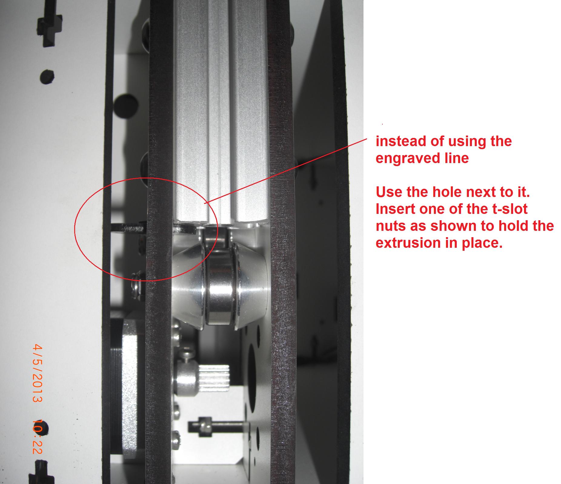

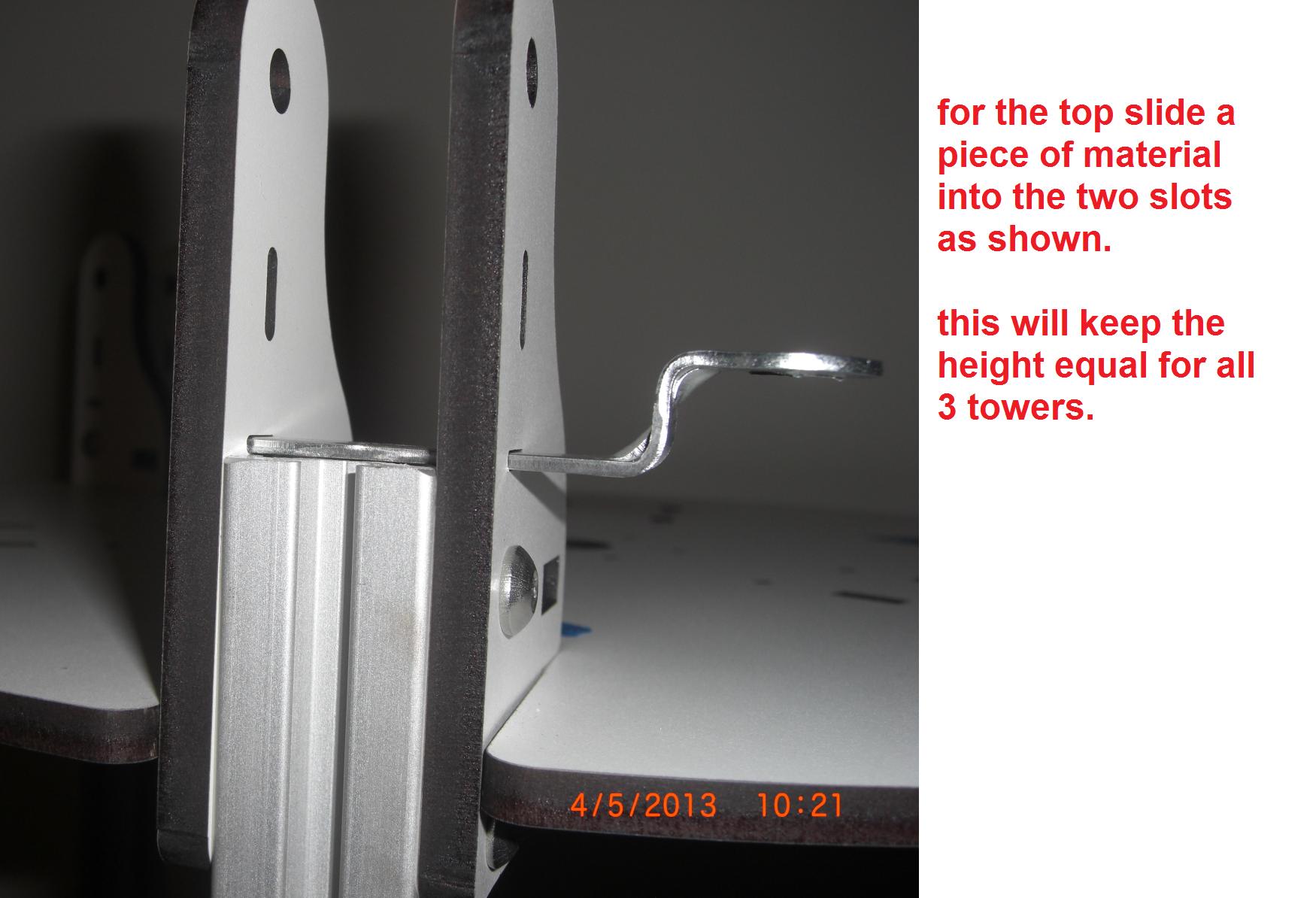

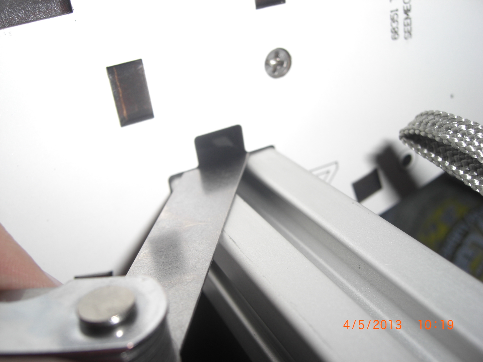

Better way to get your extrusions aligned properly
Post by cambo3d »
I thought I'd share this with everyone since there has been some confusion on how much gap to have between the extrusion and the frame. I am in the process of reassembly and I might as well show you how i did it. Following procedures assume you have checked your laser cut parts and all are aligned properly.
for this to work part numbers 68351 (base table top), 68368 (top support plate), and 68369 (TOP IDLER MOUNTS, check hole alignment) need to be perfectly the same. Sand if you need to square them up. photo shown below of the two circular plates stacked on top of each other. yes i know my spelling is wrong.
Once your ready to install the aluminum extrusions here's how to get them perfectly the same height. installation bolts are installed snug but not tightened yet at this point. If you dont have an extra t-slot nut, use whatever that fits in that hole.
WHATEVER, you used here make sure that the material is snug against the extrusion. (note: this assumes that all your extrusions are the same length also, check before you proceed)
install the screw that holds the top support plate to the extrusion, its one single screw held in by an anchor nut on the other side. (you can do this step before hand also, i just chose to put it here in the write up)
Once the above has been done. Grab the feeler gauges, flat automotive type, you get these from any autoparts store, I got mine from advance auto parts.
use the feeler gauge as space gauge. Press the extrusion against it and tighten up the bolts for the bottom. (select a feeler gauge that will give you the same space for the bottom and the top, mine came out to be .024in or .610mm)
next go to the top, and do the same thing. once you have the space correct tighten down the bolts.
Now repeat this procedure for the other two towers.
Once done all three towers will be at the same height and perpendicular to each other. Oh yeah, DONT FORGET TO REMOVE YOUR ALIGNMENT TOOLS (IE. T-SLOT NUT THAT YOU USED TO ALIGN THE BOTTOM AND THE MATERIAL YOU USED TO ALIGN THE TOP

Re: Another rostock max build
Post by aehM_Key »
I recommend to measure the height.
cambo3d
Posts: 1057
Location: Florida
Post by cambo3d »
it is measured, they all measured the same. And you can do this once your done aligning all the towers just to double check.
Everything should measure the same if all your laser cut parts are aligned like I stated earlier.

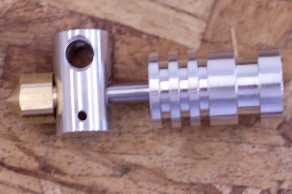

New all metal hotend retrofit
Post by cambo3d »
new hotend that will get retrofitted into my max. I've been following the development of metal hotends and this one is now available for purchase. One downside depending on how you look at it, is that it uses 3mm filament at the moment. 1.75mm will be available at a later date.
hot end can print Nylon, Polycarbonate, PLA, ABS, LayWood, PVA, HDPE and just about any type of filament there is currently available on the market. no PTFE or plastic is used in the hot end and it is safe up to 400C. currently available at http://trinitylabs.com/products/trinity ... emp-hotend
Great job on the pictures and the explanation! This certainly has to be the best way to install the extrusions, the idea of using the t-nut on its side at the bottom was brilliant!
Thanks for writing this up, I am just at the point of installing the uprights and this is a godsend.
Could you say where those hotends are available?

foshon
Posts: 600
Post by foshon »
Do you have a method of attaching the hot-end in mind?
Purple = sarcasm
cambo3d
Posts: 1057
Location: Florida
Post by cambo3d »
making a jhead adapter to fit our rostock platform.
cambo3d wrote:making a jhead adapter to fit our rostock platform.
Be sure to let us know how that Hot-End works, they should all be made like that...without the Peek or other
parts that can melt. That was a good find, the only other ones I've seen made like that come from England.
Carl
cambo3d wrote:sorry, updated link in my post
glad someone found this idea helpful. =)
I just installed my uprights using your tips and everything came out perfect without trying to eyeball the lines and screwing around.
I highly recommend your method for anyone building the Rostock Max. Thank you for sharing these ideas with us. I'm not going to
mention a change to the "manual" but if anyone from SeemeCNC reads this thread they should consider this method of installing the
extrusions as the official method and document it as such.
Carl

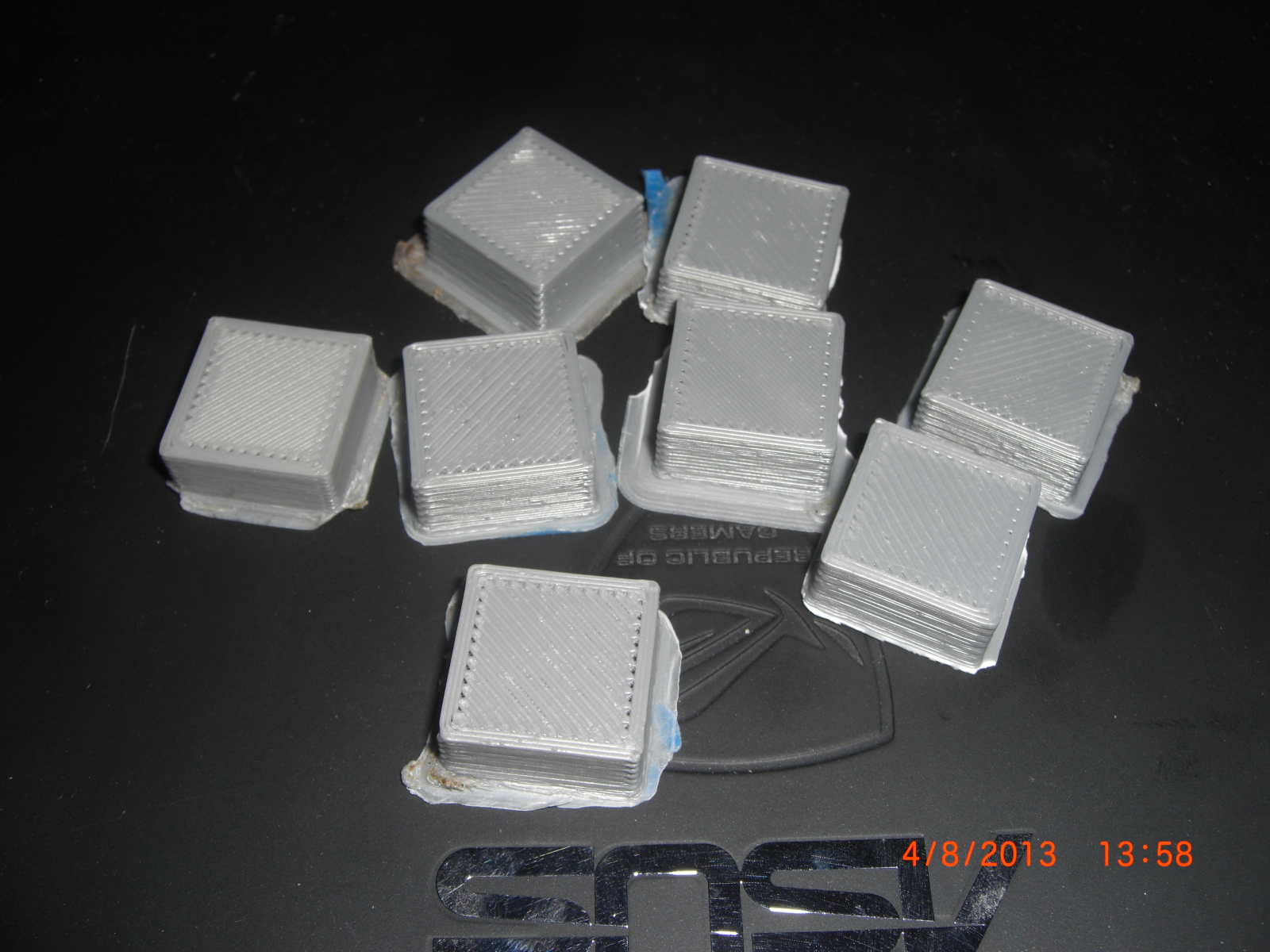

cambo3d
Posts: 1057
Location: Florida
Post by cambo3d »
I spent a good part of the day working on printer calibration using slicer but I could not get rid of the gaps near the perimeters. I printed about 6 or more calibration cubes after making changes to slicer settings with no improvement. Then finally, I switched over to Kisslicer and man did it make a difference. Using settings posted my mhackney I was finally able to print a nicely infilled calibration cube.
earlier in the day I keep thinking maybe my arms were still binding somewhere so spent another 3 hours sanding and test fitting till i felt it was perfect. Tried more prints with slicer and still was getting gaps near the perimeter. Even with the new version of slicer my infills weren't going to the edge. I probably messed with almost every setting in that program.
So for me changing slicing software made a big difference.
failed prints with slic3er, infills not reaching the edges
With just one print using mhackneys kisslicer settings (by the way thanks for posting these settings)
This calibration part of the printer is kickin my butt, but then again the whole build has been a pain in the butt.
On another note: Since i've switched to the just the boroglass and my build surface stays pretty flat at temp. I previously had problems with the aluminum warping.
