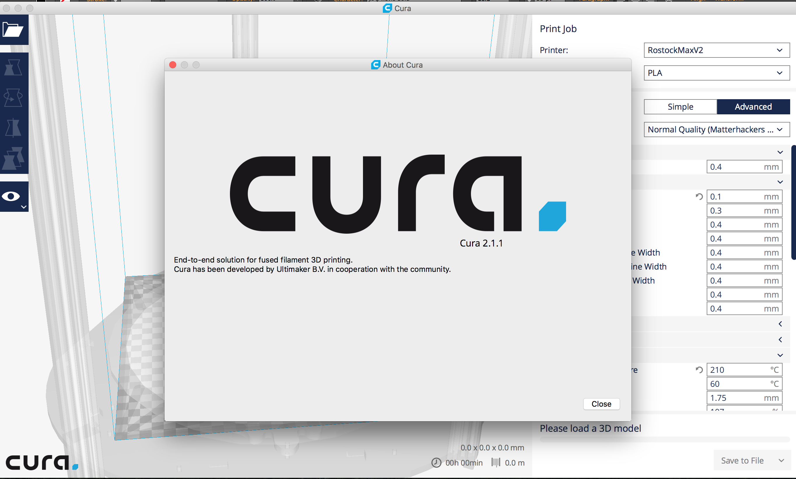

I'm running 2.1.1, and you are right I forgot to add the extra resources folder in the path. I just updated to 2.1.2 and if you use the json file and stl I provided you should still be able to add the printer. Where and how do you set the center to 0,0?Nylocke wrote:I'm also on OS X so I'll try messing around with it. I'm pretty sure I know whats wrong and I can check it out soon.
