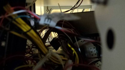

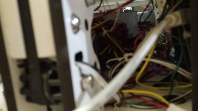

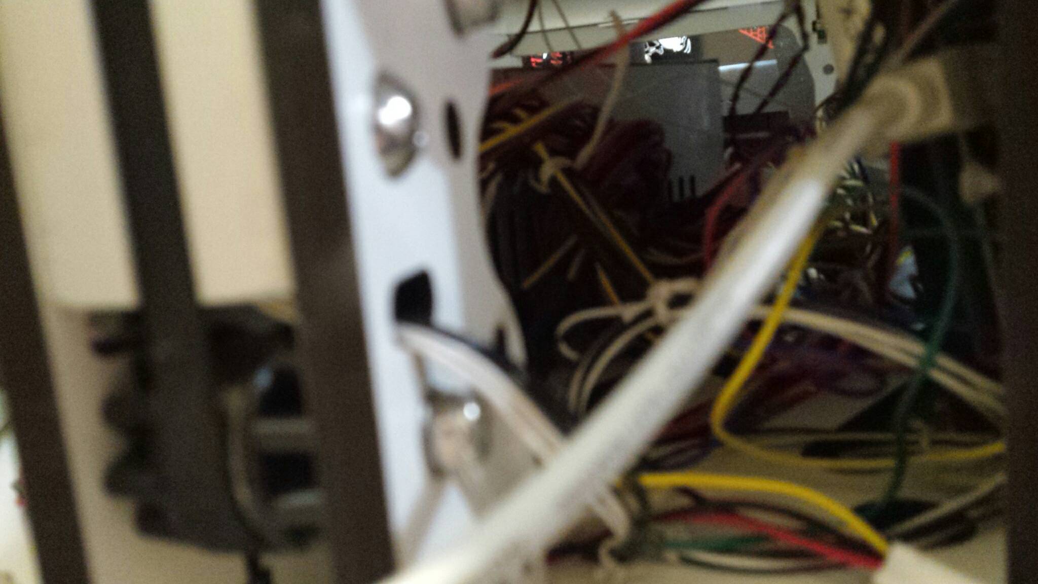

Well here's a couple shots. I tried to get the inside from the sides, but maybe when I get the top plate off I'll get better shots. It's a mess.Xenocrates wrote: If you don't mind, a picture of the cabling before, during, and after the cleanup may also help.

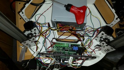

PCB bed/snowflake/plate lifted. There's the mess.

I had a similar problem when I completed my V2. I traced the problem down to an intermittent connection where the end stop sensor wires connect to the microswitch. I crushed the spade lug connector a little with pliers. Problem hasn't returned... 1 year. A little vibration from the end stop screw hitting the microswitch and a slightly intermittent connection could produce an unreliable home on one or more towers. Hope this helps.captainpotatofudge wrote:DeltaCon wrote:So it goes like this: I hit Home All in MatterControl, all carriages move upward at a normal pace nice and smooth, they hit the end stops and immediately let's say the X carriage drops super fast 1/4 of range, the Z drops 1/3 and then ZIPS right back to the top super fast and repeats, while the X slowly moves back up at the same time. Super weird stuff and since it's been totally random so far I haven't been able to capture it on camera. I REALLY wish I could have. And it seems each time it happens if I close MatterControl, the behavior stops immediately.

I've also pondered making the stepper wires MUCH shorter. Right now they just seem ridiculously longer than necessary which increases the odds of interference. Anyone have thoughts on this? I'm just trying to reduce as many possible factors as I can since I don't know where my problem stemmed from.

That's a good one! not sure that I can think of a way to check for this as they sit, but I'll make sure they're good solid contacts/crushed as I do the rebuild. Thanks for the experience input.kscott wrote:I had a similar problem when I completed my V2. I traced the problem down to an intermittent connection where the end stop sensor wires connect to the microswitch. I crushed the spade lug connector a little with pliers. Problem hasn't returned... 1 year. A little vibration from the end stop screw hitting the microswitch and a slightly intermittent connection could produce an unreliable home on one or more towers. Hope this helps.

I know that sort of thing. Going through that a bit right now myself. May I suggest that you pick up some shielded wire for the endstops, as well as the temperature sensor while you're working on it. You'll want to ground the shielding, but it will keep crosstalk from being as much of an issue. Or pair them and twist them before feeding it up the tube. Perhaps some telephony cabling? I would think they make 3 pair cabling that you could feed up the tower as a complete bundle, and have color coded top and bottom for convenience, with a consistent twist for noise rejection.
Hasn't killed me yet. I cut mine down to about the required length. The left stepper in particular had a ton of wire I cut away. big thing would be make sure to either buy new crimp shells (you'll want Molex LP 4 position ones), or save the ones from the cable ends by using an eyeglass screwdriver to release the retention clips on the shells.captainpotatofudge wrote: I've also pondered making the stepper wires MUCH shorter. Right now they just seem ridiculously longer than necessary which increases the odds of interference. Anyone have thoughts on this? I'm just trying to reduce as many possible factors as I can since I don't know where my problem stemmed from.

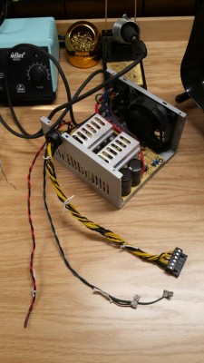

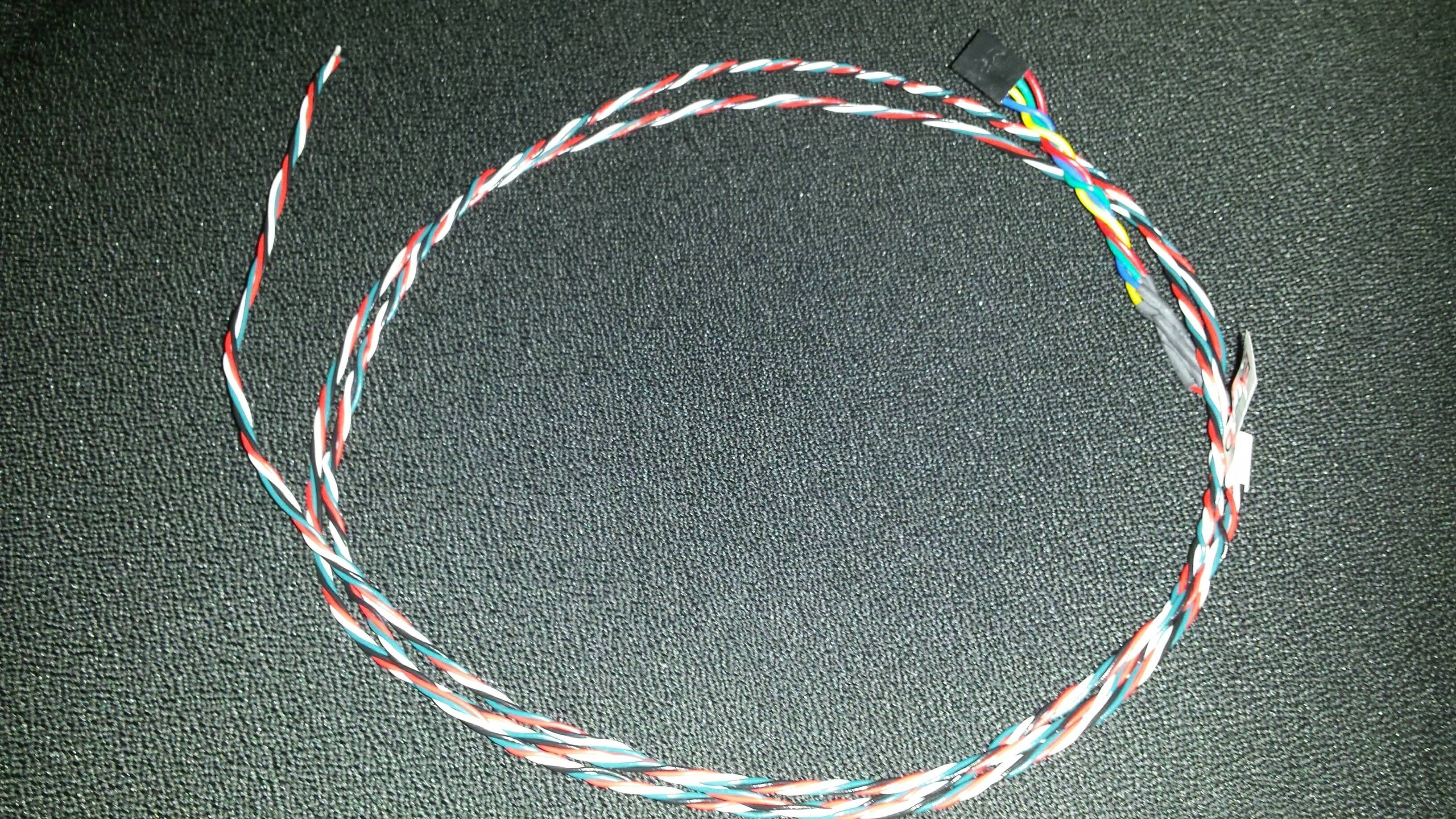

Well I tied into the PSU. Gutted all unnecessary wiring. I left one pigtail lead for 5v in case I should ever need it..no clue right now why I would, but hey...forward thinking, right? The 4 black ground wires going to the first pin were twisted together, then the 4 yellow for the second pin. Then the two bundles were twisted together and connected to the plug. Then a pair of yellow/black twisted together for the 3rd and 4th pins then twisted around the existing large bundle. Then the same for the final pair. Then I Ohm checked each ground termination on the plug to the ground lug on the receptacle and to the PSU case and all read ~0.7-0.8 Ohm.
And I fished the extruder cable out, twisted it and reran through the tower. Then the same for the wires for the PEEK and cooling fans.

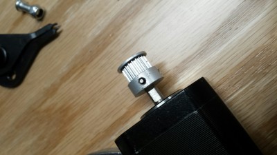

I also had an incident with one of the stepper motors where I tried to break torque/threadlock(unsure of how much or what type was used) on a set screw and instead broke a hex bit off at just the right level so as to not be able to get a hold of it with ANYTHING. That took a few days to sort out.

As to getting shielded wire...idk yet. CAT6/7 S/STP or STP isn't terribly expensive I guess, but..idk maybe. I haven't checked, but I'd be surprised if the jacketed shielded CAT cable would it up a tower! So you'd end up just running the shielded twisted pairs separate anyhow.
