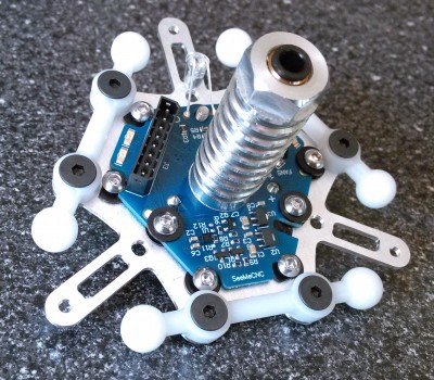

Finally got my hands on the new hot end and probe board to test out on the MAX v2 :D

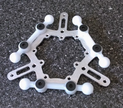

Made aluminum effector platform to mount it with ball cup arms.
Just downloaded newest Repetier fw and getting ready to flash it to machine.
Still figuring out the wiring...

Is this the new one from the Eris?

Forget the wiring.... I want to know when you're going to sell that effector platform and those sexy ball cup carbon fiber end tips!!!

davec3275 wrote:Is this the new one from the Eris?
yes, it is from the Eris.
I hear it will be standard on the RMAX v3 kits to be available in a few months.
And the hot end + probe board as a retrofit kit for older machines.

U.S. Water Rockets wrote:Forget the wiring.... I want to know when you're going to sell that effector platform and those sexy ball cup carbon fiber end tips!!!
I have a few of the aluminum platforms available now that I milled on my CNC. I expect to have a batch of (50) from my local water-jet guy in a few weeks.
http://www.tricklaser.com/Aluminum-plat ... ALU-BJ.htm
Beta testing of the rod ends is complete, they work great! I am very close to pulling the trigger on the injection mold for those ends, just need to check over the design details before committing to the hard tooling investment. They will be injection molded Delrin.
I designed our new ball-cup rod end to be a drop-in replacement for the Traxxas ends used now on our CF arms. They will be available separately for people that already have our CF arms to convert to ball-cup by simply unscrewing the Traxxas and gluing the ball-cup rod ends in place.
They will become standard on our new CF arm sets, as will the springs... no more rubber lash straps.
The balls are 3/8", the same size as the SeeMeCNC ball joints, so you can use them with the stock RMAX white plastic bar-bells.
You can literally pop the stock arms off and pop our Carbon Fiber Ball-joint Arms in place.
I am working on metal ball alternatives also, but I have not figured out a satisfactory solution that is accurate and reasonably priced. So, to begin with we will be using the white plastic bar-bells. ...they are pretty good, but I think they flex a bit, I really would like a stiffer metal alternative.

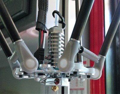

Nice effector Brian!
One question, can this new probe board be used with the E3D V6 or others hotends?
Martín S.

I think you could use it with other hot ends if probe pcb board was mounted at top of hot end, possibly under the bowden fitting?
The hole in pcb is only 7mm diameter, so the bowden collet should just fit through.
May be better to use another set of short standoffs on top of 3 holding groove mount, mount board to those.

There has been testing done with the E3d V6 and the probe board (a bird tells me) and it works just fine. With the board mounted above the hot end it looks close to the Yellow Jacket and there is talk about doing connections from it also. But as of now the narrow hole in the board it a limiting factor for wiring and such. But it does function from what I have been told. Time will tell when the units are out for testing I guess.
Posts: 1561
Re: HE280 Hot End and Probe board on RMAX v2
Post by Xenocrates »
In theory, it should be able to be used like the HE280 is, as the heatbreak of the E3D will fit through the board. However, at that point you would need to wire it to the board, as there is otherwise not enough space for it. Of course, I'm just going by CAD models, not by experimentation. I think the Volcano would fit better, as there is a little more room for the wiring to droop that way.

Brian - if you need a hand with the wiring, or firmware, I can help you out. Send me a message and I'd be happy to.
As for using it with a v6, yes you can. I have it mounted above mine, using one of the top screws on my 713maker hotend mount to hold it in place, the bowden is routed through the middle.
Challenges with mount it like that is that, especially if you have a flying extruder, it's easy to cause effector tilt. Even a little tilt is a BIG deal with the accelerometer, and will throw off your calibration big time. Cable drag, or the bowden dragging on the center, can be enough to throw it off.
Once you sort all of that, as long as it's oriented right and cabled right, and solidly mounted, it works great. Calibration to an accuracy of +/- 0.01mm per probe point.
The firmware from seemecnc replaces G30 so you can't probe arbitrary points, it just does a 4 point calibration routine (equivilent to the "standard" calibration). If you want to be able to probe arbitrary points, I can post the bits I added to g30 in order to do so. I use it with the Delta Least Squares calibration website, and can print a 210mm circle completely flat, it calibrates down to a 0.02 deviation in 3 runs.
