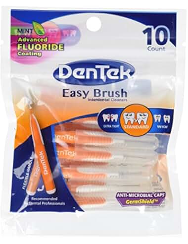

Your dentist has tools that have to be removed form service (the plating is worn so they can not be properly sterilized that sort of thing and these have been free for me just for the asking and they are incredibly useful for this sot of thing.
[img]https://images-na.ssl-images-amazon.com ... _QL65_.jpg[/img]
https://www.amazon.com/s/ref=sr_pg_2?fs ... B01F7PMMQW
if you want to buy new they are cheap
but also at your local drugstore are things like these also dental but home use and sold in many sizes
