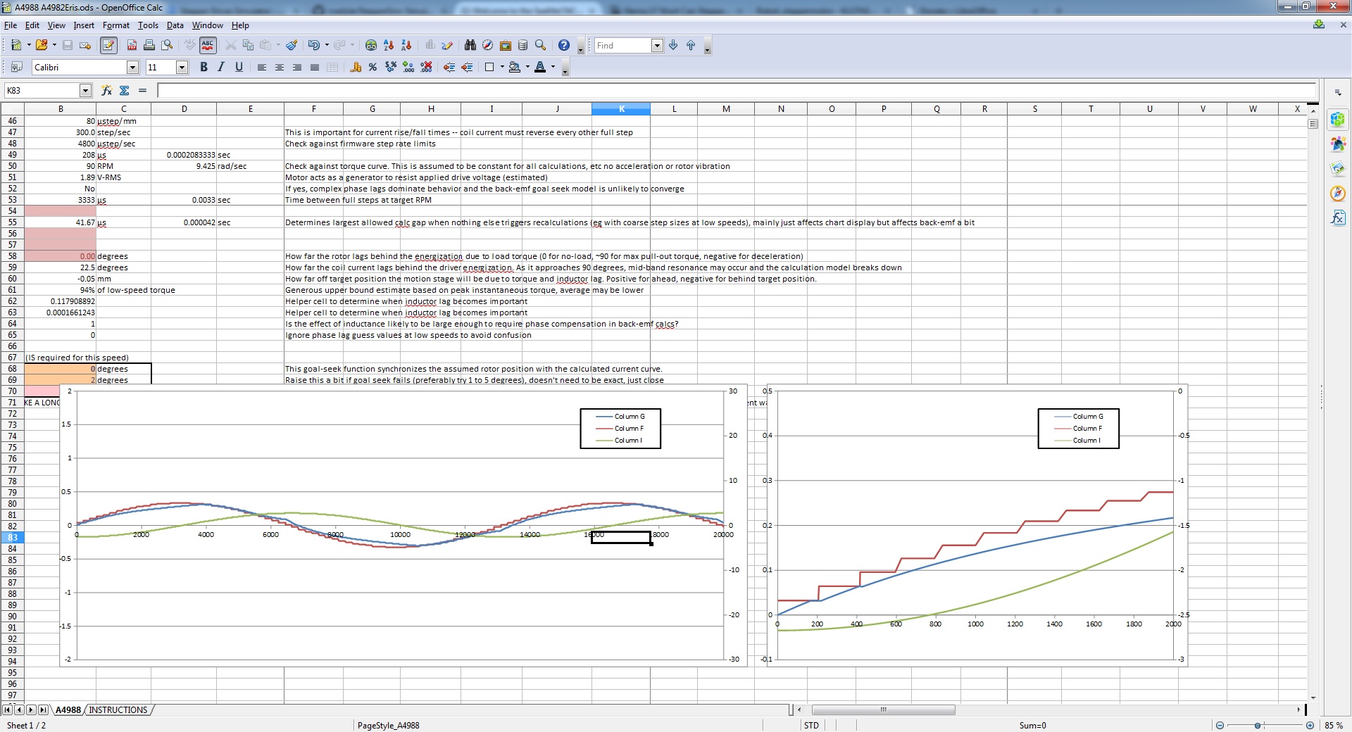

You cannot use microstepping on a 12V rated motor on a 12V rated power source.
https://www.seemecnc.com/collections/pa ... pper-motor
They draw appx. .35 amps at 12v and are 1.8 degree (200 step).
That's why this thing is so noisy, the stepper driver cannot control the current in a high inductance coil that self limits the current.

https://github.com/rcarlyle/StepperSim
motor data sheet http://www.automationtechnologiesinc.co ... 033-4A.pdf
Basically, at 60mm's carriage speed, not effector speed, we already see the inductance high enough the driver is maxed out. Meaning current lags where it should be. Simply put, do not run a 12V rated motor with a microstepping driver on 12V because there is no "headroom" for the driver to actually control current. Like an amplifier driven to clipping levels, the music (motion) pretty much becomes noise (distortion).
Simply changing the motors to a rating somewhere between 0.8A to about 1.2A rated motors in the same size would totally change how the machine sounds and prints.

Should have added, When you see the blue line BELOW the RED line= BAD. AKA Clipping
Per the instructions in the data sheet, the example.
Again, even as low as 40mm/s the curve begins to appear that we are lagging and only gets worse the faster you go.
