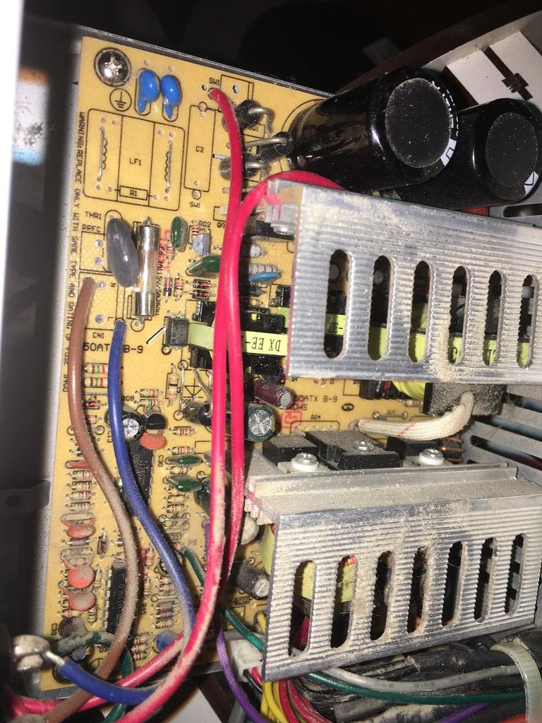

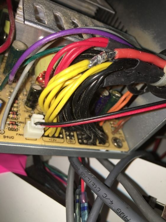

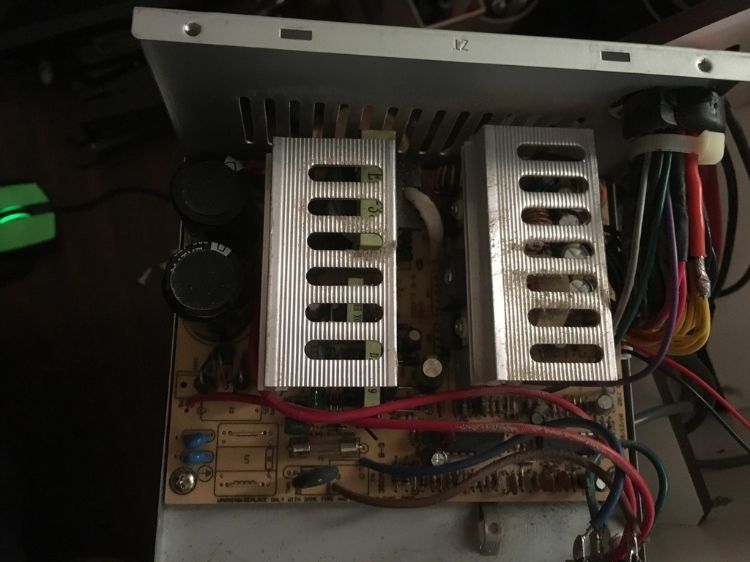

I broke open the power supply, to see how difficult it would be to replace it. And did I get a surprise. Most of the leads were neatly soldered to, what I can assume, is the power taps. What I didn't expect is the 3 leads soldered to other points on the board. (the green, purple and grey leads in the pictures below) Also what I didn't expect is that there is no damage to the power supply that I can find.
When you hear a popping noise, and smell smoke, I expect to see something burnt. or at least a smell of something. The Power Supply seems in good condition from my untrained eye.
From my inspection (both visual and with limited multimeter tests)... Printer will not turn on. All fuses are intact. All components on the power supply look intact. Nothing looks burnt on the power supply. Power Switch working. RAMbo looks in good shape.

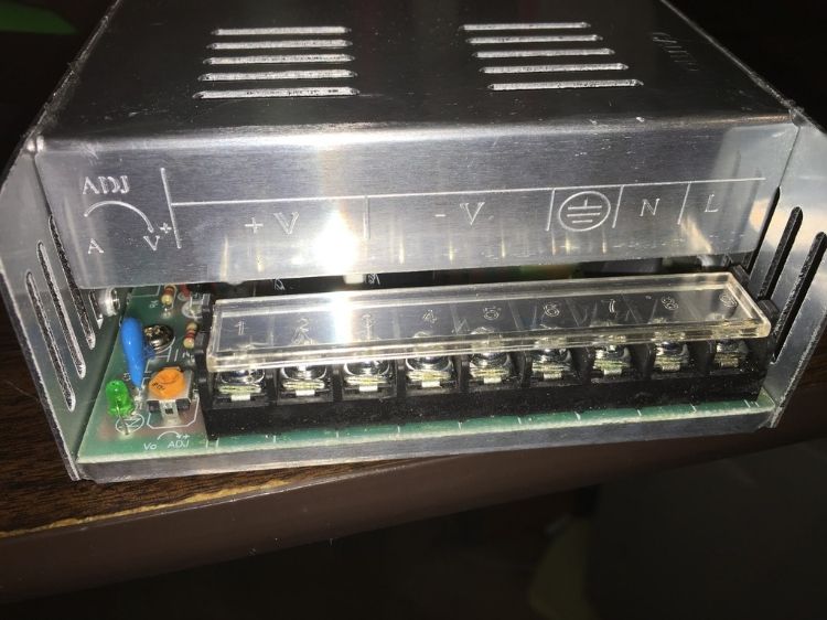

This is the replacement power supply I picked up at Microcenter. it is similar to the one Seemecnc sells as an upgrade to the Maxx v1. Unfortunately it did not come with any instructions. Wiring the 12v side seems easy. The 110v in is the side I'm not sure about.

So, if you haven't got an external IEC connector already (the sort of sockets on computer power supplies), and you've given up on the other one, you should be able to grab the socket out of it easily. Now, there are some things to be aware of doing that. firstly, a lot of them have filter capacitors and other features like a bleeder resistor (To discharge said filter capacitors). I would remove those. They were sized and intended for the computer power supply, and it's hard to tell what they might do to an industrial supply. Second is that looking at it from the back, with the middle contact down, that's Earth. On the left is live. Neutral is right. Once you have it wired up I suggest you take a second with a multimeter and make sure ground and the chassis of the power supply are connected, and that neither is connected to live or neutral.
If you haven't given up on that power supply, you can buy a new IEC connector at Abel electronics in St Claire shores (I think. I looked it up.) They call it a panel mount male, screw in AC convert. Stupid terminology for it. Or loot from a white box power supply. Alternatively, you can order from Mouser. I'd also get a 10A capable switch to go with it so you can shut the printer off. I'd love to see pictures of the underside of the dead supply board. It may also be the soldered on fuse in the power supply. Now, I know you probably don't care enough to try and resurrect it, but if you do, or just feel like indulging my curiousity as to failure modes on power supplies in printers (I have found the fault in one, thus the suggestion to look at the soldered on fuse in there).

Addendum: If the power supply is a conformant ATX with the color code as it appears to be, the three mystery wires are as follows: Green would be PS on, which is pulled low to start the supply (AKA, connected to ground). Purple is 5VSB, meaning as long as the power supply is plugged in it's one. Grey is Power Good, which tells the computer when it's fine to operate.
Thanks, that is what I thought but I appreciate you confirming it.

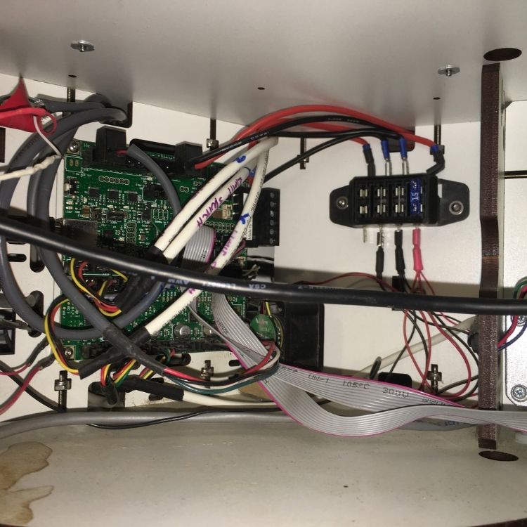

nebbian wrote:What's the red wire with a soldered end doing? Is that an add-on that you did? It doesn't look stock to me.
Nothing in this power supply is stock. the gentleman who originally built this Maxx wanted to clean up as much of the power connections as possible. The good part is there is a minimum of excess wiring in this printer. The bad part is it makes replacing the power supply 100% harder for a someone like me who has almost no knowledge of electronics.

I'm starting believe that replacing the ATX power supply with this one I got from Microcenter maybe a bit harder than crimping on some terminals and connecting them to the screw connectors.
