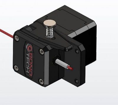

As a huge fan of the mini, I have to tell you this is a great idea based on real world experience. Now specifically, no, I have not done this exact thing (a flying extruder bowden feed on a Delta), however, I am testing the same mini both in direct drive and as a bowden second extruder on another printer.
Because the mini uses a smaller drive gear, the effective linear force is increased compared to say the drive gear on the stock EZStruder, but not just that, grip is increased and friction in the drive is decreased compared to single hobbed gear drives. The reason is, you don't have to squish the filament so hard into the drive gear as in a single side drive, but the grip factor still goes up.
FWIW, I'm running a QR geared bowden (non-flying extruder) on my Rostock max V2 and love it.
If you contact Martin of Bondtech, he can send you the STL files of the Raise 3D N2 mini Bowden drive I was testing that perfect for this application.
I would share them myself but I think he initially wants folks to contact him. E-mail: [email protected]
Tell him I sent you and again, ask him for those files for the Bontech mini Bowden for the N2.
That has the integrated pushfits both top and bottom, is the smallest housing, and has an insert on the side for an m5 thread insert for mounting to a bracket. I think it would be nothing to adapt for this situation. Again, contact martin and tell him Jetguy sent you and he'll hook you up on this.

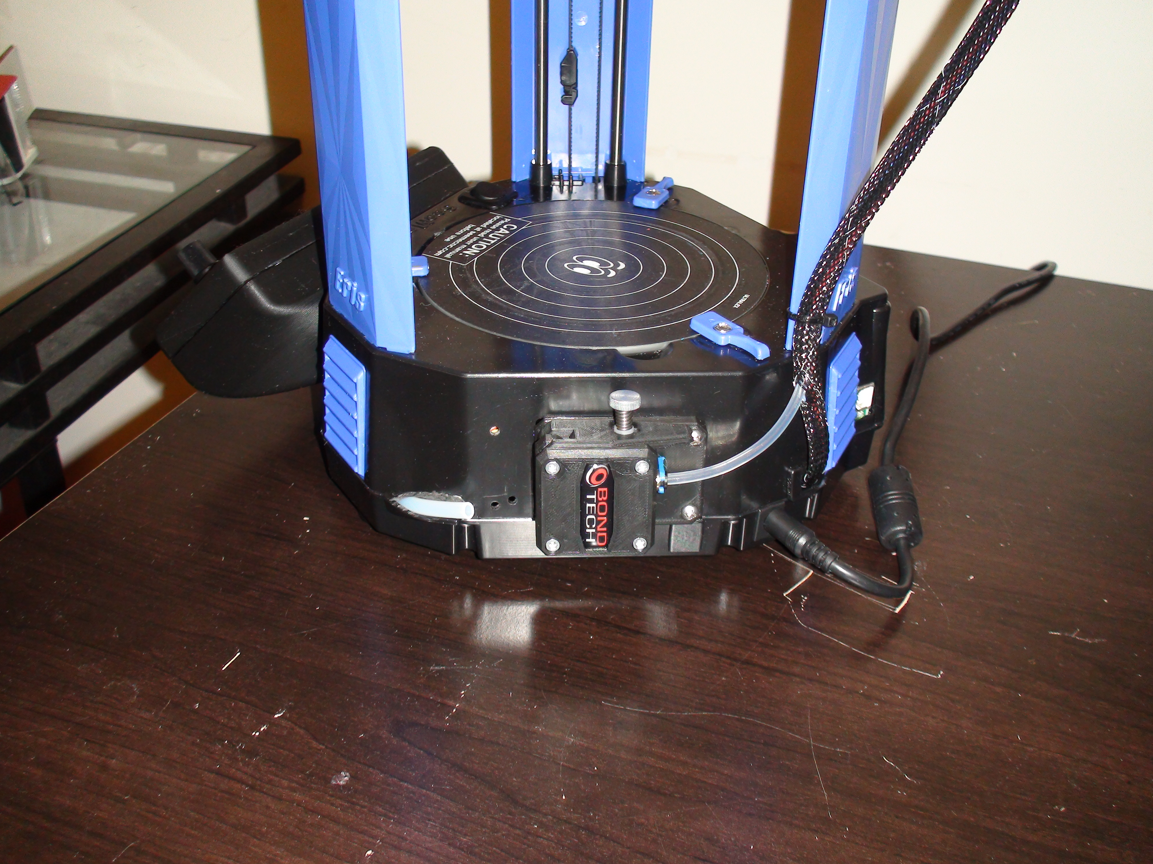

Also, FWIW, I put the Bondtech mini on the new ERIS too!!

More details if you do go Bondtech mini. I totally understand people balking at upgrades, but the feeder makes or breaks your printing experience in a lot of cases.
Since the motor is not attached to anything, definitely turn down the current or add a fan not not melt the housing. I printed my test ones in Raise 3D PLA/PHA blend that is pretty heat resistant, but sent off my final versions to Shapeways in SLS printed nylon. Again, this is a huge, huge upgrade over stock, same reason I put it on the ERIS.
You need the mini gear kit http://shop.bondtech.se/ec/kits/bondtec ... gears.html
also get the optional $5 thumbscrew, spring and washer add-on.
Then you need a second pushfit from here http://shop.bondtech.se/ec/components/p ... -4-mm.html
$2.10
And, if you want to use that M5 hole for mounting, get an M5 insert http://shop.bondtech.se/ec/components/t ... rt-m5.html $0.40
So you are looking at:
$55 gear kit+ thumbscrew
$2.10 for the other pushfit
$0.40 for the m5 insert
$57.50 before shipping- also need to print the housing.

The Wanhao kit won't have pushfit in and out, which is kind of what you want for a flying extruder. The Wanhao is basically the same design, just specific to fit that printer and since the feeder its above the hotend, no lower output pushfit.
So basically, you pay $85 for a printed housing and gearset, and it's not ideal for what you want.
For reference, when I sent off to Shapeways, the printed parts were roughly $45 with shipping (it's 3 separate print parts).
He's getting a better deal on his printed parts and I think giving a little kit discount (maybe).
It you ask him or come up with a design, Martin is really great to deal with and might be able and willing to really help you get the custom part you want as a kit. But you might wait a few weeks as he is sending off the print just as if you sent it to shapeways.
In my mind, buy the gear set, print a test housing, run it, and then order the SLS parts or don't, just keep on using your printed parts.
I ran for a good month on my printed parts without even the hint of wear or an issue. But I like the security and toughness of the SLS nylon, and they look sharp. I figure if I'm upgrading, might as well go the extra bit.
As to current, the general rule is about 80-95% of rated current. A Kysan (assuming the common 1.5A rated) roughly 1.2 to 1.35A would be what I would use. Not knowing your driver and setup, I don't know what vref to you need to achieve that setting.

Well it turns out that my existing mount works fine since it attaches at the stepper. I do need to reprint it in a more resilient material than PLA though. After so many hours of printing the mount has warped a bit and now I have to also use a few zip ties to hold it in place, and even then it's kind of sloppy.
I went ahead and printed the Bondtech Mini files in SeeMeCNC black ABS. It's the first ABS print I've done in months, and I did print it at a low resolution. It looks kind of shitty due to my flipping the Front STL and having it face down. There are lines from the support material and it's been manhandled a bit, but I think i might reprint it at 0.1mm resolution and then give it an acetone "bath" so it looks nice.
I'm printing a benchy as the first test as I type this. As soon as my phone charges a bit I'll take a couple of pictures so you can see what I've got goin' on.
Here's what I've got going on at the moment: http://imgur.com/a/s6txb
Edit: Not sure why there are some duplicates in that album. I only uploaded 6 images. Lol or maybe Imgur is only being wonky for me, Idk.
With regard to stepper heat, I turned the current down from 165 to 140 for the extruder stepper in the the firmware. It still feels hot, but maybe not as hot. I need to find my IR thermometer. I just hope it'll hold up once I get this beast into a heated enclosure.
