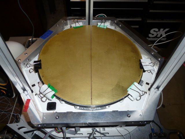

I have been trying to dial in certain aspects of my Rostock Max v2 for quite some time now and seem to be stuck. These include flatness of the bed to the machine and the ability to print objects that are square or as programmed.
First some printer history. This printer was purchased used and included Tricklaser carbon fiber arms.

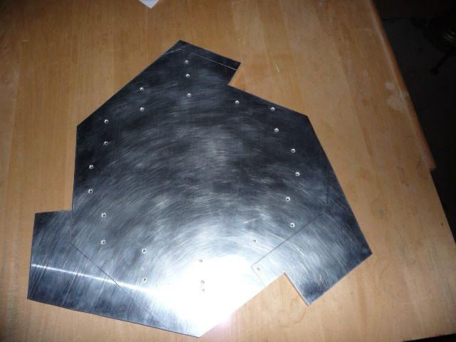

I discovered that the bed base that the Onyx heater mounts to was not flat so I manufactured one from 1/2 MIc 6, I also have a piece of 1/4 mic 6 covering the heater. A cork spacer insulates the heater from the bed base. I also made an end effector from aluminium. This machine also has trick trucks. Also at bed height and toward the top to the printer I manufactured some braces that fit between the towers. They bolt to the machine using the slot in the tower extrusion. As viewed from the top my printer has taken a hexagon shape. Upon rebuilding this machine I am sure that the towers are square in both directions with an error less than .1 degrees. Through further reading you may discover otherwise.
Using a digital travel indicator with the center of the bed being zero I get the following results. Negative numbers show bed being lower positive numbers show bed being higher. At the towers I see in mm X=0 Y= .02 Z= -.001 the reading at positions opposite the towers X Opposite= -.09 Y Opposite= -.14 Z Opposite= -.10. Unsure if this is reasonable or not.

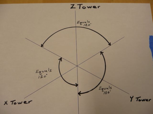

I am now including a few photographs of rough drawings I created that will hopefully help someone to help me to me sort out my machine's discrepancies. I have tried to explain what each photograph is meant to represent. I am having trouble coming up with he proper words that will explain what I am trying to say. It is my hope that each image is worth a thousand words......
Fist a word of warning. I haven't quit figured out how to include images or photos within a post. This is my first time. The urls should lead directly to an image as described in the description prior to the url but I believe it also includes to the two other images that I will later talk about in this post. I hope it does not lead to too much confusion. I did use photo bucket. I may need your help with this as well.
This first image is of the 120 degree angle at each tower. The 120 degree included angle is created by lines generated by plotting a line from the other towers and though to its respective opposite.http://i1249.photobucket.com/albums/hh5 ... jrdncc.jpg

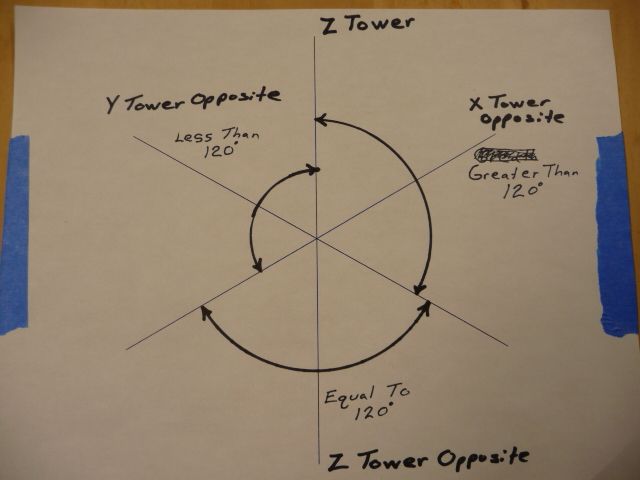

The next image is of the 120 degree angle at each tower opposite location. The 120 degree included angle is created by lines generated by plotting a line from the other tower opposite positions and its respective tower position. In this example I am using the Z tower location as a reference because its opposite opposite included angle generated by lines plotted form the X and Y towers through to the center of the heated bed was equal to 120 degrees. I do realize that my logic may be corrupt but I am not sure where to start as am learning as I go. http://i1249.photobucket.com/albums/hh5 ... hbzmwy.jpg

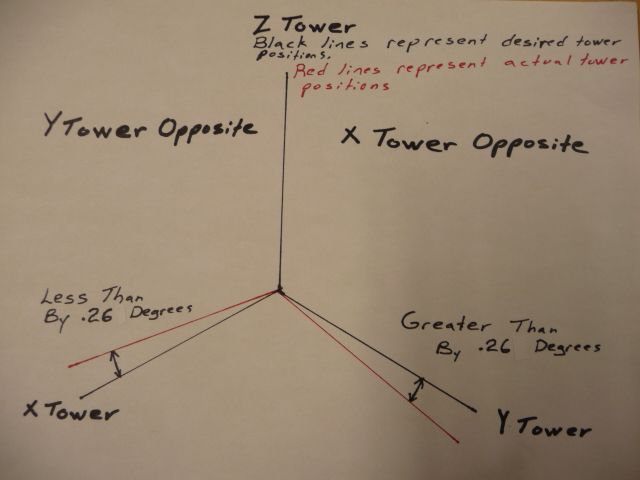

This last image is of the desired tower positions as indicated in black and of the tower actual positions as indicated in red.http://i1249.photobucket.com/albums/hh5 ... wnulcw.jpg
I have been pondering this issue for some time now and have not come up with a solution that will eliminate the angular discrepancies without creating discrepancies elsewhere. I have considered rebuilding this machine taking greater care to make sure the towers are closer to being square. As I mentioned in the beginning of this thread I am sure that the towers are vertical to within less than .1 degrees. I have machined a square with a base that is 1 inch wide by 5 inches (this keeps it from tipping over without having to hold onto it)

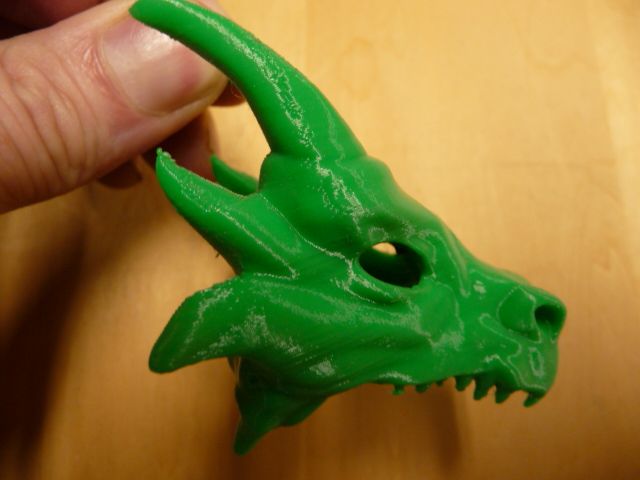

Qdeathstar, You mention that I should post some photos. I have thrown out anything you may consider helpful in diagnosing my dimensional issues. As I am typing there is a 50mm x 50mm x 8 in the works.
I do plan on printing something that will show the angular deviations that I have mentioned in earlier posts. I do not believe they will be available earlier today as it is getting late (early). I stayed up way to late last night. If you keep reading you will see a couple of prints showing quality of a printed part. Thanks for your help as well.
The first image of a dragon head.
http://i1249.photobucket.com/albums/hh5 ... w9td8q.jpg

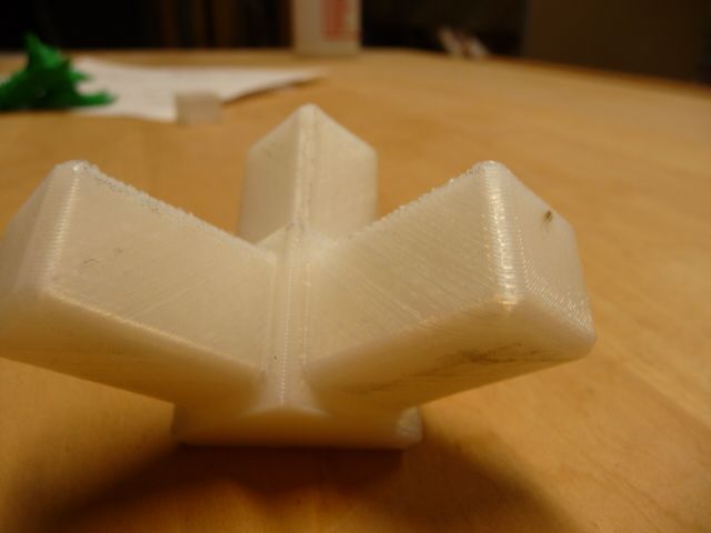

Second is image of a corner bracket that will fit into 1 inch square tubing. You will notice that the inside corners of the legs do not look very good. I believe this is where the printer moves from one leg to the other.
http://i1249.photobucket.com/albums/hh5 ... bv6dgr.jpg

ccavanaugh had posted (I can't remember where on the forum) but a guide to getting dimensionally correct prints. The reasons you are not getting perfect 120 degrees is due to either the squareness of your arms and or tower lean. Take a look at this PDF that goes through a pretty good diagnostic procedure as well as how to fix the issue.
https://github.com/ccavanaugh/Max-Metal ... f?raw=true

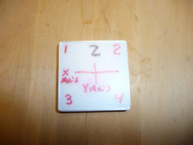

I am offering an image prior to any explanations of a 50mm square x 8mm tall cube that was printed last night. To help clarify the explanation that follows. http://i1249.photobucket.com/albums/hh5 ... vonfuc.jpg In this print I am seeing the following deviations. All sides appear to be flat with the X axis side that runs from corners 3 and 4 being the exception. This side bulges out slightly. The vertical sides appear to be parallel. The horizontal sides do not. This could be an effect of the bulge. As far as being square. It is not. Corner 1 is less than 90°. Corner 2 is greater than 90°. As far as corners 3 and 4 go I would have to say they are close to 90°.
If the followers of this thread are not fully frustrated or bored to tears please continue on. At the beginning of this thread I mentioned that my printer looks like a hexagon when viewed from the top. This a view at the heated bed, the view just below the micro switches is the same. The basic dimensions to build these were obtained from somewhere on the SeeMeCNC site. The center section is 1 inch tubing the elbows are solid and key into each tower. They were produced in hopes eliminating the problem I am still having now. Roughly a year later. Did it help with the problem, not sure. Did it make it worse, I don't think so. I do not always have as much time as I would like to work on this so things are going slow. That is why I am asking for help.

Yep, you really need to read the guide in detail and focus now on the parallelism of your arms. Print those calibration prints in PLA and show us the results.
