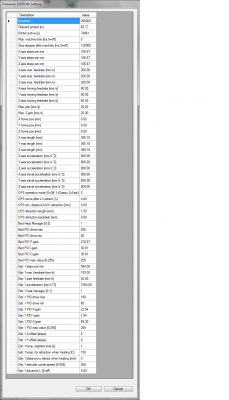

So I am trying to calibrate. I bought my kit with lcd kit so I am using polygonhell's Repetier firmware. After reading the forums a bit I changed the EEPROM mm per steps to 106.67 for each axis and 584 for the extruder. My Z height is 368 mm and movement in Z seems to correct. However things get weird when I move in X and Y.
When i move in X and Y the movements are larger then they should be. For example my arm is are near parallel to the Z tower at Y87? Shouldn't that number be more like 120?. BUT the Z height also drops 20 mm during that movement - making calibration impossible!

The only changes I have made are through the eeprom. I have metal 15 tooth pulleys not the newer 20 tooth and I have my steps at 106.67 which should be correct.

Here is what what I have my EEPROM settings:
I assume that since you reloaded the firmware that you have
#define EEPROM_MODE 1

You can't set the motor gain in the EEPROMm, it's one of the few things that has to be set in the code.
the line reads
#define MOTOR_CURRENT {135, 135, 135, 135}
for a rambo 1.0 that's 0.75A I believe for an 1.1 it's much lower than that, I'd try 200, if it's too high the drivers will over heat and you'll either get the motors jittering or see missed steps sometimes minutes after you start a print.
