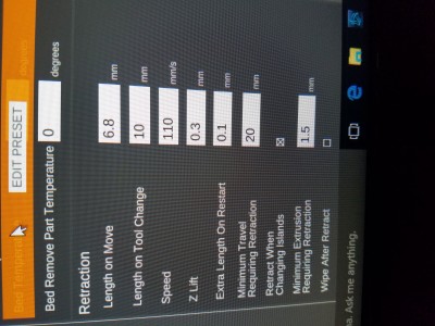

Re: Print error I can't seem to fix.
What are your retraction settings?
Gundy1024
Posts: 83
Joined: Sun Apr 19, 2015 11:14 pm
Location: Norman, OK
Post by Gundy1024 »
Here is what I have for ABS retraction setting. Also, while I was looking for these I noticed that for some reason my nozzle size was set to .5mm when I have a .4mm nozzle installed. Not sure how this happened unless it did it during the latest update of matter control. Trying another test print real quick to see what happens.
Retraction settings
Retraction settings
Sorry about the side ways view, not sure why it won't post it right.
