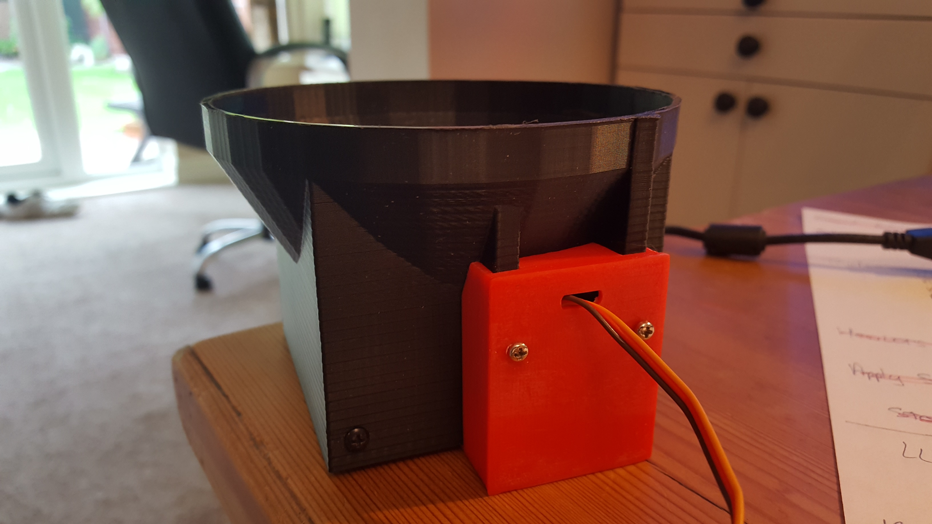

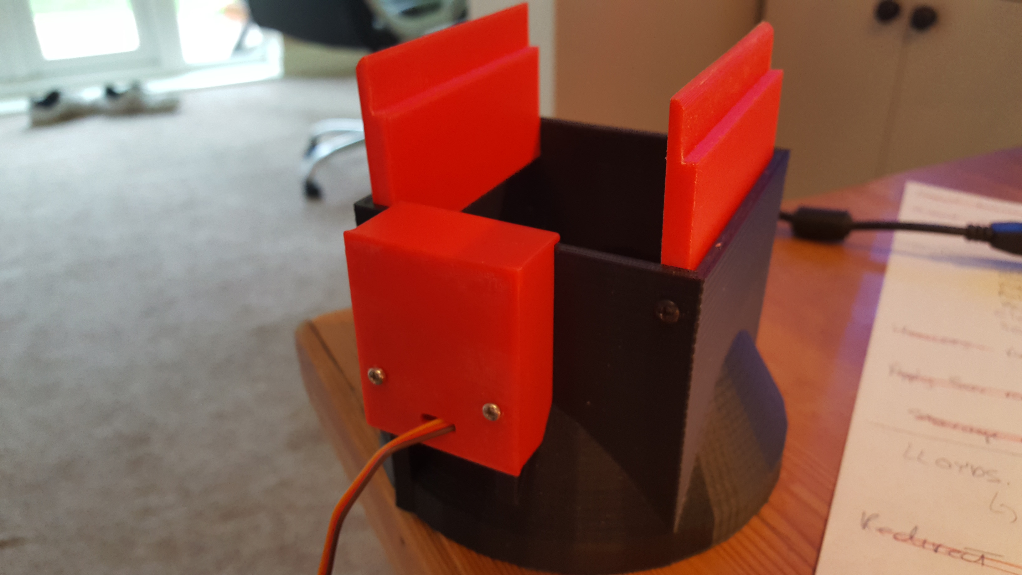

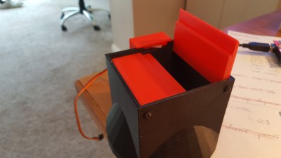

What... its.... printed.... something.... correctly :o
I am sure it could be better, but finally.... something that actually goes together and works (servo operated release valve)
Its the best quality I have had out of it by far
Now just need to get off Tinkercad (oh so easy to use) and then I might actually start getting round prints, rather than stepped circles.

Looking good!! Printing off a SD card eliminates a lot of potential problems.
I haven't played with Tinkercad,,,, but other cad programs have resolution settings you can change when you save your model as a stl file. It makes for a larger file, but smaller flats.

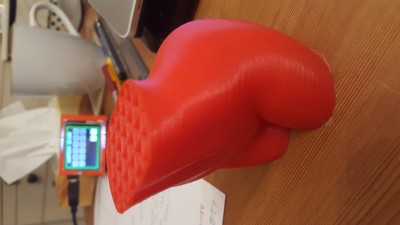

About how tall is the part? ~79 MM?
