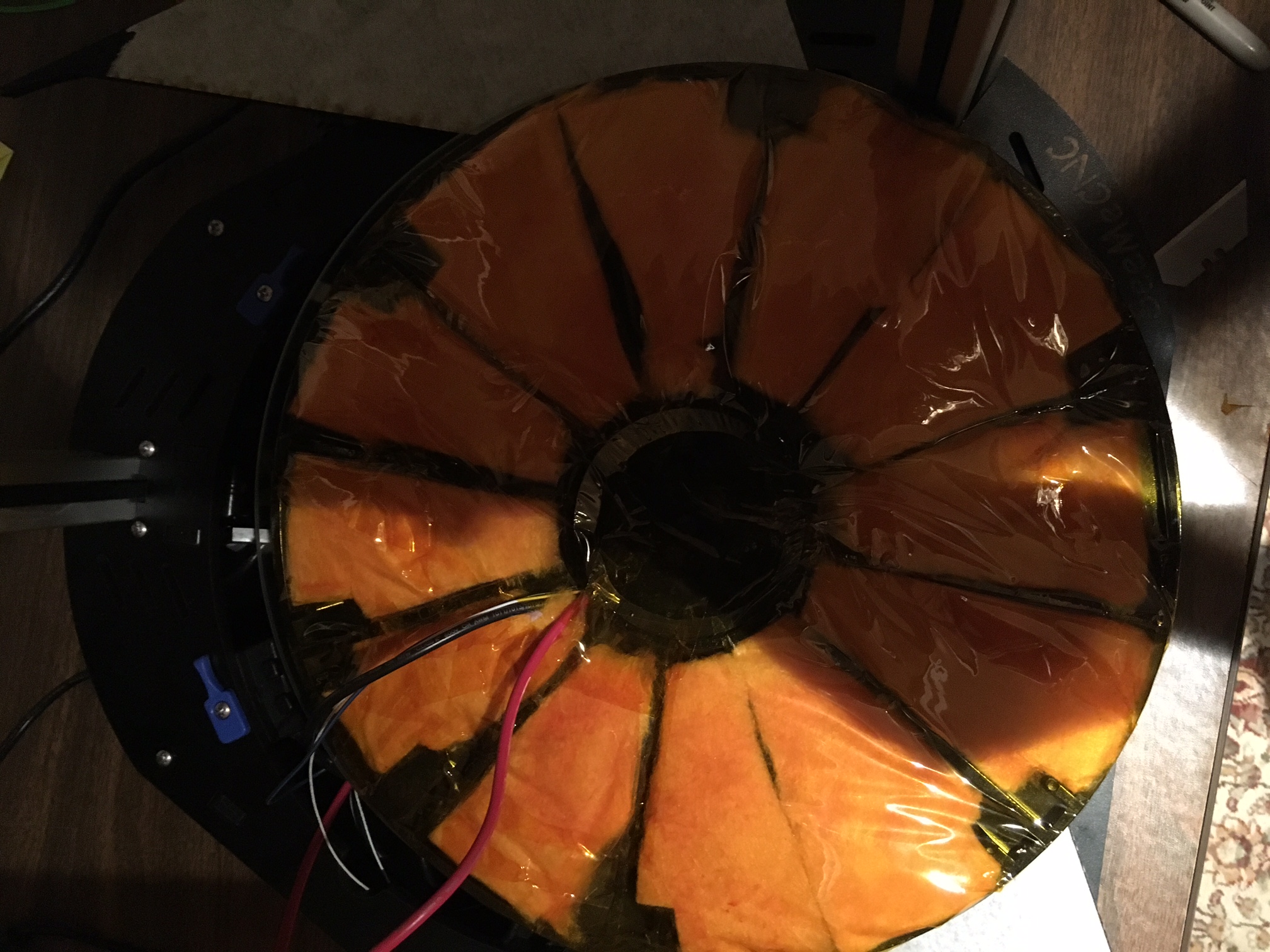

I realized that a tremendous amount of heat was being lost the the huge 60mm fan at the base, as well as the powersupply fan.  So i bought fiberglass insulation from homedepo cut it to match the shapes at the bottom of the plate,  and used kapton tape to attach it.  make sure you remove the material from where the feet will sit!!!  and the insulation should allow for room above the fan for the power supply.  i was able to go to 90 with a uncovered heat bed now i can get to 100,  with it covered i can get to 120 relatively quickly.  i did not add it to the center becasue i wanted more cooling in the center for better heat distribution over the whole plate.   i will add some pictures as soon as i figure our how.
						Re: My solution to heatbed temp- insulating the bottom!
here are the pictures, takes about an hour, but take your time do it right.  also this picture was taken before i removed the tape from the foot contacts.

update! i was wrong with my initial improvement numbers,  i can get much hotter without anything insulating the top.  with no top insulator i can get to 115 in 40 min,  110 in 30 min ,  i can reliably hold 110 while printing,  this is a huge improvment and only cost 2 bucks.  highly recommended!
and yes the base stays way cooler, the power supply fan hardly ever turns on now.  forget all that with getting a new powersupply, this is far cheaper and easyer.

Couldn't you increase the length of the spacer beneath the wood snowflake plate and put a piece of insulation under that?geneb wrote:This neat trick isn't applicable to a v2. At all.
that is very clean, and looks nice! also i recommend putting a thin piece of sheet metal over the power supply, but on the edges of the wood frame that holds it, that puts like 3/8 inch of space over the power supply. it helped allot because when that fan comes on i would see a big drop in temp without it.Twac1 wrote:Here's what I did. Works good!

Yes you could, but it will cost you build height. Besides there is no real airflow between the bottom of the onyx and the top plate of the base on a V2, So I don't think it will bring much improvement.gchristopher wrote:Couldn't you increase the length of the spacer beneath the wood snowflake plate and put a piece of insulation under that?geneb wrote:This neat trick isn't applicable to a v2. At all.
