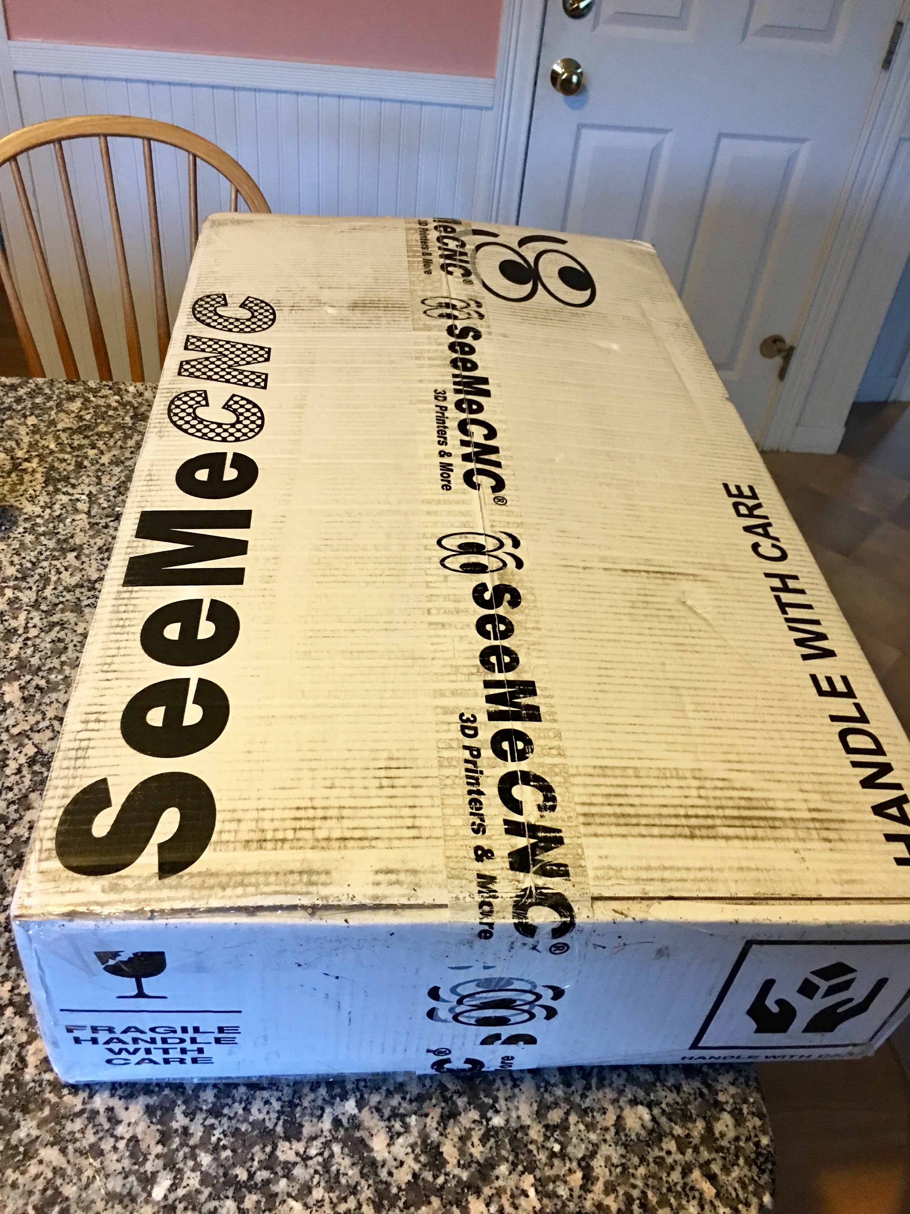

It arrived!
You can never have too much filament:
And some of the extras I got and some SeeMeCNC goodies:
