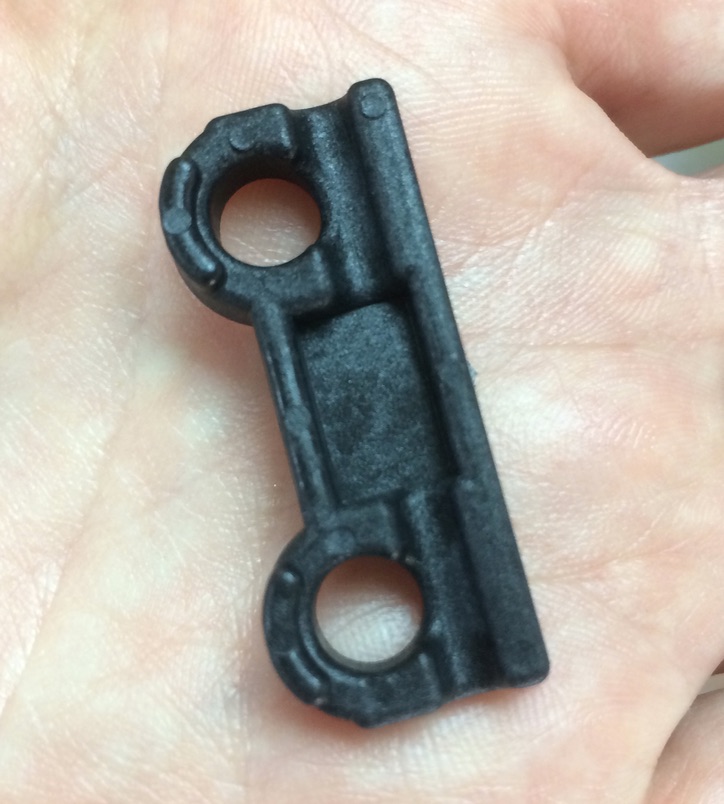

What is this piece? It is in the bag with the belt clamps.
Re: dmpalmer's Rostock Max V3 build
No idea! Didn't use them. Might be a V2 holdover.
Please go to my build thread and check my posts on the HE280 fan connectors and make sure yours are good. The factory installed the fan connectors backwards on my PCB.

I believe it was said that the spare parts are for installing the new carriages to the old arms that uses the steel axles and universal joints. They have to get rid of them some how. :)
