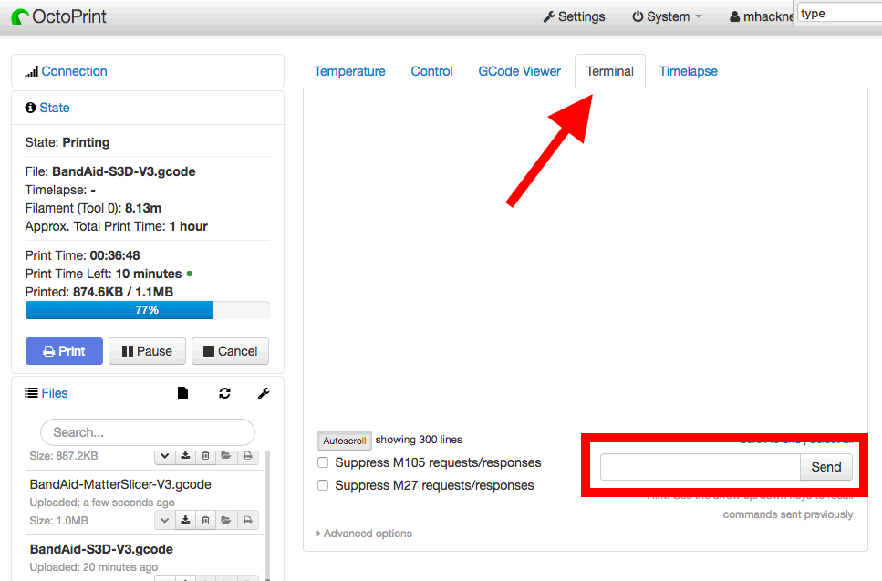

mhackney wrote:We call that "extruding into air". How fast and how many mm of filament were you extruding into air?
Let's start with this then since it is the simples way to reproduce your problem. I am asking that you not attempt to print anything until we can successfully extrude several hundred mm of filament into air at a reasonable speed without skipping.
Start slow, extrude 50 mm at 10mm/s and let's see what happens. To do this, you are not going to use the jog controls on the Control tab - not this:
Instead, you are going to use the console input field on the Terminal tab - this:
This will let you explicitly state ho much and how fast to extrude. You will enter gcode directly into this field. Here is the first extrusion you are going to enter:
M83 ; set extruder to relative mode
G1 F300 E100
This says extrude 100mm of filament at 300 mm/min. G1 is the move gcode, F is the speed and E is the length of filament to extrude. I can't test this right this because I'm in the middle of a print. But give it a try and report back what happens.
Make sure that the filament is not chewed up and that the extruder cog is not filled with plastic.

Re: Backpressure Issue
Yikes! That's not a good thing to do as you get molten filament in the threads where the nozzle screws in and makes it very difficult to assemble correctly. But the good news is, at least you now know it isn't the heater/nozzle. You could still have a snag in the cold zone or there could be a problem with the extruder (the items I listed in the earlier post).
