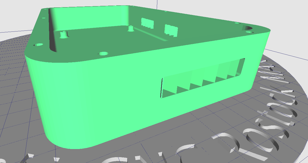

You can use an STL editor to add support to STL models you download. I forget which one (open source) actually has pretty good tools for doing it.
You can really tweak the support to get the best results. For instance, to support a long bridge I'll add in a zipper like this screenshot. Notice that it does not touch the side of the opening. It is also exactly 1/2 of a layer height shorter than the opening. That also minimizes interlayer bonding. These are just a few tricks you can do if you roll your own. The little time spent up front in learning is more than recovered with consistent and great results later.
