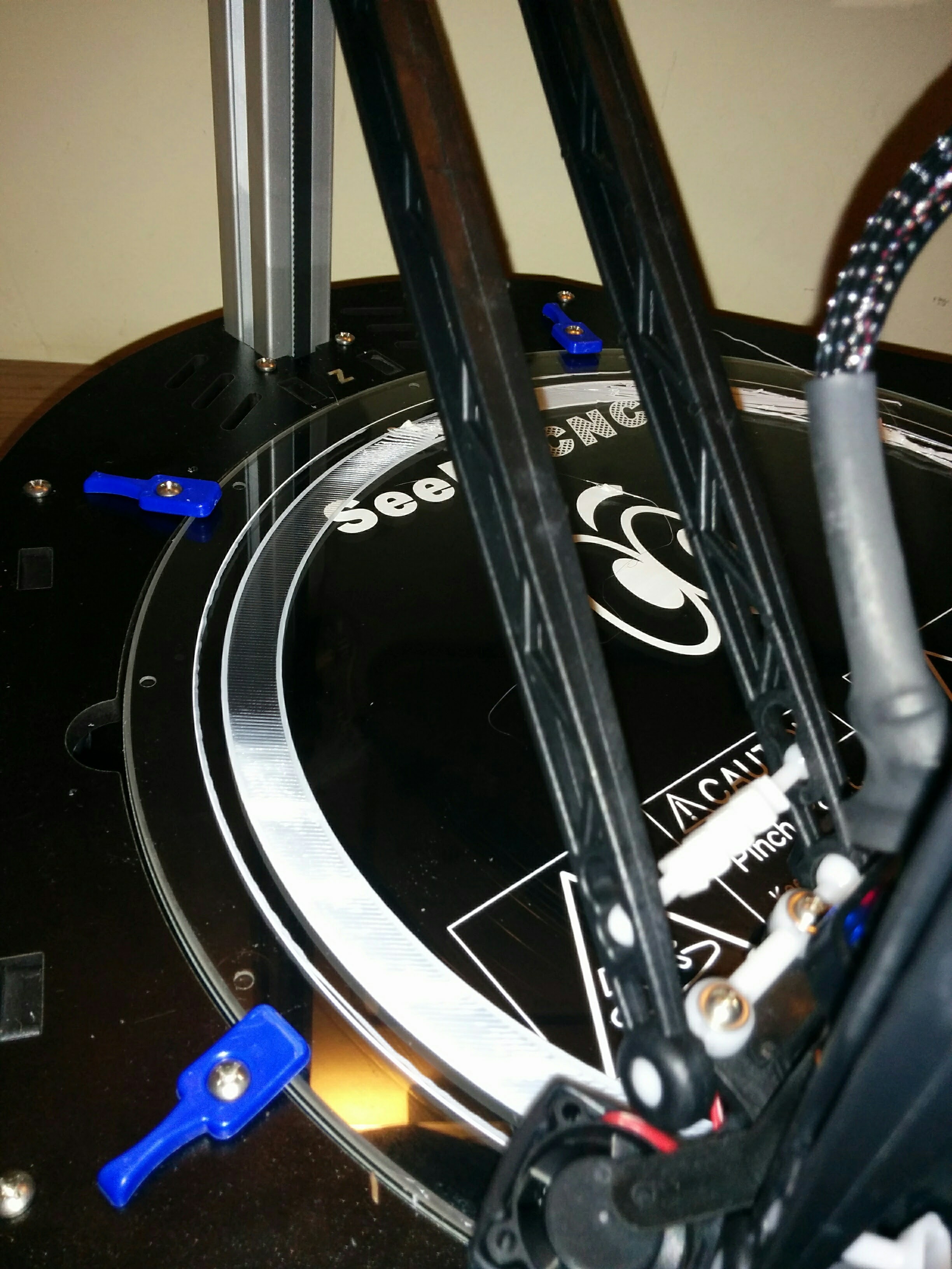

Well, I squared up the towers (two were 1mm off or so), adjusted the endstop screws so that the tower endstep offset was under 4 on all 3, ran the probe "hot" and it didn't appear to help much with the thin side.
1st layer
2nd layer
I am running hotter on both nozzle and bed this next time trying to get a better start on the ring.

Good job. At least now you've eliminated a couple of mechanical issues. I haven't had time to investigate the bed mounting yet. That's next. I'm convinced that the firmware is doing the right calculations but something mechanical is causing the problem. My sudden change for the better after removing the FabLam might not be related to the surface, perhaps cleaning and refitting the bed assembly was the underlying culprit.

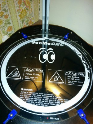

Here is an update after working to get the x/y/z values as close to 0. This is the same file I had printed earlier that had the low spot between the x and z axis.
