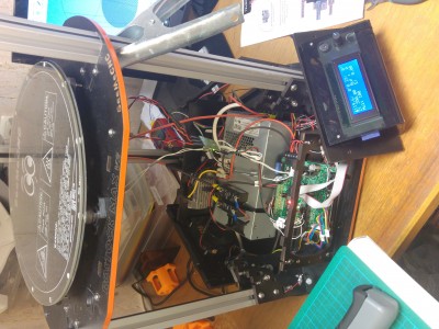

Recently I have been adding a 24V PSU to my Rmax V2. I choose this Delta Electronics 600W 25A PSU above the Meanwell, because of the better price and better shipment conditions (digikey sends shipment free to Europe):
http://www.digikey.nl/product-search/en ... 45-1068-ND
Installation went fine. SSR (crydom) and stepdown and also the PSU itself do not get warm at all. I noticed however a change in how the bed gets heated. On the Viotek PSU I could see the bedheat-led blink very fast when it came to temp. Fast switching on and off due to PID pwm. That behaviour changed. Now the bed heater switches on and off in seconds, or max 2x a second or so. It gets to temp very quickly, and keeps temp nicely. A bit irritating is that the PSU fan follows exactly the same pattern, switching on and off a lot. I would not mention this if there was no problem though...
Problem is that the PSU shuts down after about half an hour, even with unheated hotend and no motion. After a power reset it comes on immediately. You would think it can not handle the high load and has a temperature switch, but it does not even get warm to the touch. The high load when heating continuously seems to be no problem. I see no drop in voltage (trimmed down to 20,5V). I am thinking that the PSU might not handle the very fast PID switching very well. Does that make sense?
Maybe I should turn to bang-bang pwm for the heatbed. Advise is welcomed!

I do suspect you are correct, and that the switching frequency is the problem with the setup.  I think that the correct answer may be to set the control to either dead time (heat manager 3), or to bang-bang with a set period, and move the period to the lowest reliable value.
I recommend dead-time control primarily. If you were moving over to duet firmware, I know that it has different control rates for different heaters, such as chamber heaters only running at 10Hz. I don't know enough about the repetier firmware to be able to tell you how to change the PWM rate, which would honestly be the ideal solution, as you could keep PID control and get rid of the random shut-downs.

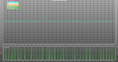

I have been dry-running the bed for about 40 minutes now. I do not experience a lot of change in behaviour with this and my starting point, except for the fact that it has not shut down on me, yet
 I think I can be satisfied wit the temp curve as it is now.
Some spike do not show up on the graph though (not even when I zoom in). A deviation of 1 degree C is not bad I guess. Except for some small incidents that is. I expect it to be even better, and the spikes getting less frequent, when I add thermal mass (aka heatspreader). But if possible, would a few gents or ladies please share their bed setup with me? Heated print bed that is...
