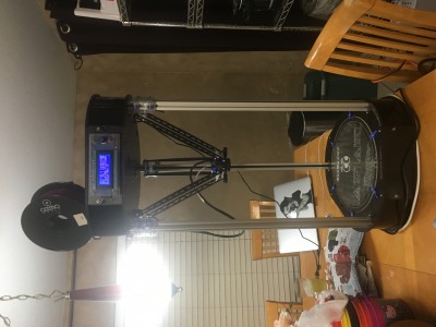

Hi joemod and congrats on your new printer being assembled!
Could you send us a picture of your new printer?

Sure thing!
Had to move it to my kitchen table for some extended diagnostics, calibration.
There is something about the third day of printing... Day 1 and 2 were great. Day 3, I was printing some PCB standoffs. Got a little overconfident and walked away for a half hour or so. Shortly after the print got picked up and carried around the bed for the remainder of the print.
Got the new springs in early (last friday). Installed them on Monday (Halloween, maybe cursed?). Cleaned off the nozzle of any remaining abs stuck to it.
Then, after running the bed levelling script, the extruder nozzle a little high. The filament won't adhere to the build plate. I never ran any in depth calibration. It very well might just be under extrusion, or a KISSlicer setting I *tuned* for my old bot.
Need to give the girl a little attention
** Edited a few times to try and get the pic to orient correctly. BB must be smarter than me **
