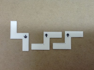

So yesterday I got my new belts from SPI. I installed them and printed out mhackney's infill calibration part to make sure it was still good and found this.
Any idea what I should look at? The only things I did was remove all the belts, so that I could get the gear drive out to make sure they weren't sharp. Then put the belts back on, only one is new.
I know it's not my delta arms because it was printing great before a belt went, and I didn't mess with them.
It's not the blues... What could it be?
Re: It's not the blues... What could it be?
Maybe an overly tight or loose belt?
I've got them a little looser than before. I hope that's it, I'll check it when I get home
What did you discover that was causing the problem?Av8r RC wrote:I've got them a little looser than before. I hope that's it, I'll check it when I get home
The jury is still out.
I tried messing with the belt tensions. Went from way loose to way tight. With virtually no difference.
Then I checked the cheapskate assys. My Z one wasn't the best. Spent about an hour messing with it till it felt like the others. Tried it again and it was only marginally better.
At this point I was out of ideas basically, so I started measuring everything. Turned out my towers were a little off, I guess from picking it up and moving it numerous times. So I spend a lot of time redoing my towers.
Tried it again and it was better, but still had some small gaps.
That's where I left it a week ago, and haven't turned I on since. I currently have a lot of other things going on right now, but will hopefully get back to it in a few days. I guess I'm just going to take the arms off and recheck them, even though I know they are as smooth as silk.
