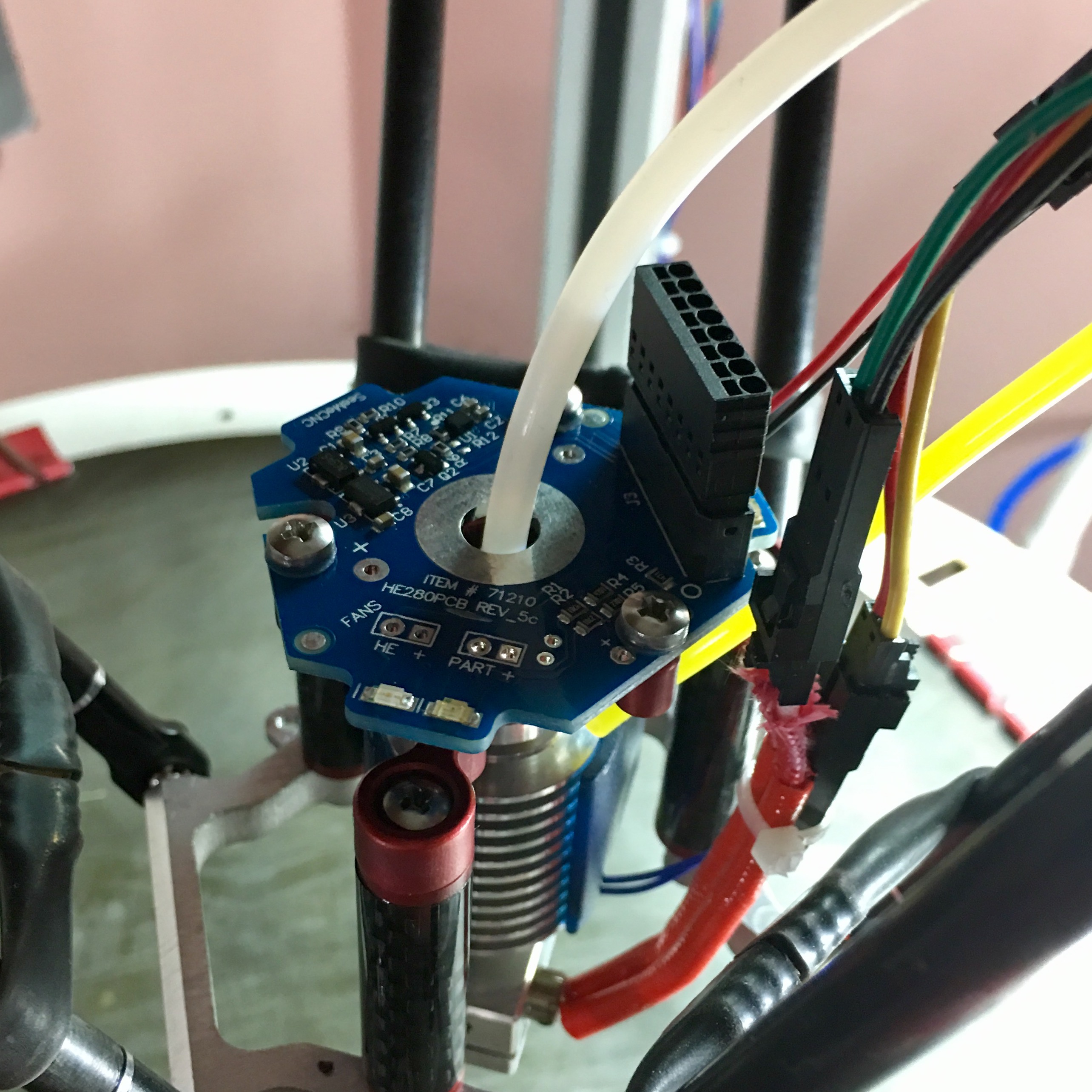

So I have the proof of concept working on my bench. The HE280 is interfaced to Duet (an 0.8.5) as a three wire endstop on E0. I tap the HE280 and the probe captures it, relays it to my Arduino Micro where I process the signal and output the probe event to the Duet. Duet sees the probe tap and would act accordingly if it were controlling a printer!
The next step is to get everything installed on my V1 to actually test probing. I do have a little wrinkle in that I'm using an Arduino Micro on my testbed and it is not suitable to use on the machine. I have some ATTiny85s on the way and can program and connect one of these easily. I'm not using the HE280 on this machine to power the hotend and fans since this is a test. So I need to run 12V power to the HE280 as well as the 3 lines I need to mimic an end stop. I'll have all the wiring installed and ready to go when the chips arrive.
Thanks to Matt at 713maker.com for sending me one of his HE280 robe mounts and to SeeMeCNC for replacing my "blowed up" HE280 so I could get this far.

Most of the arduino chips will operate on 3.3V. Of course, the I2C signals from the HE280 are 5V based, ironically having been level-shifted from 3.3V.
BTW, if I read the specs on that plug connector correctly, the wires aren't crimped in, they're stuck into a spring connector. Which can be enticed into releasing said wires again. Might be easier than cutting them. You've got a connectors to play with, so you tell me if that's a useful idea.
And now let me drop a shoe and see what you think:
I think you're going to a great deal of effort to adapt a specific piece of hardware, when it is probably easier and maybe even cheaper to simply replace that piece of hardware and get a more useful product that will interest more people. What if you just put an accelerometer on your little board and interfaced it for an endstop connector (much like you probably planned with your original project). Then you get something that can be used wtih ANY hotend, so long as you can mount it firmly enough. It can even be used with the HE280 by reusing the 3 harness wires as you planned. Or by running new wires and choosing not to use the stock probing feature.
Re: Interfacing to the new HE280 accelerometer...
Thanks Eric, yes the wires can be removed safely from the connector so the connector can be reused. I've done it a few dozen times already.
RE Shoe... I agree but the SOLE reason for doing this is for folks who have a V3 and already have the HE280. A dedicated probe board would be the next step. The other thing is, mounting any probe is a PIA for folks. The HE280 PCB has a simple mount and after market adapters for other hotends are available already. I wanted to start with this proof of concept to see if the idea actually works. I am very confident now that it does. I think a simple "spliced in" ATtiny85 can be used with the HE280 and it's worth spending another few days on that. Then I do think a universal probe makes sense but figuring out a mount that can be readily adapted is critical to success I think.
