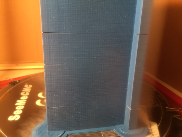

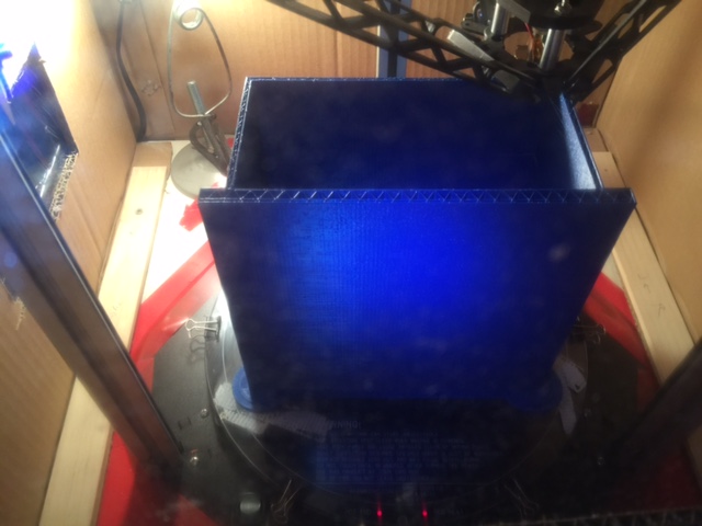

So...I printed (still printing, will be finished in an hour) my VERY large print. All was near-perfect last night. But this morning I checked on the progress and see the delamination. So bummed. All seemed to be going so well. I expected a few small cracks but they continue to grow.
I'll post again under "show us what you printed" when complete.
Q: should I increase the squish?

ABS? You may have to go slower, or increase the temperature of the hotend. Just like welding metals,,, you have to bring the base material, in this case the previous layer, up to temperature to fuse with the new layer.
