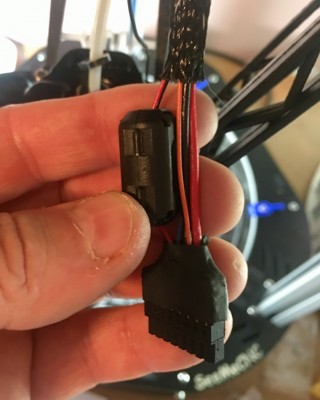

One of the key things we found was that running the V3 probing 3 times helped. I'd normally attribute that to human observational error though I don't think it can hurt to calibrate 3 times.
Re: P003A HE280 [Solved?] Auto Leveling Issue/Bed Leveling Issue/Calibration
@miaviator: I installed the ferrite beads:
The one near the effector is a PIA but needed to be done in the interest of testing! I then did a calibration cycle, checked my EPPROM offsets and they looked right. I did a test print and the first layer was right on, no thin spot. I am finishing this print now. Lots more testing needs to be done but this is the first time in several weeks of probing that I got a very even first layer. I'm cautiously optimistic!

Hmmm, makes my want to run down to radio shack. Did you try any other combinations? IE putting it around the entire effector wire bundle?
My 3mm wouldn't fit around the bundle. I thought radio shack was out of business.

Before everyone goes off and does this I'd wait a week until a few of us/me verify that it actually solves the problem. Cutting the heat shrink around the connector in order to insert the bead is a one-way change and you don't want to do that if their is no benefit.

Nope. (If it works, don't overengineer it?) Keep in mind we were doing a free repair for someone we met on reddit not an official diagnosis or problem solving.
Our thought was that we wanted to isolate the most noise possible from just the signal wires. (I'm not an electrical engineer) so we wrapped both sides of the signal wires through and around a ferrite bead.

I would like to note that in our testing just adding a bead around the signalling wires leading to the rambo made a difference in probing. Adding the second bead at the hotend made it work.

I was thinking of trying one higher up the whole bundle, keep the weight off the hotend and hopefully still do the job.

The key thing is this is not an issue on every V3 Rostock, I don't believe it is an issue on the majority of V3's. It is likely an issue which affects primarily DIY kit units and a minority of the ones sold. In the coming weeks we will see as SeeMeCNC is looking into this fix and likely following this thread to confirm if this works and what the proper solution is.
Keep in mind using an accelerometer probe is a fairly new concept (As far as I am aware) so there is bound to be some intermittent issues/glitches.

I think part of it might just be down to building design as one of many factors. SeemeCNC seems to understand that EMI caused an issue with the probing (Thus the instructions to probe cold). Meaning that they are aware of the general problem class. I suspect that another portion is the difference in environment. Some buildings I've been in are relatively low EMI, while some rooms I'll see a 3V noise on a 1M shielded run (That's a PLC lab at the college which has a number of 3 phase motors and a pile of relays, many active at any given time in a smallish room that is intentionally EM opaque so it traps the flux). I suspect that Seeme tested it in a room that was relatively low EM noise, as they would potentially be sensitive to the potential of it to mess them up, given the machines they have on their shop floor and the EMI I have seen some machines such as those produce. Perhaps they can be convinced to add a ferrite bead or two to the BoM and instructions for the future, just to save the trouble.

The main problem was bad design .... i2c was a bad bad bad choice. But, looks like the ferrites solved the issue. I have some laying around so I might give this a go, although I was happy with my calibration on the first go but I havnt printed out to all the edges yet...
