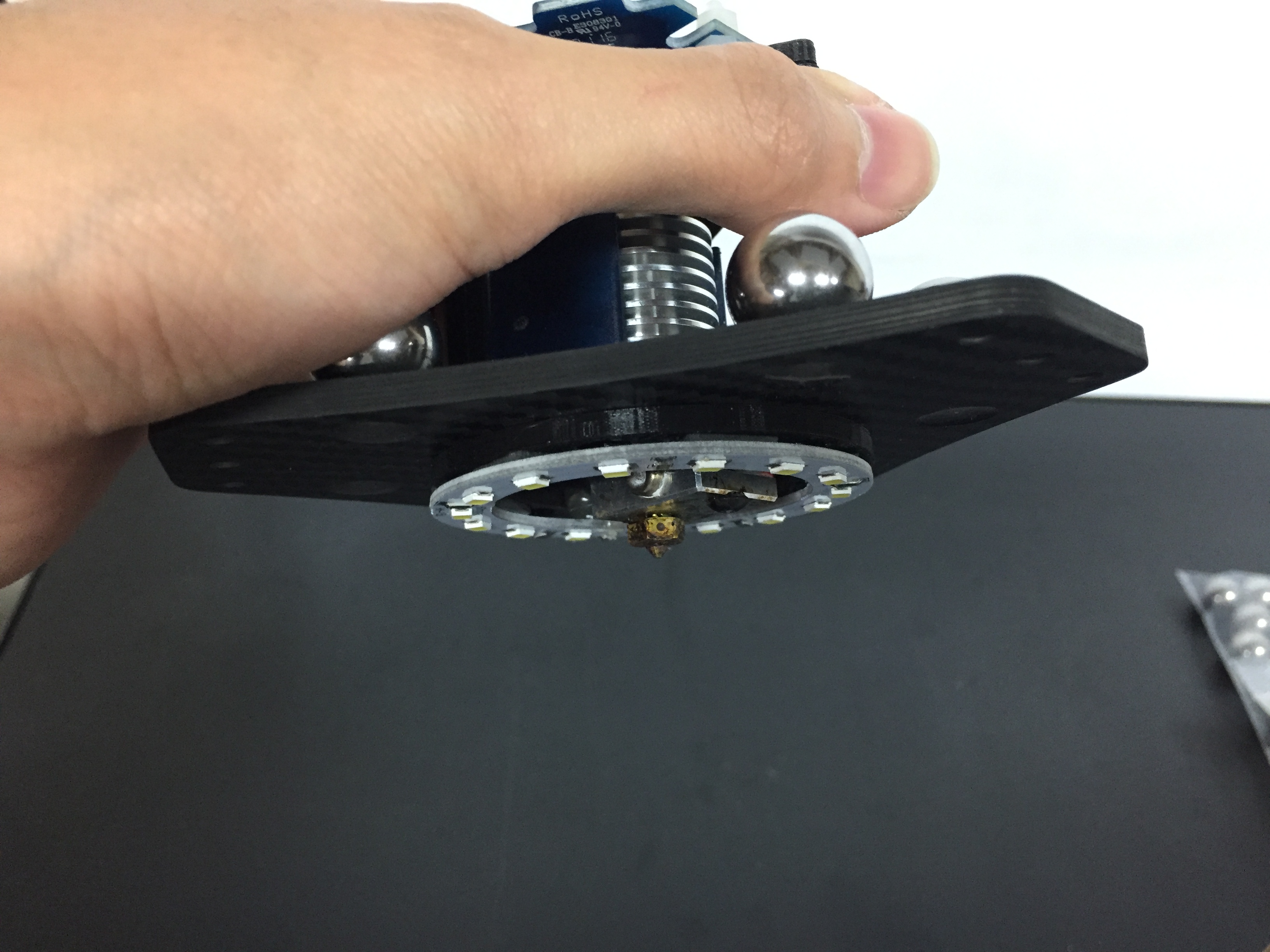

Is there a recommended led ring light that works well with the HE280 hot end assembly?
Re: powering a light ring off the HE280
briankb, I have the tricklaser one. It's a perfect fit for the Max
							V2 max with the HE280 hotend
As mentioned in my thingiverse thing, http://www.thingiverse.com/thing:1845789  I used this one: https://www.amazon.com/gp/product/B00BG ... UTF8&psc=1
It's cheap, the perfect size and works great. It provides a nice general illumination, but not a spotlight effect. It's just a medium brightness.
- briankb
- Posts: 105
I actually have that exact light ring that I'm using on the Orion and the spare is somewhere in my collection of stuff. Thanks for making and sharing those retaining clips for the HE280 mount!Noircogi wrote:As mentioned in my thingiverse thing, http://www.thingiverse.com/thing:1845789 I used this one: https://www.amazon.com/gp/product/B00BG ... UTF8&psc=1

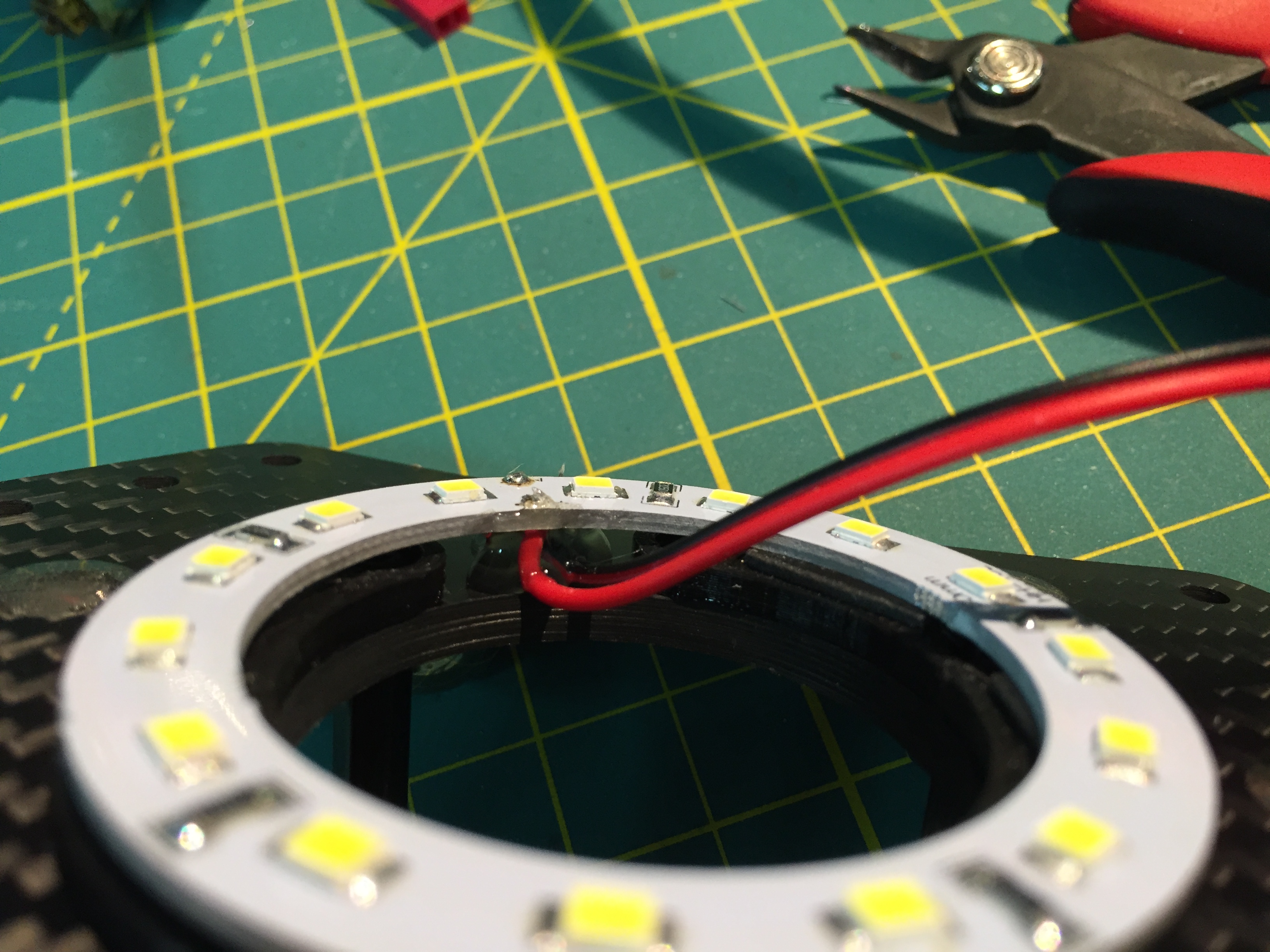

I used these:
and installed it on the effector with a little double sided tape. It works great and I don't really have to worry about the light level. It does flicker sometimes as the hot end is heating up. What if you just add a potentiometer in line to the LED?
