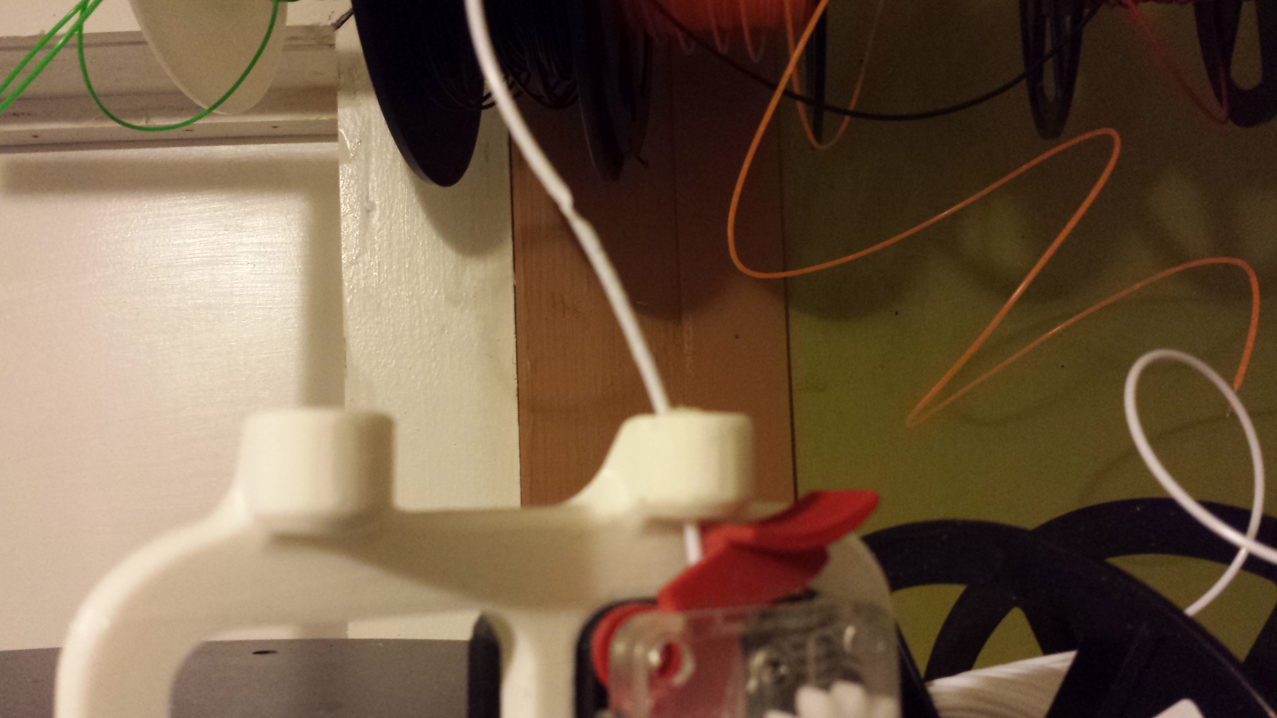

I been printing fine until yesterday I notice it wasn't printing well. I print about 60 hours or more into it and was working great. I clean Nozzle tip, Use thin wire to clean inside of it and check the wire . Seem like it having issue melting the abs filament. Is there some troubleshoot I can use or it is just the hotend need replacement. I try different filament but still does the same.

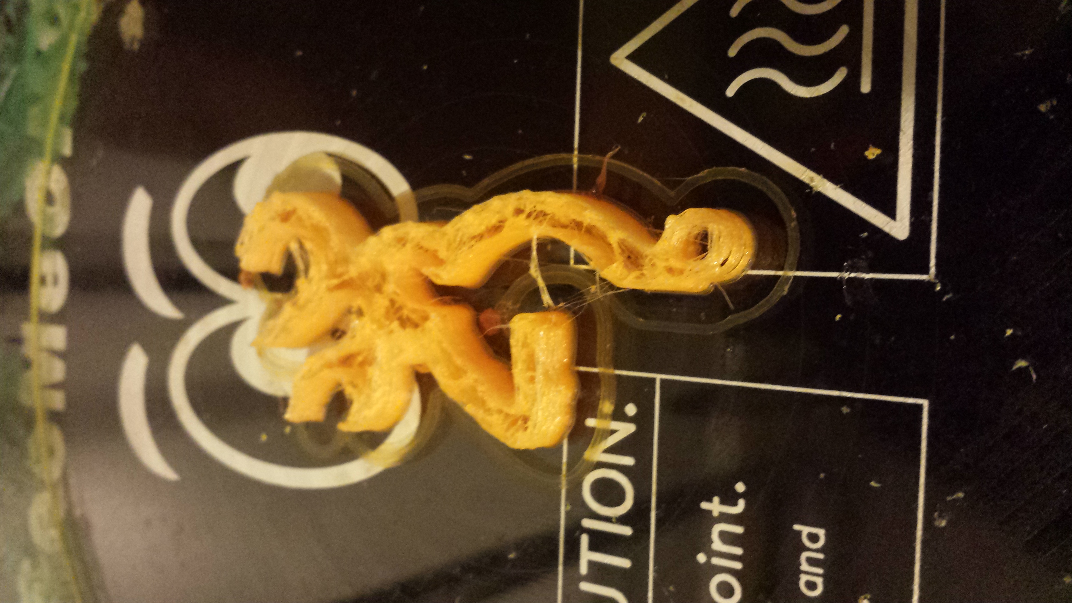

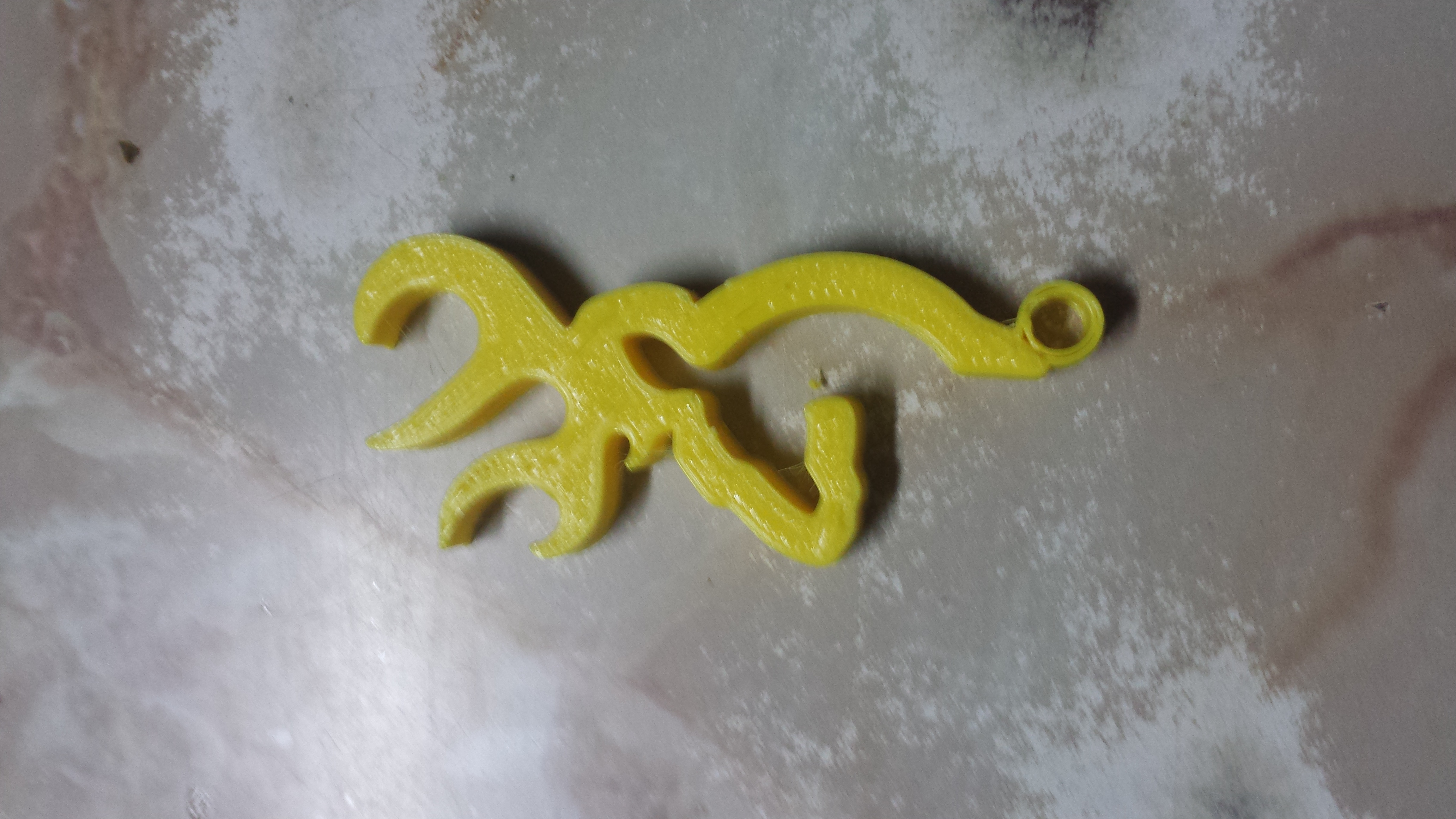

This is what I been printing and other things. This is what happening. I try different filaments.

I could be wrong but there's no such thing as a j-head v6
There are j head hot ends, and an e3d v6 but I think what you have is a cheap Chinese clone.
I would lower your retraction, it might be jamming. I'd start with 1mm and then work up till you get rid of most of the stringing.

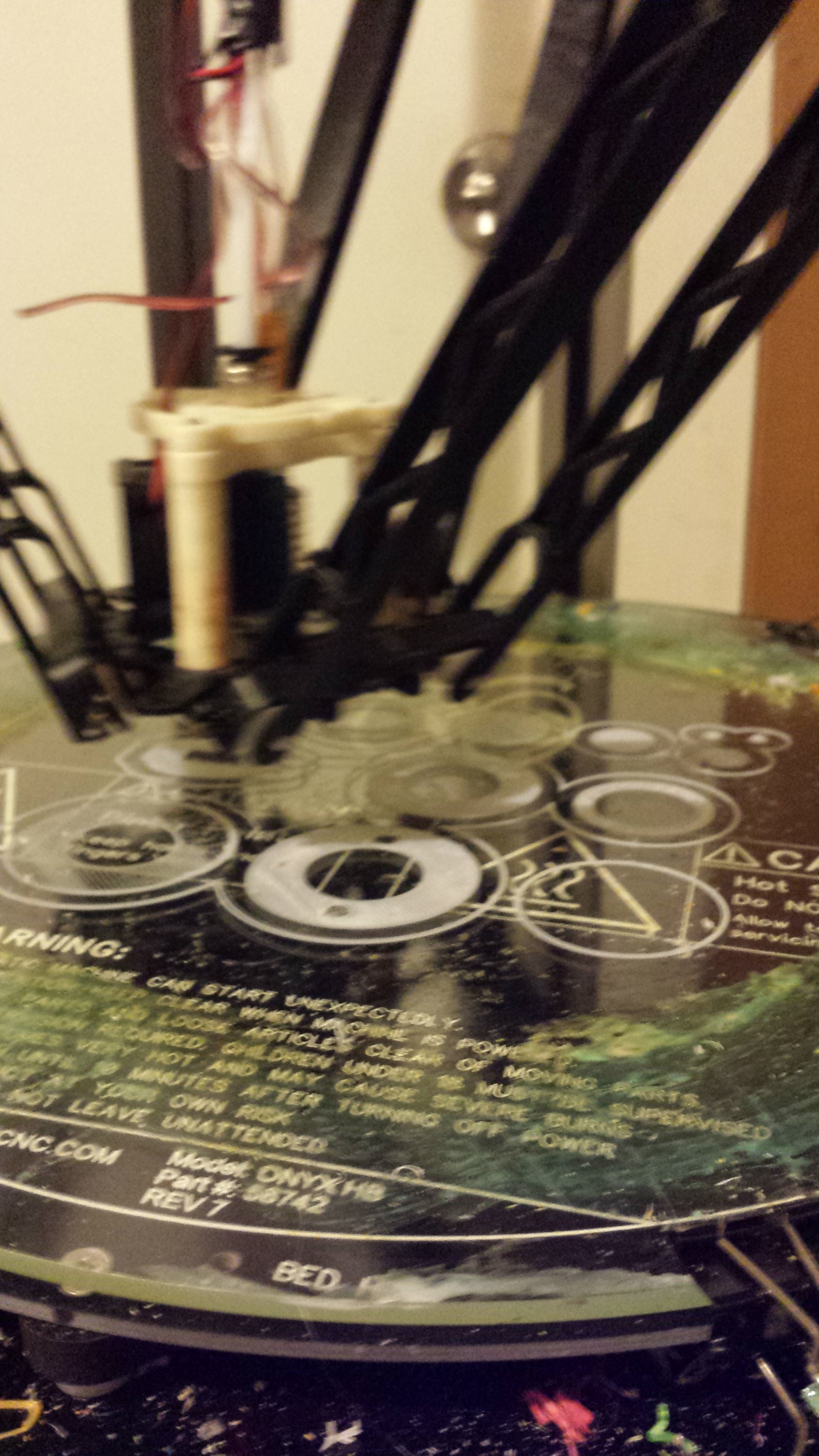

I try method I found online using Nylon Didn't work I disassemble it and put it jar and added actone for day. It clean inside. I put it back still have issues melting the filament. I remove hotend and install new one hotend. Look like it still have having issue melting the filament. Can it be wire or there not enough power feeding to the hotend.
Re: Issues with J-head V6 Hotend
This is with other hotend. It only printed the layer you see and than it stop. I try it with different models stl but does the same. It one of those bad days for me.
