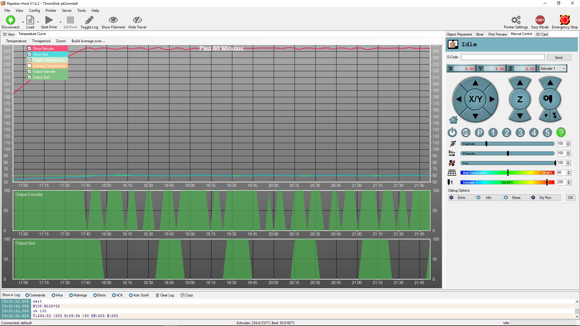

Well, I changed the Heat Manager for both the bed and nozzle to 0. Also described as Bang Bang method in the following link.
https://github.com/repetier/Repetier-Fi ... re-control
The nozzle actually reaches temp now, just cycles above and below with the average being a bit below. I guess it is time to look at PID settings...
The first graph is 255c/60c, the 2nd 260c/60c.

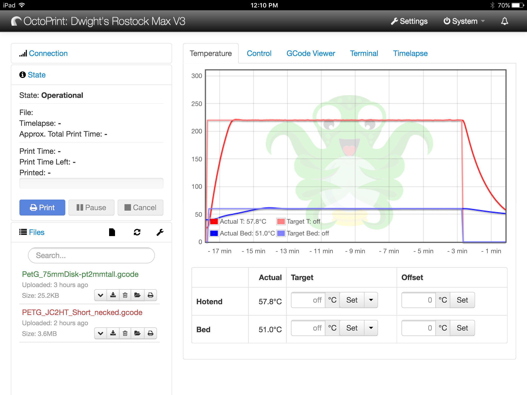

Re: Temp Variance
For reference:
Re: Temp Variance
What stumps me, is why am I having this issue? I have never printed ABS, but it looks like ABS and PLA have lower extrusion temps, but I have to believe that other people are printing PETG on the Rostock Max v3? What could be different about my setup, newer firmware setting than earlier v3's? I can't think of anything else based on the symptoms I can't imagine it being a hardware issue.

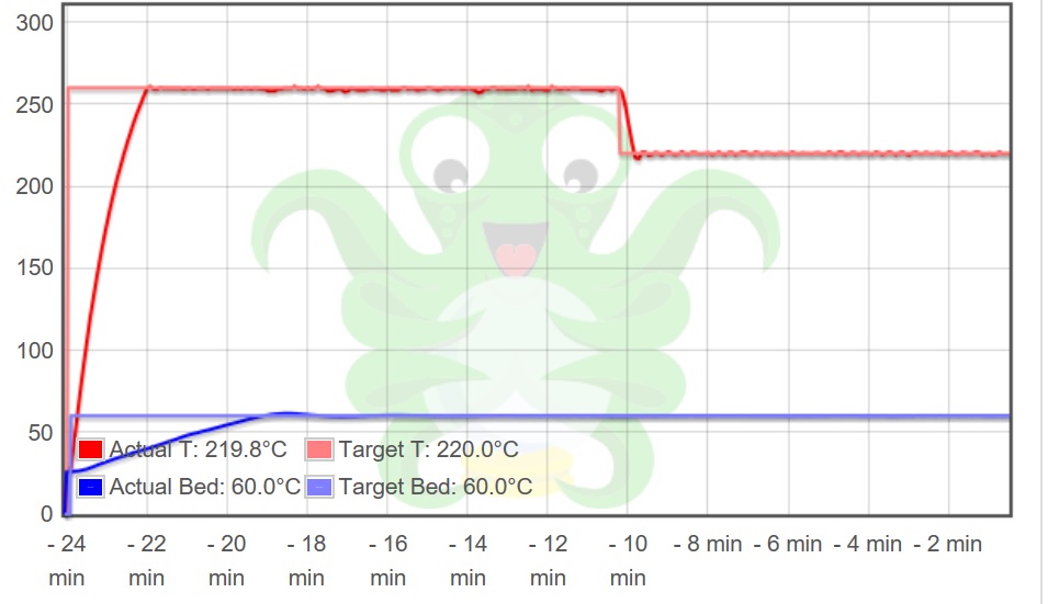

So, the last thing left to do is adjust the PID settings. I discovered autotune, ran that and updated my configuration.h to reflect the changes. (I say this with confidence....meanwhile I was standing over the power button to shut everything off if the temp when too high during autotune or during the maiden run of the new values). The bed issue didn't rear it's head up for the last couple of hours, I haven't decided whether to tune it or not.
Now that the temp is holding within 1.5 degrees now, in the morning I get to do some more test prints with PETG....the same way I thought I was going to do today
M303 S260 ; Autotune default Extruder with a target of 260c
20:03:02.831 : Kp: 38.71
20:03:02.831 : Ki: 10.32
20:03:02.831 : Kd: 36.30
configuration.h previous/changes
//#define EXT0_PID_PGAIN_OR_DEAD_TIME 14.50
#define EXT0_PID_PGAIN_OR_DEAD_TIME 38.71
//#define EXT0_PID_I 0.73
#define EXT0_PID_I 10.32
//#define EXT0_PID_D 53.41
#define EXT0_PID_D 36.3
Set temp 260c/60c

Re: Temp Variance
Did a quick test this morning to make sure that 220c was still stable with the new PID parameters. Seems OK to me, not as good as the original @ 220.
First bit @ 260c, final 10 min @ 220c
New PID Graph Original PID Graph at 220c Original PID graph at 260c edit: compared the original @220 vs now. It was definitely better with the other PID parameters @ 220c. I have asked SeeMeCNC if there are any options to change the PID parameters on the fly like in some other firmware.
