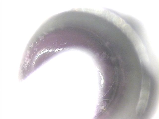

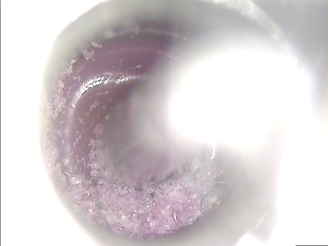

I started taking apart the hot end in stages...
1) Removed the Nozzle. I noted that there was a solid core of white throughout the nozzle, but just a hint of purple just inside the heat break fitting that is screwed into the heat sink. (See image below)
2) Removed the Hot End PTC Adapter (70604) that holds the PCBA to the Heat Sink. It is very clean with no melt, whatsoever.
3) Inspecting the bore inside the Heat Sink, I found that there was a very large amount of what looked like crystallized purple melt at the bottom.
A couple thoughts:
1) I have passed white filament through this hot end and printed ONLY white while still experiencing the same binding at the extruder. So, I have reason to believe the purple, where it is, is staying solid and not melting...
2) I feel as though I shouldn't see melt at this diameter. This leads me to believe that I might have backed the Bowden Tube out of the hot end too far and it allowed the melt to rise up, which then prevents the Bowden Tube from being seated all the way down again where it should be.

i should have been more specific. i first heated a thin wire and broke through, then used a small flathead to kind of scrape the edges to the center from the top, then ran the cleaner through to push the rest through. took 5 or more times till i was happy. and update... my print came out good after running the full 13 or so hours

You can also use a new/sharp 2mm drill bit. If you don't have one I recommend finding an extra long one. Use a pin vise/handle to turn the bit NOT an electric drill. Then heat up to 200°C and ream the hotend from top to push the bad stuff out the bottom.

I am here to report success! I ran into the issue again when I removed the Bowden tube to calibrate my extruder. I noted that I couldn't reinsert the bowden tube as far as it should be (since I now have the insertion depth marked with laptop tape on the Bowden tube). Sure enough, after 5 or 10 hours of printing after I noted the poor insertion, I started observing pitting and holes in my prints.
I've worked out a very straightforward method.
Tools required:
15mm open ended wrench
1/4" socket wrench
1.5mm (1/16") punch
Steps:
1) heat the hot end to whatever temp you need to in order to back the filament out and then remove the Bowden tube.
2) remove the nozzle using the 15mm open ended wrench and the 1/4" socket wrench.
3) remove two of the towers' arms from the head assembly leaving one attached to avoid laying the head assembly on the print bed.
4) heat the hot end to 150C and apply pressure to the filament visible in the bottom of the heat break with the punch until it breaks free. Use only hand pressure. 5) remove the last tower's arms from the head assembly and flip the head assembly over until the plug falls out the top. You may need to remove the cap that clamps the board to the heat break if the plug is too large. 6) reassemble, ensuring the Bowden tube is inserted to the proper depth (fully down the bore) and continue printing happily!
