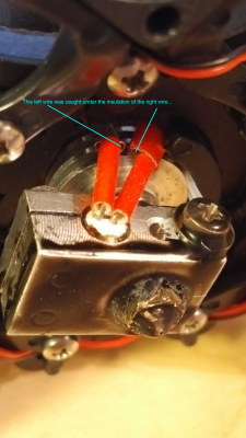

I had a very similar issue here. I figured out the cause, but thought it might be worth posting in case anyone else is having similar issues.
So my F3 fuse (according to this picture) kept popping. It started after a fail print mess. I tried to raise the temp of the nozzle to something like 200, to melt the now-solidified PLA, and immediately lost power to everything aside from the PSU. I checked with a multi-meter, found F3 to be the bad fuse, and replaced it (after waiting on shipping). The unit turned on again, and worked up until I tried to raise the nozzle temperature, which popped the new fuse.
At this point, I had a pretty good indication that the hot end was the source problem, but none of my connector wiring looked suspect (at least, nor more than usual). Still, I disconnected the platform, cut the filament, and pulled the top cover off. Wiring there looked fine, too, but as I examined the heating element, I found this.
The picture was taken after I had separated the wires a bit. Far as I can tell, when previously trying to wrench the nozzle off, I must have twisted the whole hot-end enough to pinch and move these wires. Once they were separated (and a new fuse added, boy am I glad I ordered several), and the printer heats up properly. Now if only I can figure out how to remove a PLA jam from inside the hot end.

I suggest heating it up to at least printing temperatures, removing the nozzle (If it went back on or hasn't come off yet), then removing the heatbreak+heater block from the heatsink. Then warm it up again, and take the back end of a drill bit and push downwards. If there's more in the hotend beyond the heat break, push the filament down through the heatsink with these parts removed. If it won't move on it's own, push the bowden tube through as well.zxaber wrote:I had a very similar issue here. I figured out the cause, but thought it might be worth posting in case anyone else is having similar issues.
