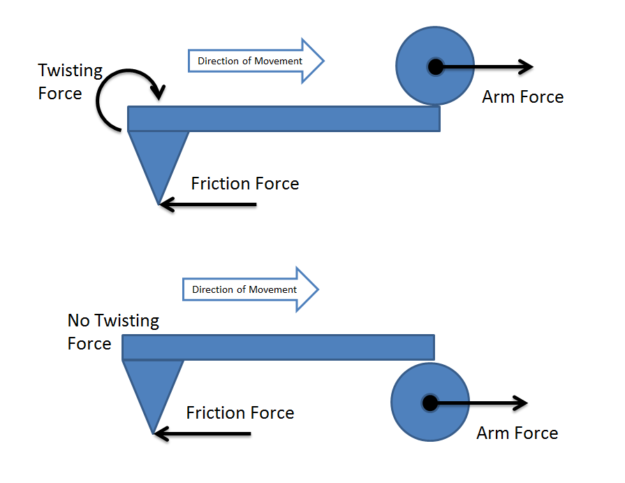

Interesting idea. Firstly, there won't be any twisting under normal printing conditions, there is really no force on the joints and the springs are designed to eliminate backlash (a great feature of these ball & cup joints).
But probing is a different beast! The nozzle hits pretty hard and I've seen the effector twist significantly. Perhaps there is an imperceptible twist that is harder to see. Slowing down the probe speed in increments (to make sure it actually triggers) might shed some light. The slower speed would hit with less force and maybe less twist.

mhackney wrote:Interesting idea. Firstly, there won't be any twisting under normal printing conditions, there is really no force on the joints and the springs are designed to eliminate backlash (a great feature of these ball & cup joints).
I admit I'm a software engineer and its a long...long time since I took any structural analysis courses but here's my possibly flawed thoughts on the issue with lateral movement and the placement of the ball joints.

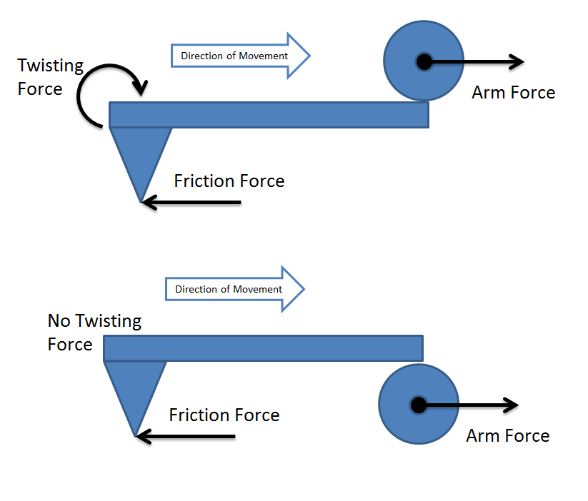

The arms are either pulling or pushing the effector plate around when its moving laterally across a print. Now the arms are at an angle most (maybe all of the time) so there is a downward force as well as a lateral force but I'm going to ignore that with the hope it cancels out with the build plat pushin back on it.

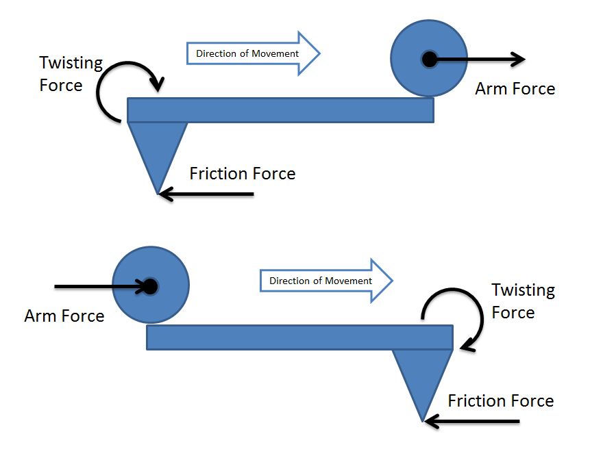

So in the arms pulling the effector scenario there is now a new twisting force on the effector that wasn't there when the balls were below the plate:
Also in the pulling the plate the effector scenario there is now a new twisting force on the effector that wasn't there when the balls were below the plate:
Then when you combine the push and pull into the same lateral movement the new twisting is additive:
Now this is definitely not to scale and the twisting may be small.... Also, given the hot end tip hangs down relatively further than in the pictures above, there is probably a twisting force in old set up but now its a little bigger.
Nice drawings. The analysis looks correct. However, many folks are getting very good results with the current configuration even if it isn't optimal. Myself included now - and I'd like to figure out what really changed!

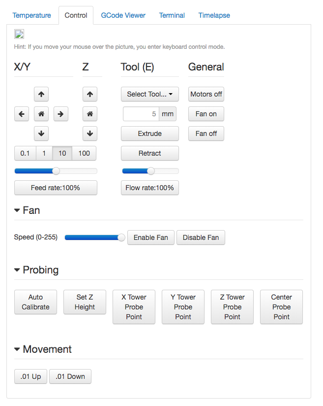

OctoPrint and Raspberry Pi update
I've been using OctoPrint for a solid 2 weeks now. Finally mounted my RPi in the top powered from the RAMBo (thanks JJ for the parts). I've added some plugins and custom controls to fit my work flow. So, after a good couple of weeks I can make the following observations:
Printing untethered from USB over Wifi is fantastic. Very close to the Duet web interface experience.
The RaspberrPi USB connection is a lot less problematic since it is dedicated to the printer. No stutters, lockups, unexpected pauses. The RAMBo can do its thing without a hitch.
Installation was really simple and a great upgrade if you haven't done it. I enabled support for Cura so if I want to do a quick slice and print I can. I also added the Custom Control Editor and EEPROM Repetier Editor plugins. The EEPROM editor lets you view and change EEPROM settings from the web interface. The Custom Control Editor lets you add custom controls.
Here is the YAML to duplicate this (or you can use the Custom Editor to add your own). You also have to put the v3probing.gcode file in ~/.octoprint/scripts/gcode/custom/ on your raspberrypi.

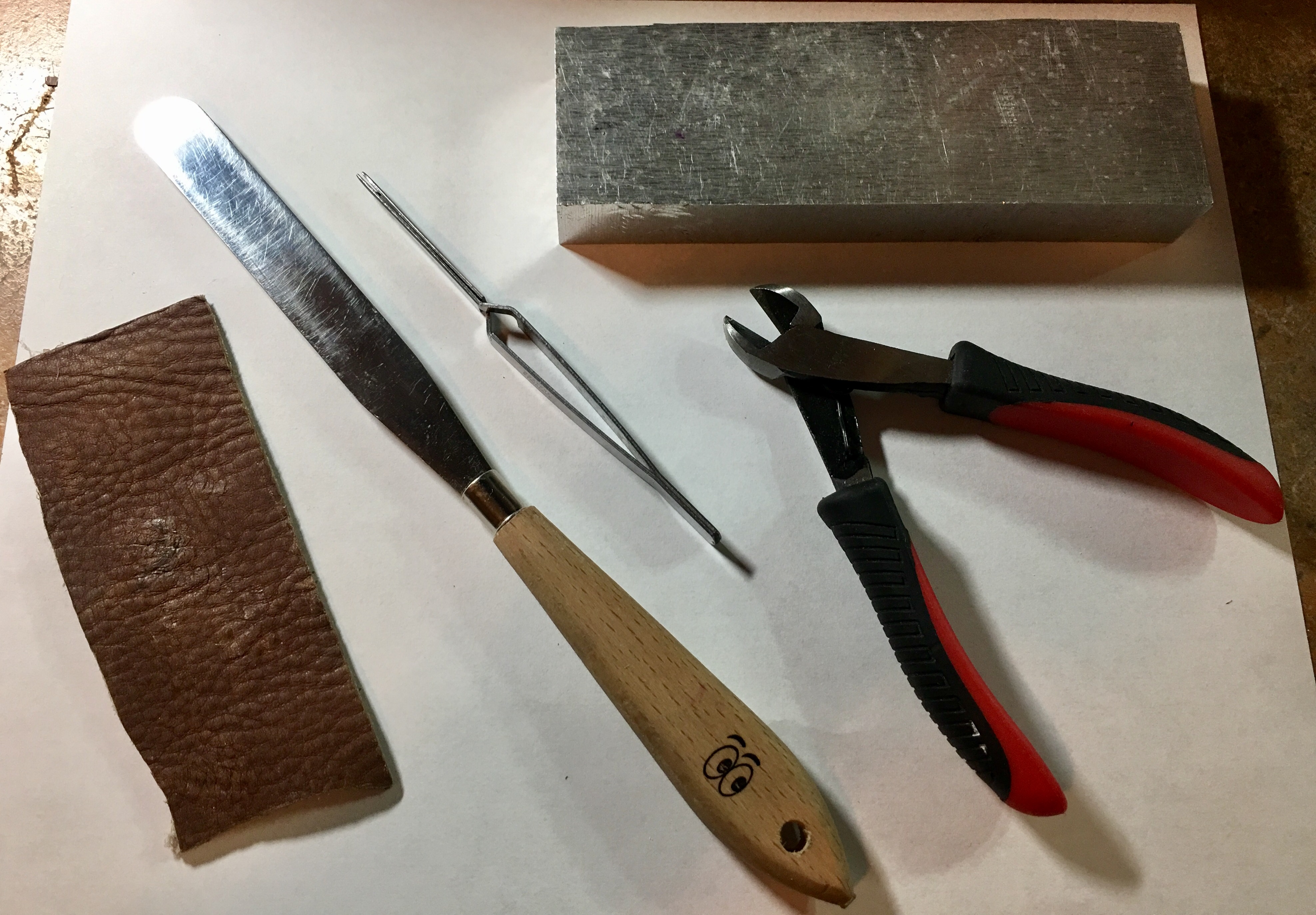

Tools of the Trade...
I thought folks might enjoy a photo and description of the tools I use before, during and after printing. From left to right:
A 2" x 5" piece of leather. I use this before every print to polish the tip of the nozzle. The back side is suede-like and I'll use that to remove blobs of melted filament. Then a couple of quick swipes against the smooth side, and the nozzle is nicely polished. This minimizes filament sticking to it, which minimizes stringing and bad top surface finish. I wrote more about this on my SublimeLayers blog.
A SeeMeCNC spatula (I have 5 of them so one is almost always near by) to remove parts and clean the bed surface. I've modified mine, I bevel one side of the rounded edge so it can easily insert under the base of a print. The spatula is about .7mm thick, so what is that going to do to a print with .2mm layers? Exactly, smash it. So bevel one use with 600 grit sandpaper. I ALWAYS bevel the face that the eye logo is on, that way when I pick the spatula up, I just make sure the eyes are looking at me and that insures the bevel is in the correct orientation to do its job! I use the long edge to scrape off stuck filament from my PEI surfaces.
A pair of "normally closed" tweezers. I use these to snip blobs of filament from the nozzle tip. Even as a print starts and the nozzle descends to that magical X=Y=Z=0 spot on the bed, sometimes the flexing of the Bowden will force a little ooze out. So, tweezers at the ready, I simple squeeze them to open, grab the nozzle tip and let them close under their own power. It takes 32 seconds of practice to master this.
A 6" x 2" x 1" aluminum block. Just because! Actually, I use it for a couple of things. Some of my thin fly fishing reel parts come off the bed a little soft. I press them against this block to simultaneously flatten that surface and cool it off. I also use this thing like a happier to tap the back of my spatula for parts that are "aggressively" stuck to my bed. I intend to cut the wooden handle off square so I'm not hitting the point. There are other uses for this block, yes many other uses...
A sharp (quality) pair of wire cutters. I use these to snip filament in preparation for feeding through the extruder.

For those wanting to use the above yaml snippet and will be inserting/overwriting the control section of the Octoprint config.yaml file in the .octoprint folder. I recommend making a backup of the file before playing with it...
+1 always a good idea! YAML is persnickety!

mhackney wrote:...
While I have good wire cutters, I've actually been using cat nail trimmers for that purpose. The enclosed style that shears like a cigar cutter. Gives a very good cut.
Left over from decades of being owned by cats, before I outlived them all.

I am thinking that the Octoprint custom Control screen - Movement section needs a home button/command. Would G28 be appropriate?
Yes, but there is already a home button under the Z buttons. But you could easily add a button to movement with G28.

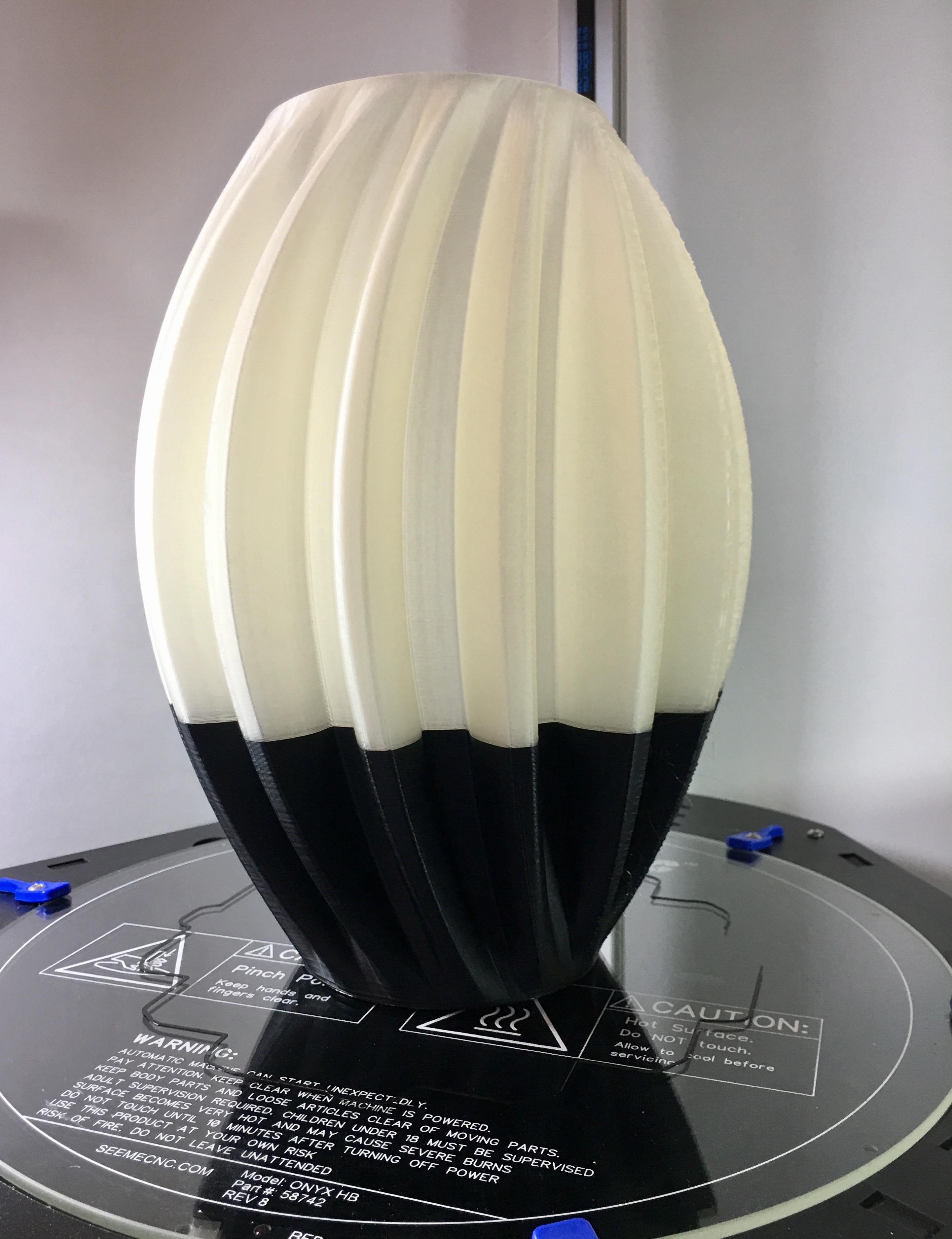

A big print
Stock V3, 0.7mm nozzle, black and natural SeeMeCNC PLA filament. .35mm layers, 2 perimeters, "Vase" setting in KISS. 195°C with 60°C bed on bare glass. 250mm/10" tall. It glows in the light.

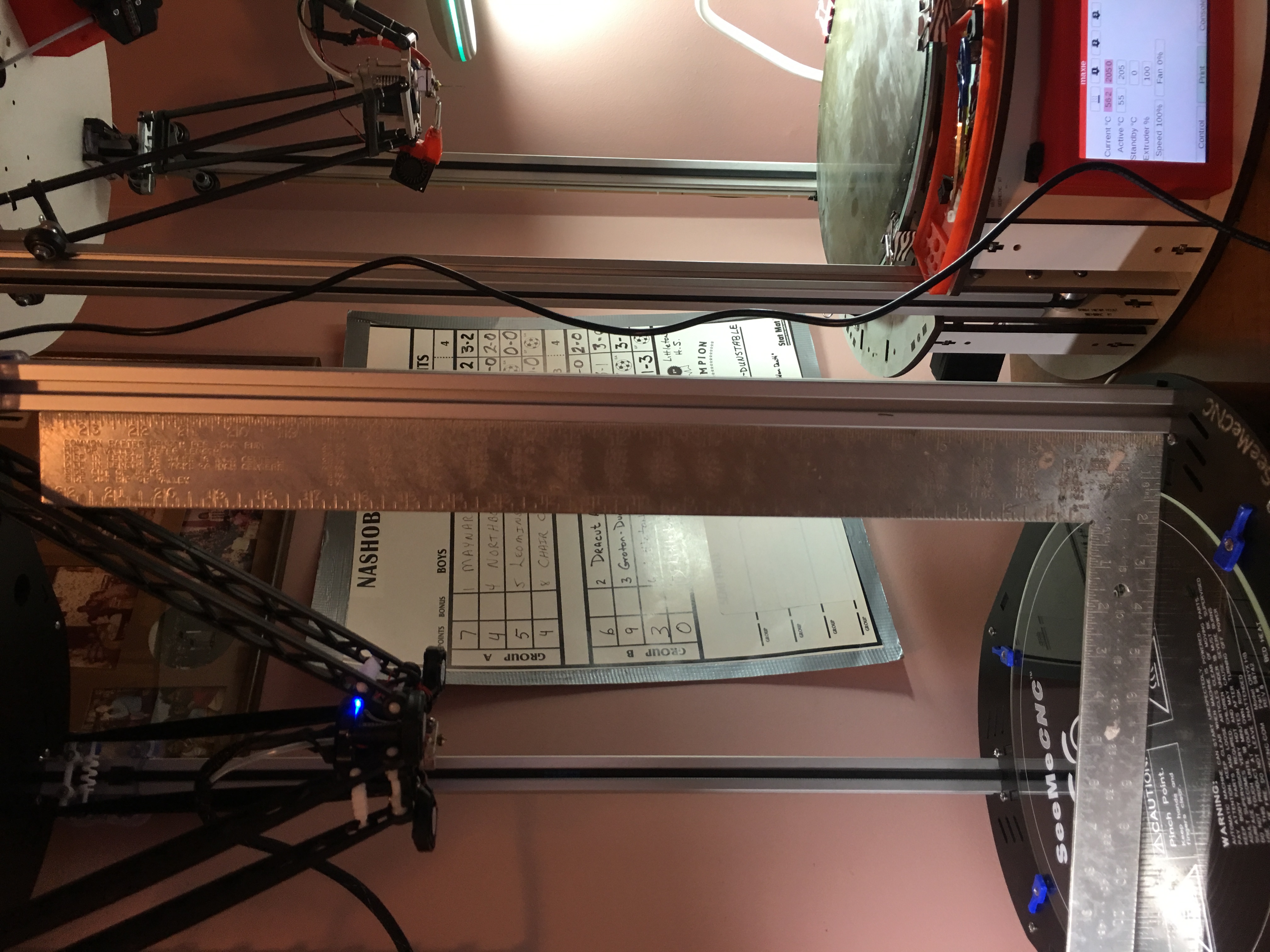

Checking your towers...
Find a 2' builder's square and a 12" precision metal ruler and do this:
First use the ruler to test the flatness of the glass. You can do this cold and hot to eliminate warping at temperature as a culprit.
Next, attach your bed as you normally would and then verify that all 3 towers are perpendicular like this:
[img]http://forum.seemecnc.com/download/file ... &mode=view[/img]
(click on this photo and it will be shown in the correct orientation!)
The short square arm should pass though the center of the build plate as shown. Press the short arm against the glass and then push it up to the tower. It should have no perceptible gap top to bottom. Let us know what you find.
This tests for tower lean but not sideways lean. Once you have the lean adjusted you can carefully measure edge-to-edge of a pair of towers at the top and bottom all the way around. If you are unlucky this might not tell you anything and all 3 towers could be leaning sideways the same amount. That is unlikely so you will probably find a suspect tower or two if that's the case. Fix them if so.
Many people do not verify that their towers are indeed perpendicular and not leaning and just assume all is ok. A 5 minute check will rule this out. You might be surprised how far off it is. It is easy to fix by loosening a few screws, pushing and pulling into alignment and then tightening everything up.
