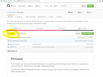

*** proceed with caution here *** This is work in progress. You should keep in mind that you might need to return to the master if this causes your printer to not work. Remember to clear EEPROM if uploading this. AND clear EEPROM before returning to the master or installing a the new master firmware after we commit the final revisions.
This is only tested on a handful of RMAX's and Eris (Erii ?) TODAY at SeeMeCNC. But why not share the bleeding edge. ;)
The development (dev) branch on github updated tonight regarding probing: USE ONLY G29 to calibrate the printer. G29 does it all !! You don't execute anything else. Please post some feedback while we continue to further improve the firmware. After years of wanting a dedicated embedded programmer in-house, I brought on Ryan Rittenhouse, who's very good at what he does.
highlight on seemecnc github
