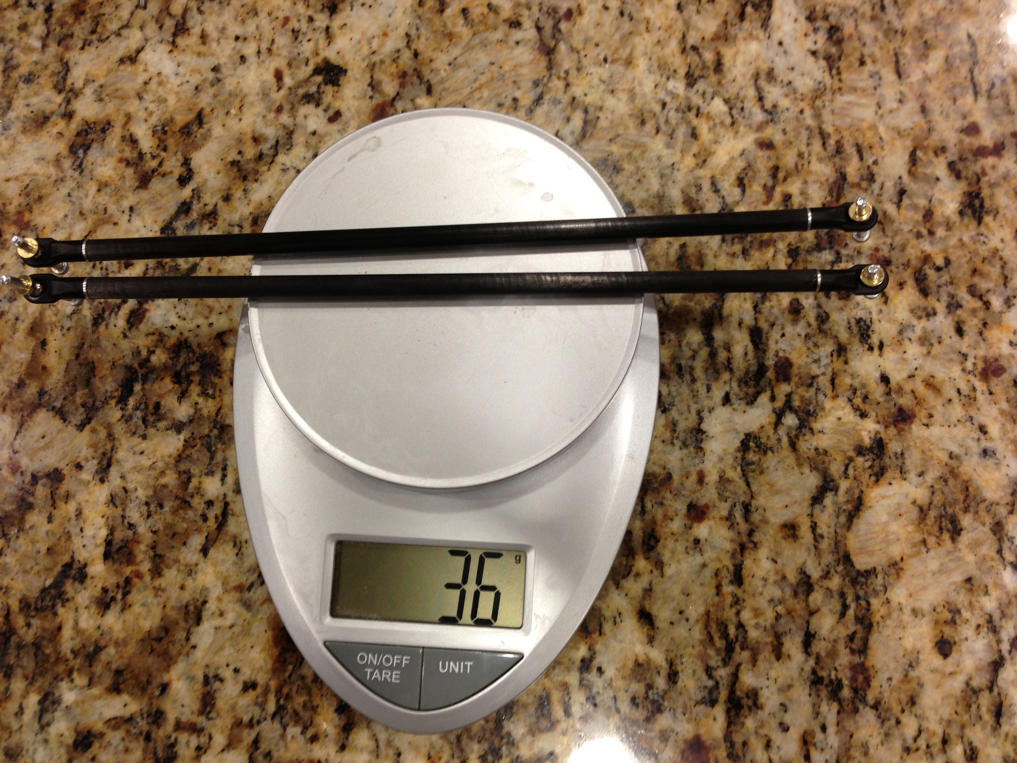

Trick Laser Delta Arms
Posted: Tue Apr 23, 2013 6:34 pm
by aerouta
So, I just received my trick laser delta arms. I am hoping these arms will improve the quality of my prints, or at the very least help me nail down some trouble shooting issues. I ordered these just before the weekend. Brian at Trick Laser ended up shipping these over night after some production delays to ensure I received them in a timely manner. The arms arrived nicely packed and in good condition. Here are some additional pictures of the arms.
The arms seem to be well made, all the arms but one have no noticeable play and rotate very smoothly. There is only one joint that has very very little play. In the picture below one is not like the other....
One of the screw falls under it's own weight. This is the joint with slightly additional play. I do not think it will cause an issue. The amount of play in less than my stock delta arms.

Not that it matters too much but these new assemble will be lighter also.
It looks like these arms are the same length. The quick double check seems ok.

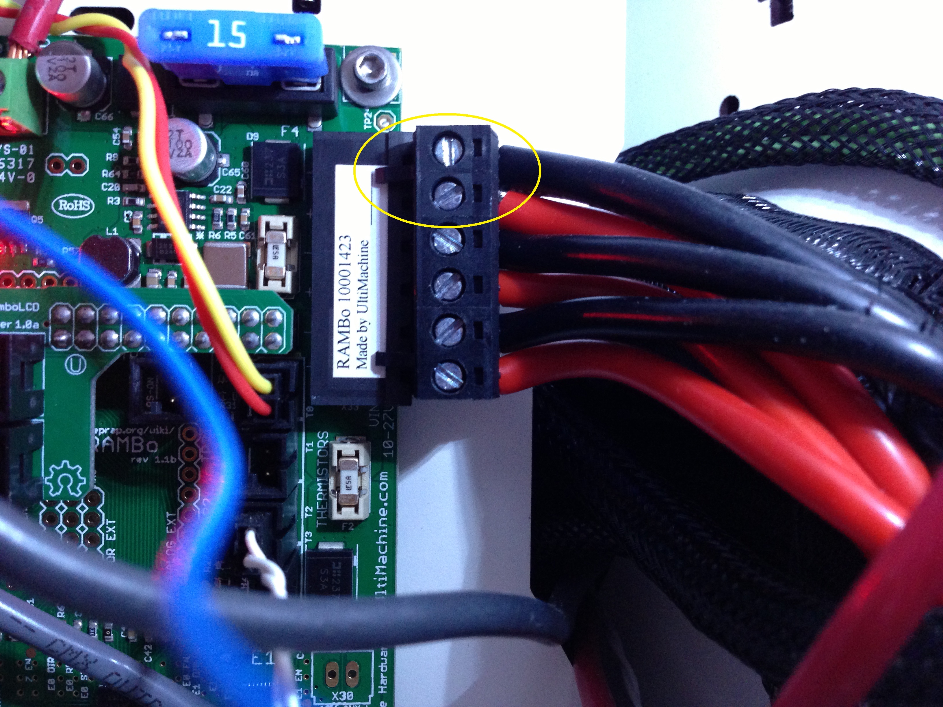

So I started using fans which greatly improved the ability to print overhangs with ABS. However, the inclusions of fans introduced heating issues. My heat bed, even with an upgraded 12v power supply, had issue heating above 85c and maintaining temp with fans. I would like to try to heat the bed up to ~100c on some prints so I picked up on of these.
Will it be acceptable to hook up the 24v leads directly to the heatbed power inputs on rambo?
Re: First 3D Printer Build
Posted: Wed May 08, 2013 10:58 pm
by cambo3d
rambo is only has a 15amp fuse, the onyx will surge 18amps of current, on initial power up with a 24v power supply. most likely you will blow the 15amp fuse.
how much current does your power supply output?
You might get away with upgrading to a 20amp. Because the 18 amp surge is only for a few seconds. As the temperature of the onyx increases the current drops till you reach your set temperature.
http://forum.seemecnc.com/viewtopic.php ... =170#p7960
Posted: Wed May 08, 2013 11:26 pm
by aerouta
cambo3d wrote:rambo is only has a 15amp fuse, the onyx will surge 18amps of current, on initial power up with a 24v power supply. most likely you will blow the 15amp fuse.
it is a 15amp power supply.
http://www.amazon.com/gp/product/B006QS ... UTF8&psc=1
Posted: Wed May 08, 2013 11:46 pm
by cambo3d
in that case, you can dial down the voltage on your power supply so the onyx doesn't try to draw to much current from your power supply. That will help some.
Posted: Thu May 09, 2013 7:38 pm
by aerouta
How would I turn down the voltage?
Posted: Thu May 09, 2013 8:23 pm
by foshon
aerouta wrote:How would I turn down the voltage?
In the red circle.
[img]http://farm8.staticflickr.com/7439/8723827417_bcf9b2a07d_n.jpg[/img]
