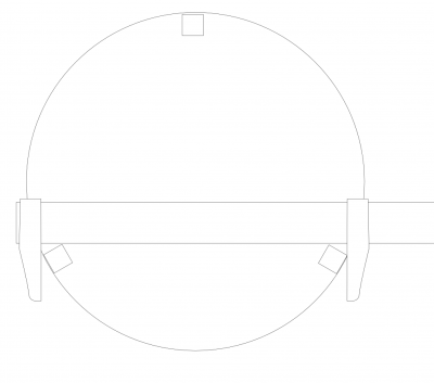

I measured the distance between each pair of towers both at the top and at the bottom. I picked the tower that was furthest away from the others as my reference. Then I squared that tower to the base. (It had been square once. But I've picked the printer up, transported it in the car, and generally manhandled it enough that it had gone out of square.)
Measuring distance between towers
Once that one was square, I locked it down and installed the triangular alignment jigs. One triangle went at the bottom and rested on the Onyx. The other triangle went at the top. It rested on some clothespin clamps, and the top assembly rested on it. The alignment jigs had to support the weight of the towers and the top piece, so I made sure they were clamped tightly enough.
Then I loosened the screws holding the other two towers (being careful that the alignment jigs prevented them moving vertically), and carefully adjusted the nuts on the threaded rod until all six triangle sides were exactly the same length, as measured using the above technique. Well, almost exactly. There is still 0.2 mm difference between the longest and shortest. Of course, re-tightening the screws changed the alignment, so there was a lot of trial and error.
Then I updated the dimensions in the firmware, installed the dial indicator and started testing. My dial indicator is not metric, so readings are in inches instead of mm. If I remember correctly, the first reading put the corners about 0.004" (0.1 mm) lower than the center. So after all this effort, I went back to tweaking PRINTER_RADIUS to find the value that works best. The best result was 0.675 mm less than the calculated value. With that done, I got the gauge to read the same number to within 0.0004 at all three corners and the center.

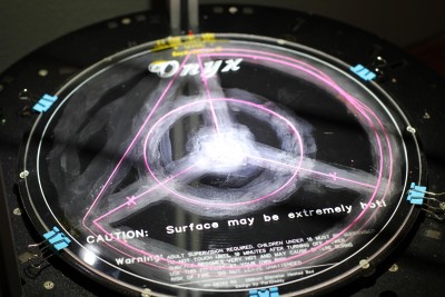

Next, I printed the Rostock Onyx Bed Leveling Aid. It took a few tries to get a good glue layer on the board, but I eventually got a good print of it. The glass plate seems to be a little low halfway between the Y and Z posts (at 2 o'clock: you can see where the skirt came unstuck). I don't know how a glass plate can sag, nor how to compensate for it. Maybe it means I haven't finished calibrating. Or maybe the bed is cooler on that side. I don't know.
Can you ever really have too much glue stick?

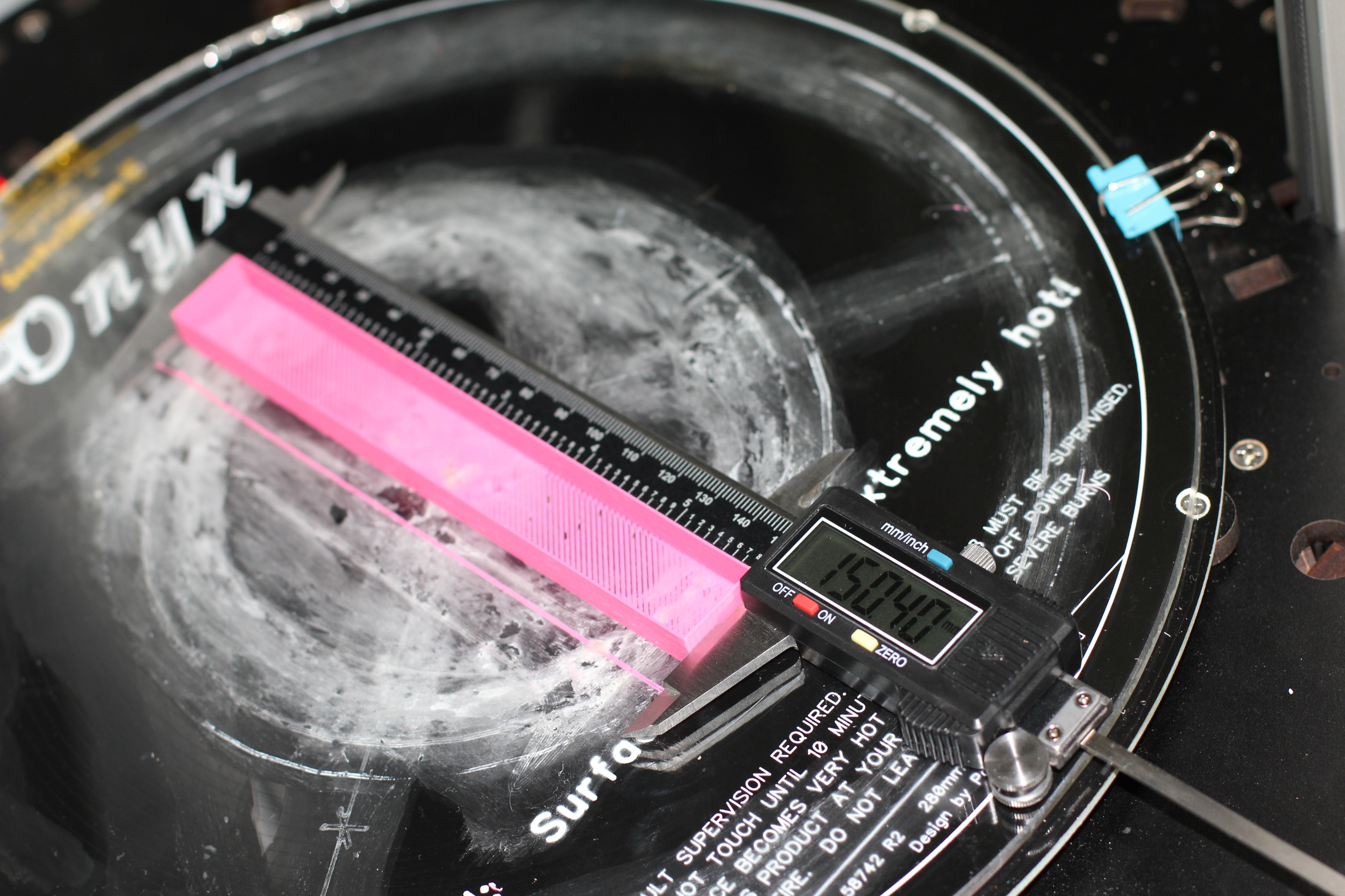

Then I printed another calibration cube -- er, brick. This one was 20 by 150 mm. After the bed cooled, it measured just slightly oversize, 0.3%. (After I peeled it off the bed, it was too flimsy to measure.)
This caliper is neither substantial, alloy, nor from Birmingham.
So I'm happy. You can see that the printer is still not perfect, but it is a lot better than it was, and I bet it's better than the average working Rostock MAX.

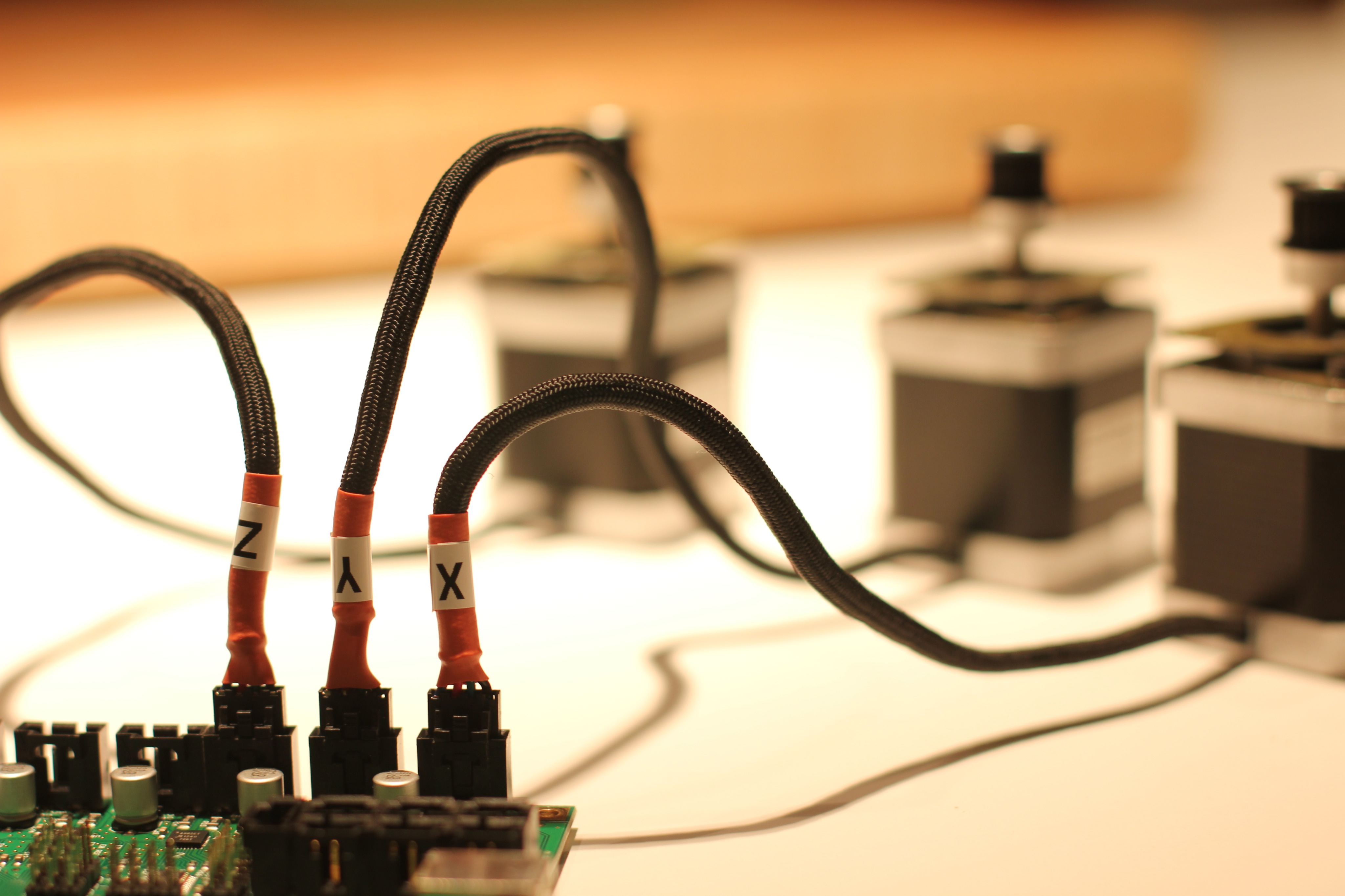

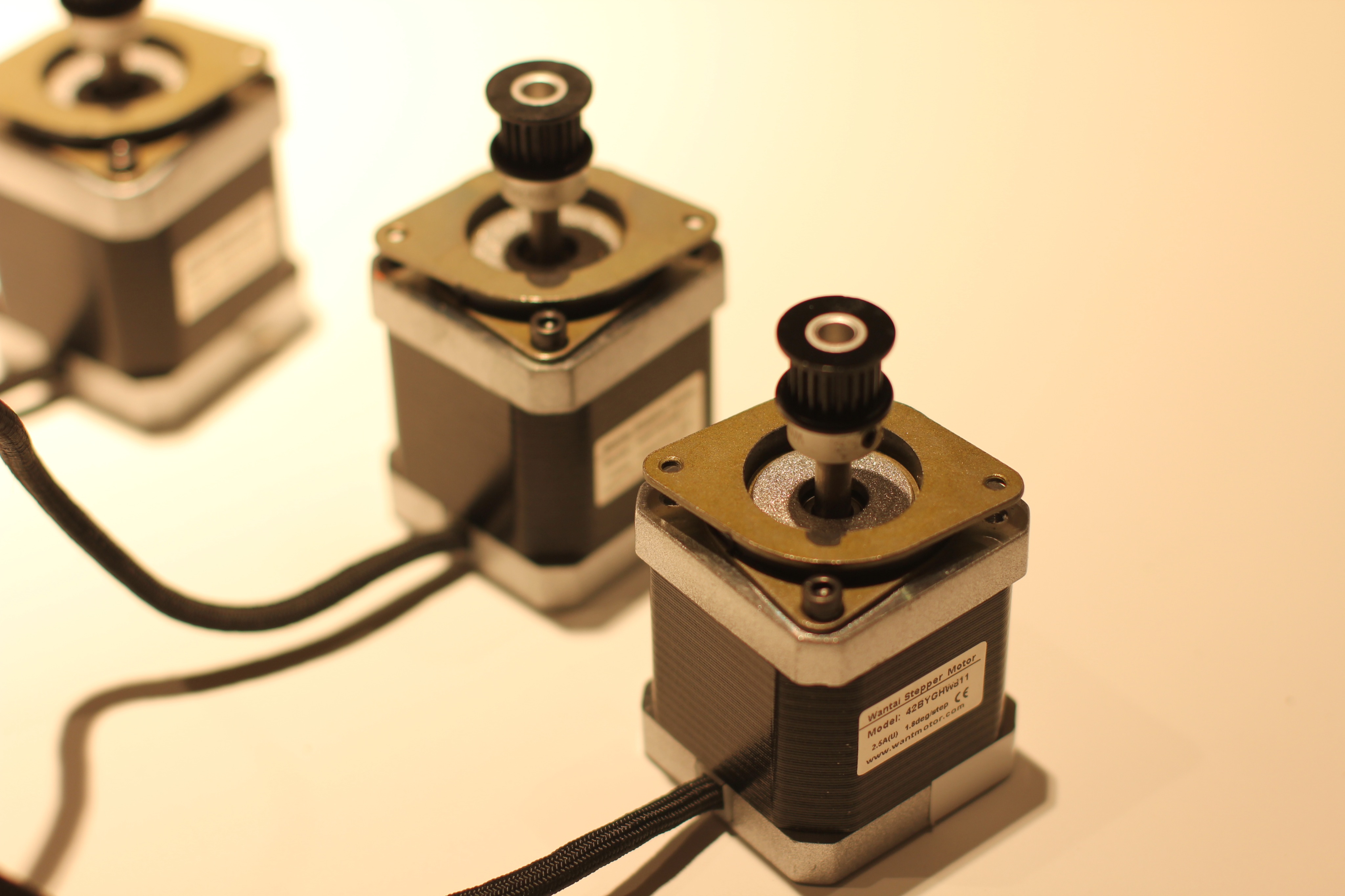

The day before my replacement RAMBo board came in, the motor dampers from astroboy907's group buy came in.
So I installed them. They work great. I'm not sure how much quieter they really are, since the printer was down for three weeks, but they _seem_ quieter.
While I had the motors out, I decided to dress the wires. I used the old paracord sheath trick. That, along with some heat shrink tubing and label tape, made decent looking motor wires. In my ever-so-humble opinion. (-:
1 use for a dead RAMBo.
I need to do something with the limit switch wires, too. And then, if I'm going to high-mount my extruder, I'll want to redo the wiring to the extruder and hot end too. In other words, I want to redo all the wiring. (-:

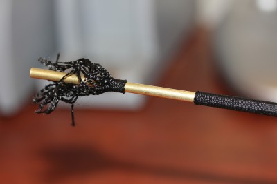

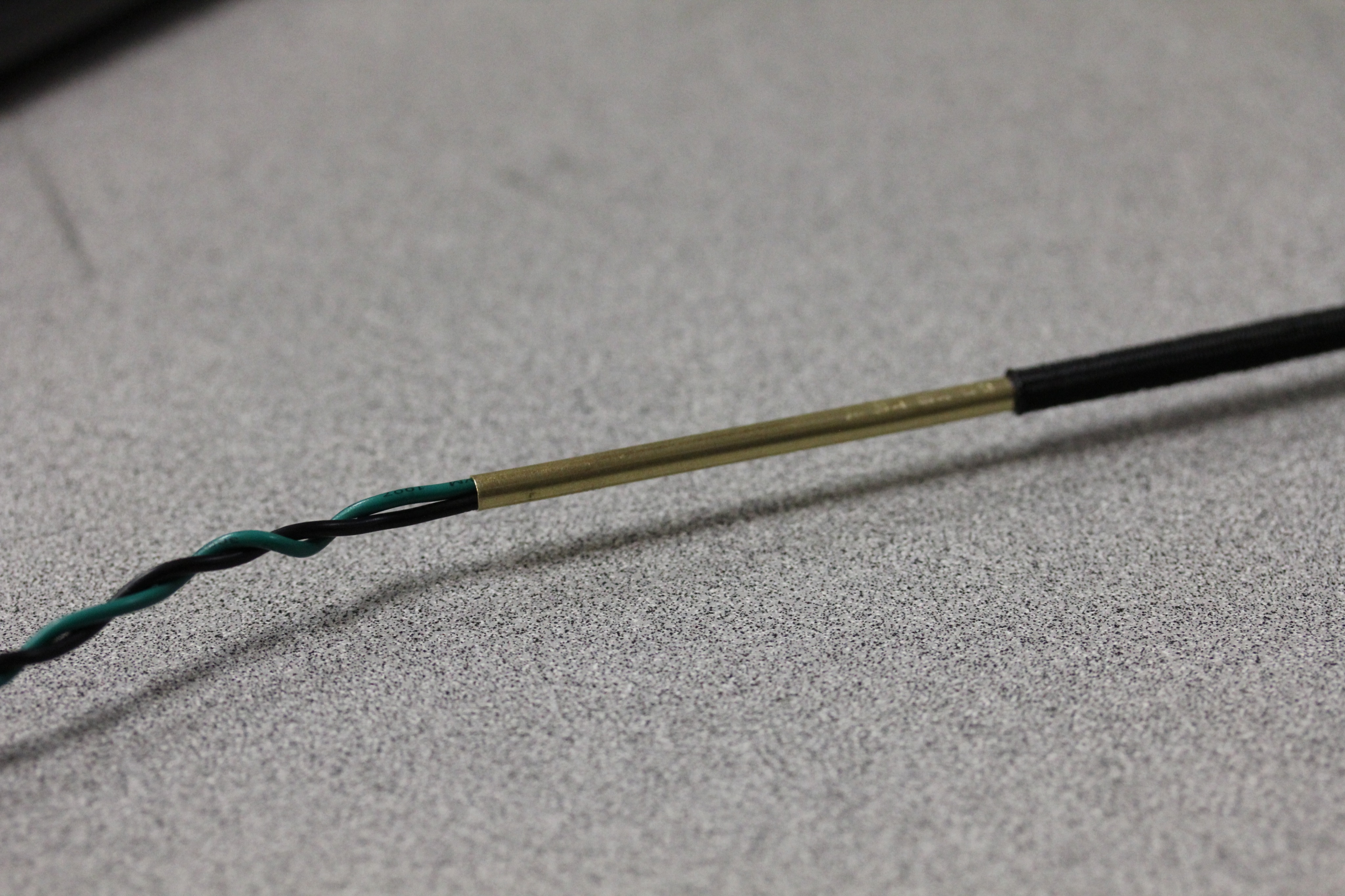

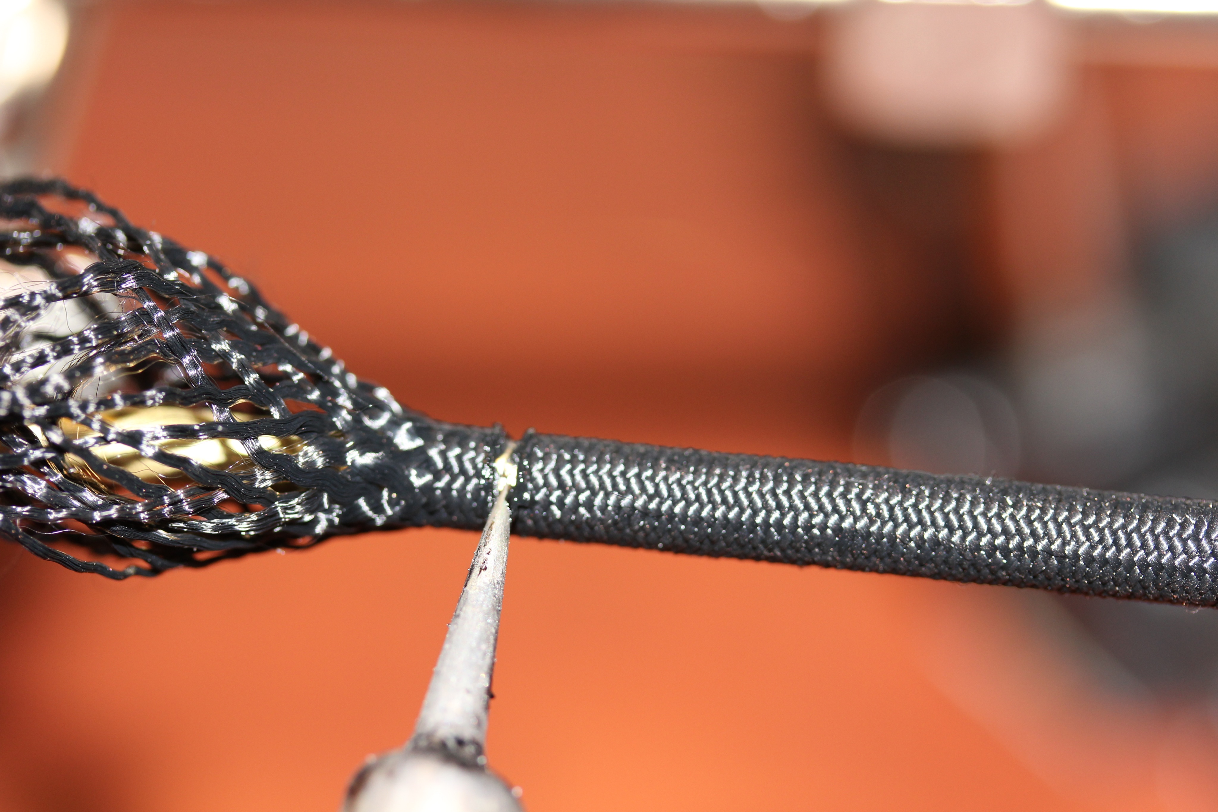

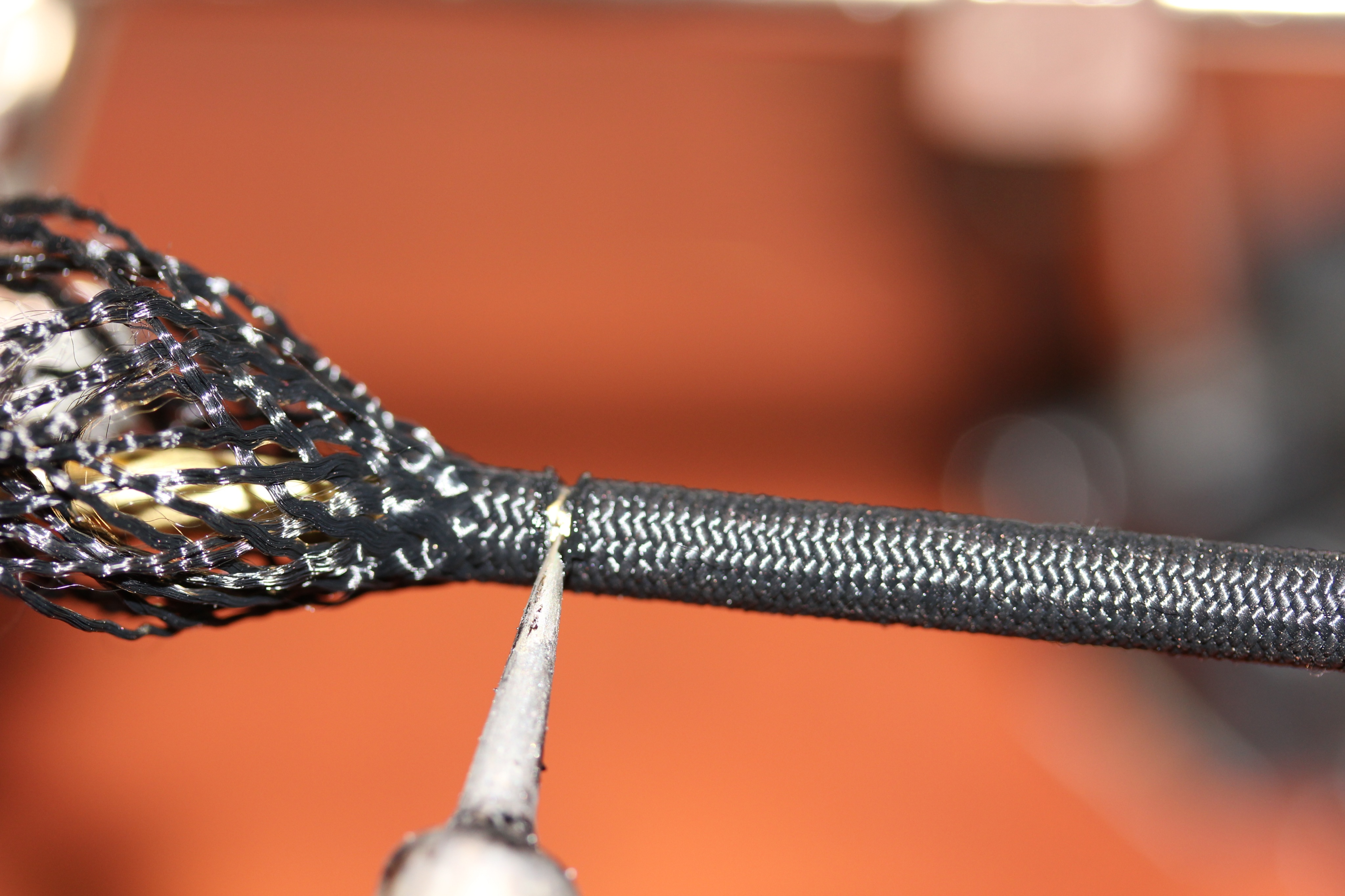

I learned the paracord trick from Bart Dring, who runs buildlog.net. But I can't find a description, nor even any pictures, on that site now.
Parachute cord has a nylon sheath around a bundle of longitudinal fibers (also nylon, I think). You don't need the mil-spec stuff; wire dressing is not life critical. It comes in lots of colors, so you can color code your wiring, but I just used black. Many sporting goods stores sell it. I got mine on Amazon.
Cut a piece of cord about an inch longer than you need. Pull out the inner fibers and discard. Slide the sheath onto a metal tube. (This is the hard part; see below.) Using a soldering iron you don't like very much, melt-cut a ring around each end of the cord. This leaves a fused nylon end that is round, not flattened. Pull off the frayed ends and discard.
I hate you, solder tip!  I coat you with gummy nylon!
Next, stuff the ends of the wires into the tube and slide the sheath off the tube and onto the wires. Slide on a piece of heat shrink tubing.
Note: these wires are too big for paracord.
Attach the connectors to the ends of the wires. Slide the sheath into place, then the heat shrink. Heat it and shrink the shrinkable, being careful not to melt the nylon. El voila!

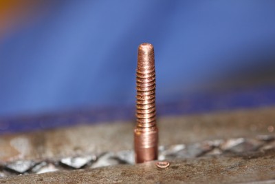

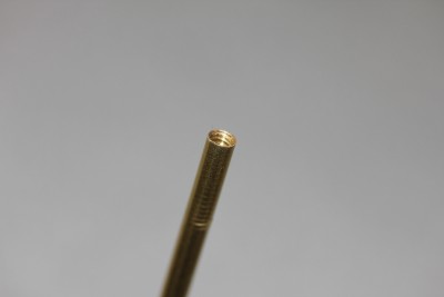

How do you get the sheath onto a metal tube? I'll tell you how I do it, but I'm sure there's a better way waiting to be discovered.
I got a length of 5/32" OD brass tubing from the hobby shop. First I burnished and rounded the end so that it would slide in a little easier. That sort of worked, but wasn't great -- the tube edges would still catch the nylon fibers and snag.

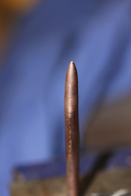

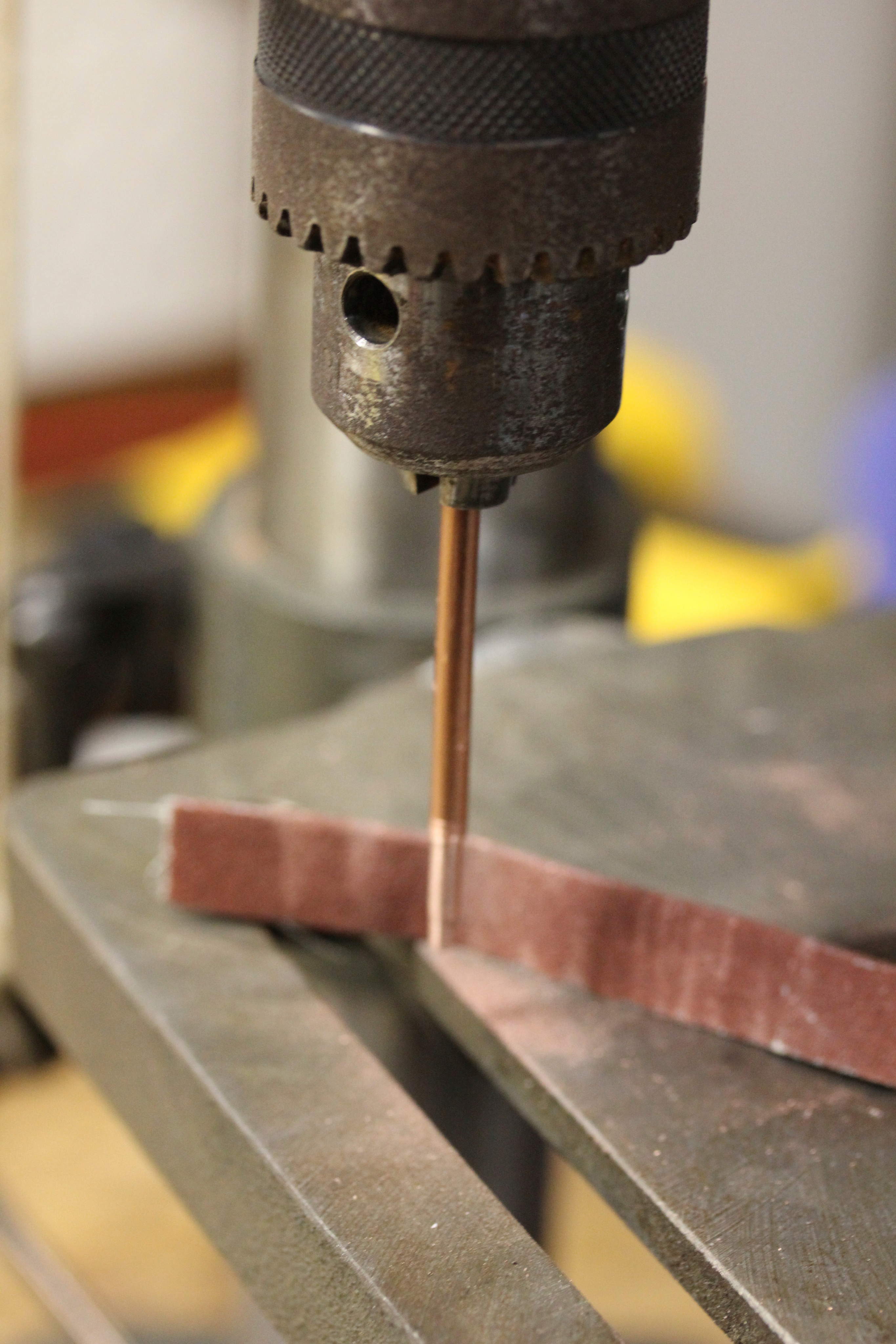

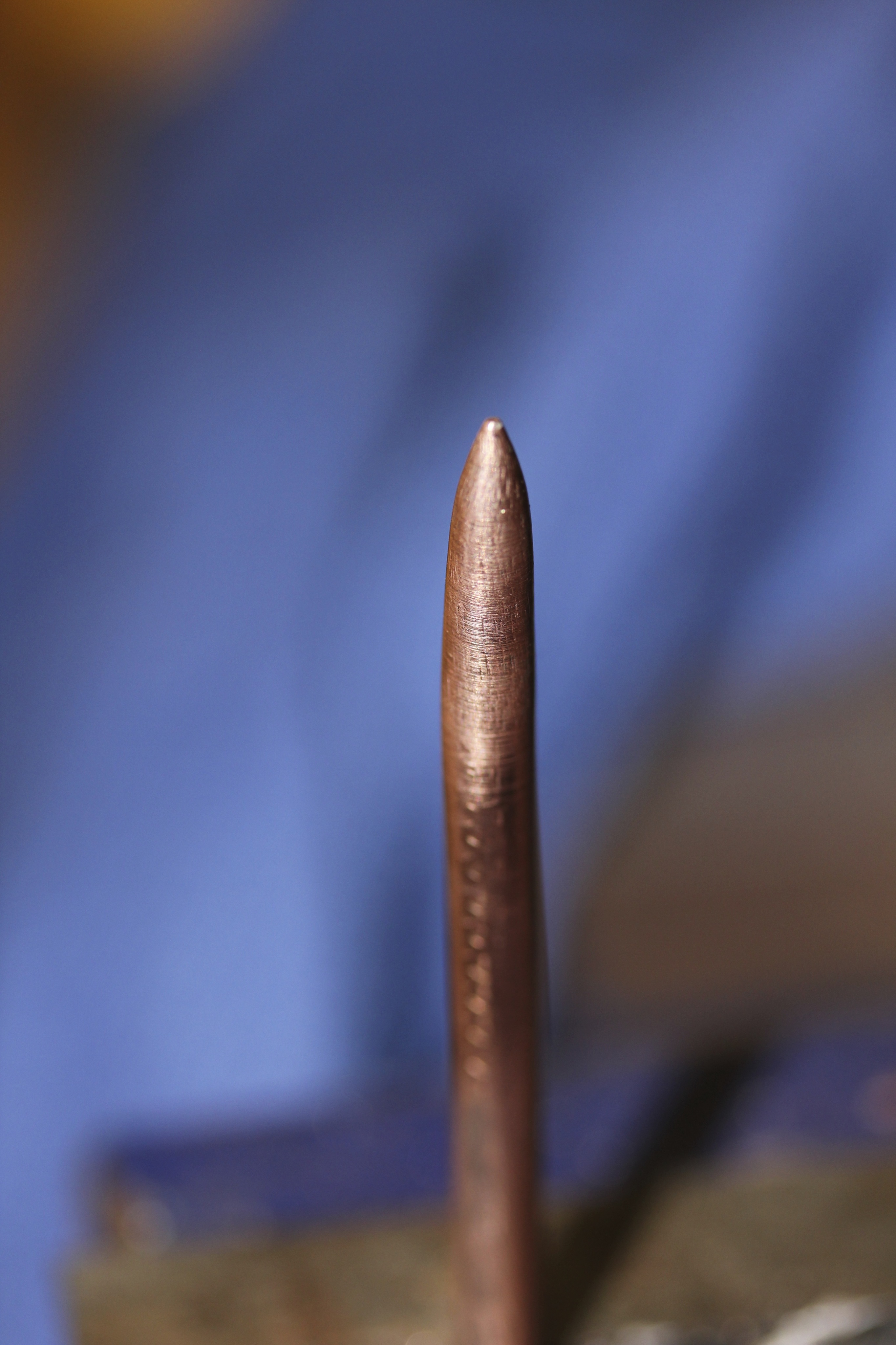

So I made a needle end. I got some 6awg wire at Lowe's. They sell it, uninsulated, by the foot, and I only needed 6 inches or so. 6awg is just slightly bigger than the 5/32" tubing. This is the wire that grounds your house's fuse box (if your house is wired to US electrical code).
I put the wire in a drill press and used a piece of sandpaper to make a blunt point on one end. On the other end, I turned it down (still using sandpaper on a drill press), then gave it threads using a handheld die.
The pointy bit.
The pointy bit.
Is this the vertical mill?  Why is the cutting tool made of paper?
If they think you're technical, go crude.
I tapped matching threads on the inside of the tube. Now I can screw the two pieces together and use the needle point to thread the paracord sheath onto the tube, then unscrew the needle, insert wires, and slide the sheath off. The threads inside the tube grab the wire insulation and hold it in place.
Someone with actual metalworking skill or even with actual metalworking tools could make a much better version of this tool.
