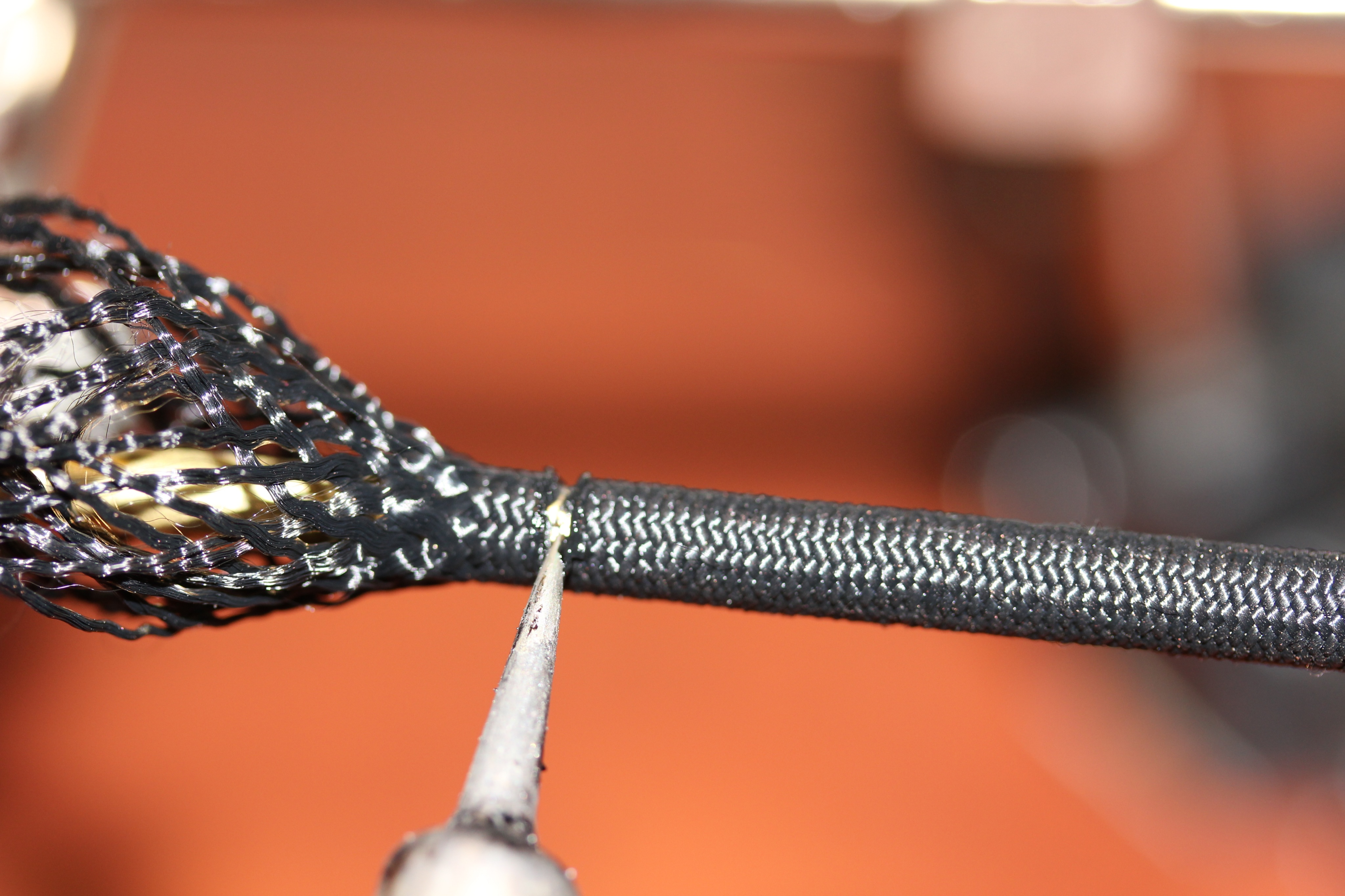

I learned the paracord trick from Bart Dring, who runs buildlog.net. But I can't find a description, nor even any pictures, on that site now.
Parachute cord has a nylon sheath around a bundle of longitudinal fibers (also nylon, I think). You don't need the mil-spec stuff; wire dressing is not life critical. It comes in lots of colors, so you can color code your wiring, but I just used black. Many sporting goods stores sell it. I got mine on Amazon.
Cut a piece of cord about an inch longer than you need. Pull out the inner fibers and discard. Slide the sheath onto a metal tube. (This is the hard part; see below.) Using a soldering iron you don't like very much, melt-cut a ring around each end of the cord. This leaves a fused nylon end that is round, not flattened. Pull off the frayed ends and discard.
I hate you, solder tip!  I coat you with gummy nylon!
Next, stuff the ends of the wires into the tube and slide the sheath off the tube and onto the wires. Slide on a piece of heat shrink tubing.
Note: these wires are too big for paracord.
Attach the connectors to the ends of the wires. Slide the sheath into place, then the heat shrink. Heat it and shrink the shrinkable, being careful not to melt the nylon. El voila!

Thanks, guys. I am familiar with "store bought" cable sleeving products. But paracord has a completely different texture from the cable sleeve I've used. It is much softer and more flexible, and it frays less (even before you melt the ends). I assume it's because paracord is made from thinner fibers.
It is also limited in that it only comes in one size.
