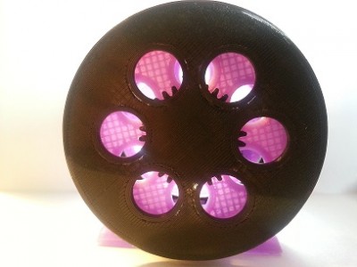

I haven't quite gotten to printing one of your reels, just too many things on my plate. I have a cool idea color/materials wise though...

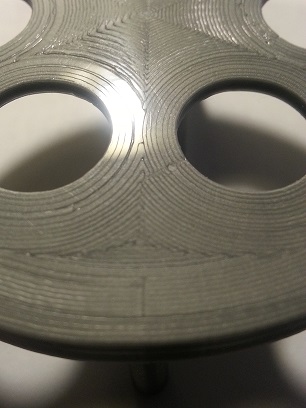

It came out a little thin between the holes with S3d. Still needs more tweaking but it's fun to play with.
This one was just an experiment with the Concentric infill settings. Meh, looks better from a distance.
