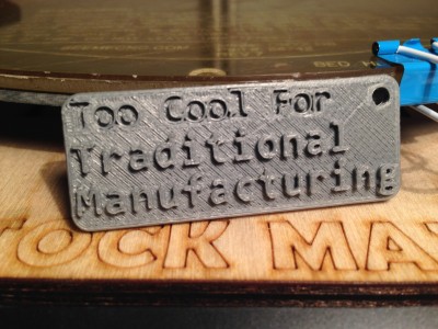

Well, apparently I was right, and wrong. That 118 degree drill bit (or was it 138...) is quite terrible at making a good smooth transition. I even bumped the temp by 15 degrees above what I print at regularly. I made a thing, but it was under extruding and not extruding at all in a few places. Looks like the next one (already in progress) will need a few changes. Bridging was much better though (sharper point on the nozzle gives better bridging ability too)
Appropriate Message for a traditional manufacturing class
This file has pretty much everything a good torture test has. Everything except a nice big swooping overhang...

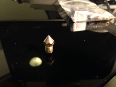

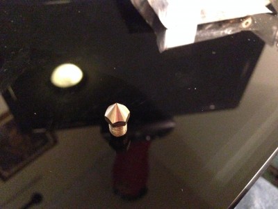

We got a 2mm drill bit ground to 80 degrees and I think it will work well. I made a new nozzle today that came out nice. I broke the .36mm bit in one of the nozzles (these lathes don't move fast enough...) so I used the one just larger (I think it's a #78) that is just above .4mm. I think I have one that will work well, but I need the wrench flats before I try again. I also am going to reuse the original one with the more abrupt transition. I can redo the hole with my new bit and hopefully get nicer results. When all is done I hope to have 4-5 complete nozzles. If they work well and my local maker space ends up getting a lathe I may offer to make a few if some are interested.
Also, I now have a 2mm orfice nozzle :D I was trying to get the broken part of the #79 bit out by taking a small amount of material off the angled part (it exposed a tiny bit of the bit that I could grab onto and remove from the nozzle). I did just that, and I moved my hand to what I thought was the carriage feed wheel to back the tool from the work piece, turned the wheel, and cut off the tip of the nozzle. I accidentally grabbed the cross feed.

I got the wrench flats machined, and with the new 80 degree drill bit I think it will work nicely. Going to do another test print soon.
Nice Wrench Flats
Nice Wrench Flats
New Nozzle
New Nozzle

Your nozzles look good, please let us know how they work with that 80 degree hole.

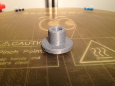

The print I did last night failed (shortly after I turned off my light, I knew that thing makes prints finish properly..) I think i had it way too hot for the Nylon, when I screwed with the nozzle there was a plug made out of some leathery nylon. I was at 280, I think I was compensating a bit too much (first print I had had poor adhesion). I just finished an ABS print and it looks pretty good. Was at 250, might try lowering the temp on some other prints in the future, 250 is a tad high. Looks pretty good though.
First Print!
First Print!
