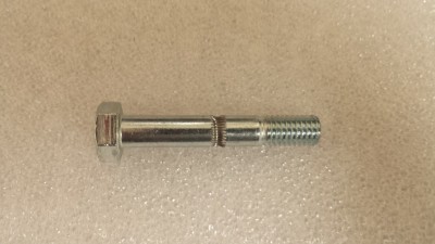

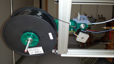

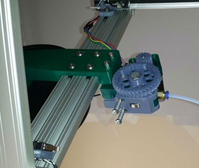

The MAX METAL is now printing it's own parts! I've got about 12 hours print time on it. I'm still using the 1/8 stepping Rambo until it completes the prints for the revised electronics housing for the Smoothieboard.
I was hoping the stock EzStruder had enough guts to feed the Prometheus, but no such luck. I suspected it might be an issue, but wishful thinking did not help. It's okay with certain PLA and ABS filaments, but some PLAs take more extrusion force.
It was going to take the addition of a geared stepper motor or a new geared extruder. I went with an alternate geared extruder design based around a Greg Wades design. I've been using this on my bowden Ordbot + Prometheus for over 400 hours without a single hiccup. I have changed the gearing so it's not as heavily reduced. I get about 430 steps/mm at 1/16 stepping. I machined the hobbed bolt myself, but a "standard" should work.
I also created an alternate spool holder bracket to combine the extruder mount as well. If anyone is interested in the extruder, I will make the files available.
Back side
Back side
Front Side
Front Side
Hobbed Bolt
Hobbed Bolt
